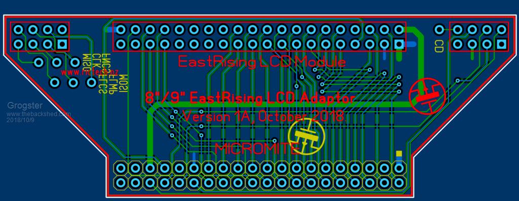

G,
Happy for you to go with the adaptor board - when they arrive, please put me down for two.
Re TE, I have used it as the T_IRQ signal on the E100. It works, but I should test using T_BUSY instead as the IRQ line.
Will try to get to it tomorrow or next day.
panky.

@ Jim - Yep, understood. I will separate them out.
@ panky - thanks. Please post here with your results. I am currently using pin 38 on the ER display, labelled as RTP PEN_VCC and says it is the pen interrupt, which sounds the most like the touch IRQ. What made you use TE as the touch interrupt? 'Tearing effect' had me bamboozled....
@ matherp - Okey dokey, I will.
EDIT: Flash-and-font connector now routes to solder pads instead of anywhere on the MM connector end of things, in order to keep the SPI's separate.Edited by Grogster 2018-10-10

Without going through the EastRising data sheets I doubt that it would be worth supporting the font chip. I understand that it is just a flash memory on a SPI bus. SPI would be too slow so the font would have to be copied from the chip to the Micromite's memory. Which is exactly the same as loading the font via a BASIC program into the Library - so no advantage.
But, as a "free" flash memory chip it might be worth supporting for saving data, something that should be doable in a CFunction.
Put me down for two of them thanks Grogs.
Geoff
Posts: 10042
Posted: 11:01am 09 Oct 2018
OK, chums, here we are:
This has both the SD card and touch SPI buses on their own pins as per the standard pinout for the 5" and 7" LCD's This is still E100 compatible, as the E100 joins those two SPI devices together into one bus, but for other applications where you need them separate - as mentioned by Jim, this has now been done.
16-bit data bus for the LCD data. I have yet to triple-check that everything is correct.
@ Geoff - OK, thanks for that info on the font chip, and so therefore, this connector is probably only good for the general purpose flash chip(if fitted). By default, the font chip and the memory chip are NOT fitted, unless you ask for them. As this is not catered for on the standard 40-pin connector from the MM, I have broken it out to some pads so you could solder your own wires on if you needed to talk to the memory chip....if you elected to have it installed.

  Azure said   Just thought it might be worth putting the MM+ Exp100 pin numbers and mapped function on the silkscreen somewhere (I know you mentioned you were still working on the silkscreen).
That would make it easy to know what display pin/function goes to what MM+ Exp100 pin down the track.
I'm just trying to work out what you mean here. Could you please elaborate a little?

I've just had a wee look around on the ER website, and this adaptor PCB will actually work with their 7", 8" and 9" displays - they use a standard(for them!) pinout on all their larger displays.
It will not fit the 5" LCD, but I am thinking of making one for it(which can probably cater to the 4" ones too), as the ER displays are on average six or seven bucks cheaper then the eBay or AliExpress ones, and ER guarantee supply of their LCD's for at least ten years(which means we can design with confidence).

G,
My error, I am using the TPPEN (pin38)) on the ER 9" display as Touch Int and it is working just fine ( I had mis-labeled my diagram).

Posts: 10042
Posted: 09:35am 10 Oct 2018
@ palcal - Hindsight is a wonderful thing. You are right, of course. But the issue is that no-one knew of the ER displays when the first TFT compatible MM's were created. Geoff and Peter used displays from eBay or AliExpress, as you would expect. Any new MM I design that needs a TFT WILL use the ER series, for precisely the reasons you and WW point out.
@ panky - Re: Pin-38, thanks a bunch. Now I know I have that pin connection correct.
