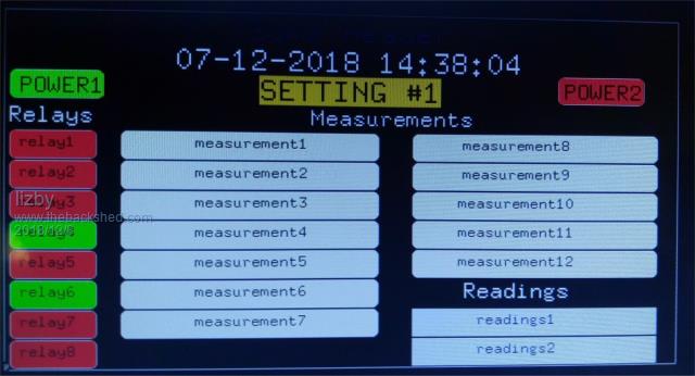

Posts: 3881
Posted: 07:54pm 07 Dec 2018
  lizby said  Is there an example program available for testing graphics on HDMI on the pi-cromite?
After R-ing TFM, I realized how straightforward it was. Some fiddling later, my first mmbasic graphic screen (not GUI).
Here's the code.

Color rendition of the screen shot is not very good. It's actually much brighter.
This is the hdmi monitor: https://www.amazon.com/gp/product/B01GC9WTGK

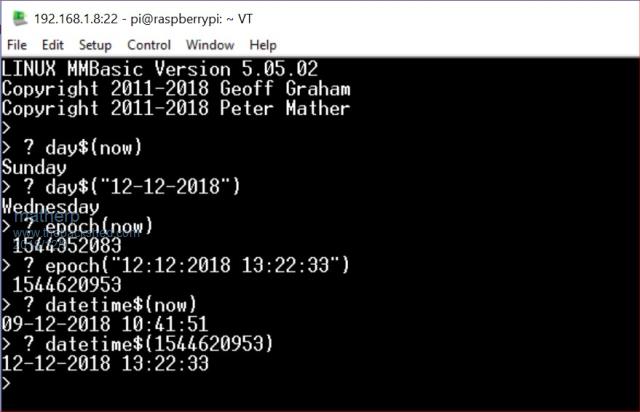

Can we get the DAY$ function on the pi-cromite?
Posts: 11881
Posted: 10:32am 09 Dec 2018
  Quote  Can we get the DAY$ function on the pi-cromite?
Why not - I've also included EPOCH and DATETIME$. NB I've changed DAY$ so that you can use it to find the day of the week of any date. EPOCH and DATETIME$ work back to 1902 with epoch going negative before 1970.

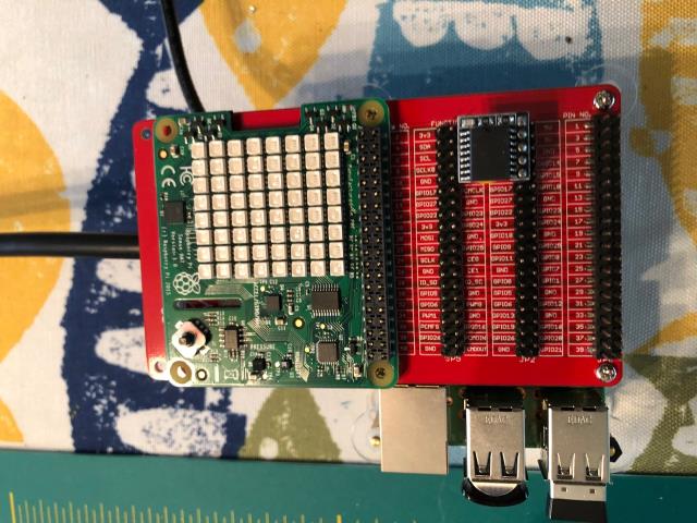

Posted: 06:26pm 10 Dec 2018
I recently added a DS3231 real time clock (RTC) to one of my Raspberry Pi computers.
Here are the two commands that I use for communicating with the RTC;
sudo hwclock -r reads the RTC
sudo hwclock -s writes the RTC info to the system time
The DS3231 I'm using is an I2C device and required the following statements to configure;
dtparam=i2c_arm=on
dtoverlay=i2c-rtc,ds3231
Here's a pic of the RTC mounted on a GPIO expansion card along with a SenseHat.
