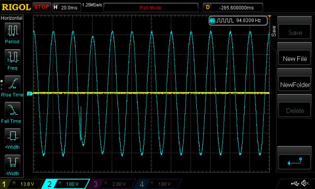

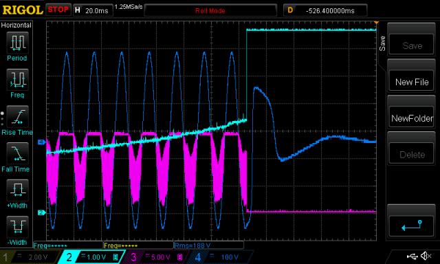

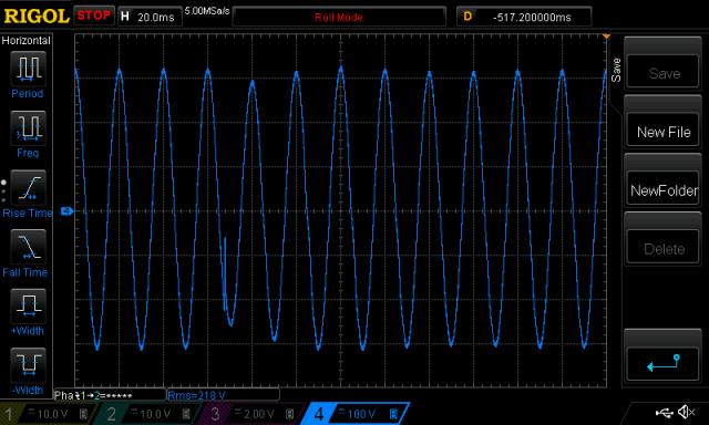

I have improved the transient response in the nano1 code.
This is where the closed loop control is keeping the output voltage at the setpoint.
I looked at what happens if I remove the digital low pass filter that is applied
to the Vfb signal. I used this in my other prototypes and it worked well in
removing noise from the AC output Vfb signal.
In the case of the nanoverter we already have a low pass filter on this signal.
This is implemented with an active LP filter, U10 on the schematic.
The results are good.
Again, same testing conditions as a previous post in this thread.
with the digital LP filter in place:
and with it removed:
This is a lot faster recovery. And to my eyes it seems there is less overshoot.
I would estimate it took 2 cycles to return to the setpoint, compared with 4 or more
cycles with the previous code.
So I want to continue with this code from now on.

My thoughts on this:
The slower recovery and more overshoot is due to the phase change and delay that is included in the digital low pass filtered signal, compared with the unfiltered input.
The closed loop control does not like extra delay in it's input, I had to moderate the gain and damping to maintain a good safety margin to prevent uncontrolled oscillation.
With no digital filtering, and no change to the PID control, we get much more responsive behavior. Simpler code too. I might need to test this against some significantly sized loads, maybe instability will rear it's ugly head then.
I doubt I will attempt an open loop control scheme, this current code performs as well as I can see we need.

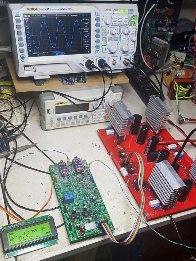

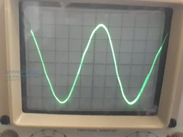

I've just completed building one of Madness's power boards.
I fitted only 3 MOSFETs per leg of the bridge.
It worked first time when I fitted one MOSFET each end, to save repair grief.
So I put another 2 on each end.
See it powered by the nanoverter.
The primary is 45uH E core ferrite and a 1500W Areosharp toroid.
The capacitor is on the 240V end and is 10uF.
It produces a nice clean output as seen below.
It's a credit to Madness to design and provide these good quality boards.
I notice one thing already and that is the board does not like
running at less than about 32V DC supply.
This is non-optimal for me, I test on the bench with a 27V supply.
I wonder if I change one component (the 18V zener) if I could get it to be happy down to about 22V?
Load tests will happen when I can run it at 22V. I have no way of providing a 48V battery near the work bench.

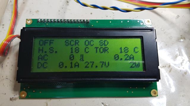

here is the SCR over current cut-out behaviour.
Dark Blue is AC output voltage
Pink is low side PWM, undersampled so it does not look quite right.
Light Blue is the "AC Current" signal I fed into the diode bridge.
I used a simple 5V voltage from a potentiometer, which I am winding up to the SCR threshold.
This shows the simulated AC current signal rise to about 3.4V DC then the SCR triggers. This shuts down the gate drive IC outputs in the middle of a wave form.
No waiting for a zero crossing. It shuts down immediately.

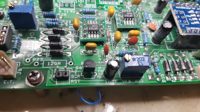

At zero current, there is about 0.167V on this pin. There is something feeding
a bit of voltage into the wiper of r25 trimpot. No idea what. This is the node where
the nano2 AC current voltage signal is sensed.
I have found that resetting the SCR is rather fiddly, it is very sensitive to bounce contacts. The most reliable way to reset is to remove the inverter power, draining
the nanoverter DC-DC converter completely.

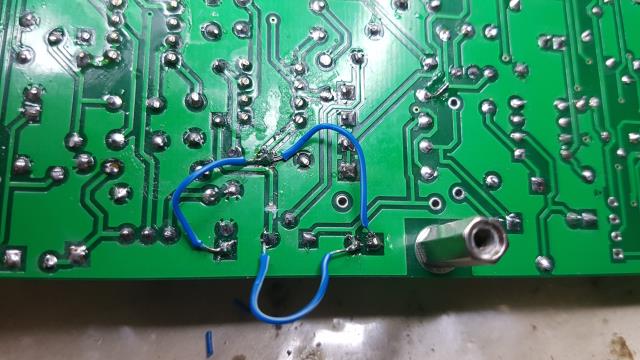

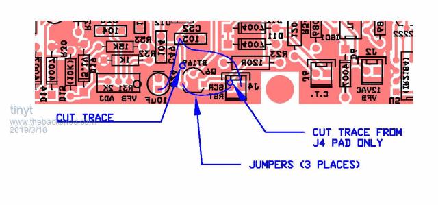

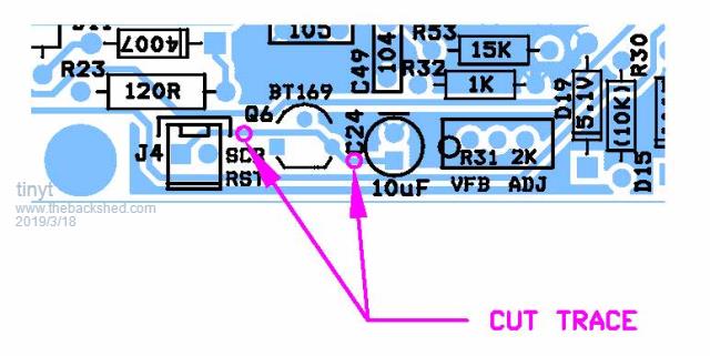

I think there is a flaw in the shutdown switch reset connection. Right now activating the switch shorts the scr making the current flowing thru it go to zero. But this also charges C25 (scr gate filter) to +5V, so when the scr reset switch opens, I think what happens is the scr gets re-triggered by the charge on C25 and also C27. I should have used a normally closed switch in series with the anode of the scr to reset it.
Try the following modification to the pcb and use a normally closed switch.
This is pcb top modification:
This is pcb bottom modification:
poida
Joined: 02/02/2017
Posts: 1497
Posted: 01:34am 18 Mar 2019
Tinyt:
I made the mods as above.
It does not work at all now. When the reset pins are shorted, it triggers,
disabling gate IC output and signalling to nano2 "SCR over current"
When the reset pins are open, no voltage up to 0.75V will trigger
the SCR.
I measure SCR trigger voltage at one end of R22, near C51. This node is equivalent
to SCR gate pin but more accessible for meter clips.
