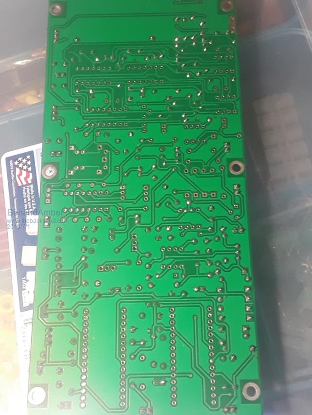

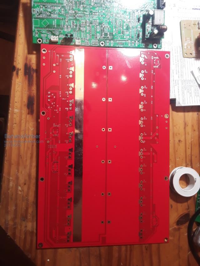

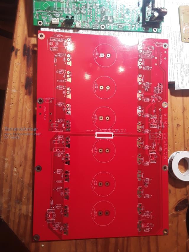

Posted: 01:48am 25 Jun 2019

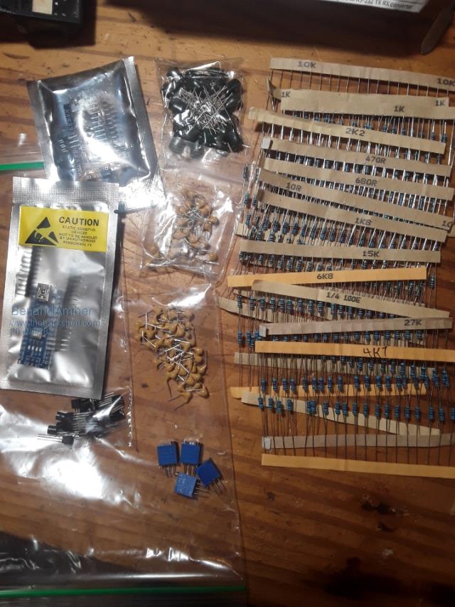

Madness board came in today
I was just starting to wonder about it
Why was going out I checked the mail and there it was
Customs or whatever you call it decided they want to take and look at it also and done a horrible job at taping it back up
But it did make it here in perfect condition
Pictures do it no justice it's very impressive when you have it in your hand
If I ever get enough free time
I'm going to try and learn how to use the designing software to make the art for these kind of things
If it's anything like all the other electronic stuff off came across it's probably a bit out of my range
This board was a real bargain very cheap for what it is

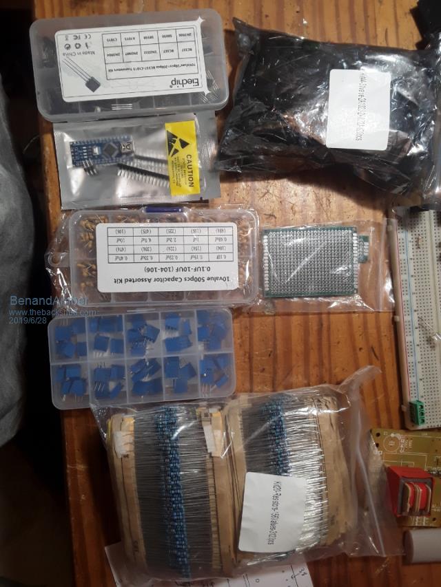

Posted: 11:18am 28 Jun 2019
Some parts came in I've been up all night solderingEdited by BenandAmber 2019-06-29

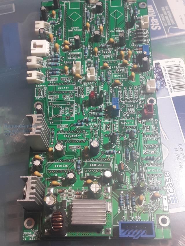

BenandAmber
Joined: 16/02/2019
Posts: 961
Posted: 06:43pm 30 Jun 2019
Still waiting on a few parts hopefully they come in soon
It's been a lot of fun soldering it up
I worked on it when everyone was in bed
I put some spacers underneath the LEDs so they would set up a little higher on the board
I checked all the components before soldering you never know about some of this Chinese stuff
I took my time and went very slow checked and rechecked everything trying not to make any mistakesEdited by BenandAmber 2019-07-02
tinyt
Joined: 12/11/2017
Posts: 564
Posted: 07:35pm 30 Jun 2019
In that condition, it is probably good to test if you have +15V, +12V, and +5V.

poida
Joined: 02/02/2017
Posts: 1497
Posted: 11:30am 01 Jul 2019
B & A,
the board looks pretty good.
I just finished my second board today, got it going.
How to bring up the nanoverter:
First, prove 15V, 12V and 5V, at the DC-Dc converter output, 7812 and 7805 outputs
when you feed the DC-DC converter 48V or something like it.
While powered up, check there is 15V on pin 7 of the IR21844,
and 5V on the 2 nano's supply pins, pin 27
remove power.
Don't forget to use pin sockets for both nanos, both IR21844 and both LT1638
Then program both nanos, label them "1" and "2" and install.
Maybe it's better or even that it works at all, to program them whilst removed from the board. I had issues when programming one nano today, but I think it was a dodgy item.
Bad things happen when you put nano1 into socket 2 or nano2 into socket 1.
I did this and blew stuff up.
Make up a push button momentary ON switch, to plug into J12.
Again, apply power to DC-DC converter, and then when you push the switch, you should see the Green LED D3 light up. press it again and after a couple of seconds or less, it dims.
This is when it's handy to have an oscilloscope:
press the switch again, D3 lights up and probe for PWM on pin 1 of both the IR21844 sockets. You should be able to see the PWM change as the soft start runs up to maximum duty cycle, to stay there. And then when you press the button again - to stop the inverter - you will see the PWM reduce over 3 seconds, eventually to nothing.
Once you see this, then we need to check the correct operation of the IR21844 shutdown pins. These need to be zero volts when not running, even before, during and after you apply power to the dc-dc converter.
Then we need to see it go to 5V when you start the inverter by pressing the button.
There should be 5V present on pin 2 of both IR21844 sockets whenever the green LED D3 is lit up.
After all this, then it's time to install the IR21844 ICS, the two op amps,
and provide the 12V AC feedback on J7.
We need to turn the VFB adjuster R31 clockwise all the way until you can hear and feel it click, click.. This puts the VFB setting to the lowest output voltage, hopefully much lower than what you will eventually set it to.
Remove power. What a little to make sure nothing is on any of the 10 pins of the connector.
Connect the 10 pin ribbon to the power board, run the inverter with power supplied
to the inverter power board.
If all is well, you could then adjust R31 to the required AC output.
I would not build the power board with all MOSFETS installed. I would only build it with 1 for each of the 4 legs of the bridge. And I would install a small capacitor, if any, in the DC supply locations. This is the power board I would first try things with, to prove the correct operation of the nanoverter control board as well as the power board. No load testing is needed nor would it be helpful at this stage.
And no heat sinks are required when testing it with zero loads.
Then once things are going well, add all the MOSFETS, all the DC bulk caps and test it. With the addition of the huge DC bulk caps, any issues will result in a bit of fireworks and the need to replace large numbers of FETS.
Oh, and when soldering the FETS, I leave a bit of length on the leads, enough to let me get the side cutters easily onto the leads should I have to replace them.
It's best to snip all 3 leads first, then de-solder the short remaining lead bits, rather than try to de-solder the entire MOSFET, 3 leads at once.

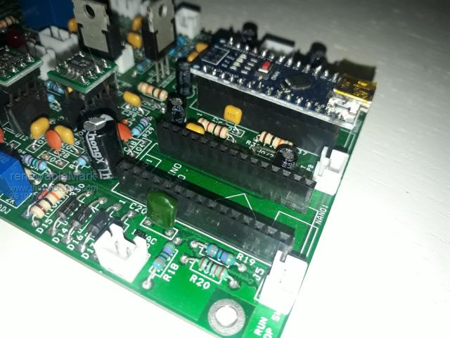

BenandAmber
Joined: 16/02/2019
Posts: 961
Posted: 04:56am 02 Jul 2019

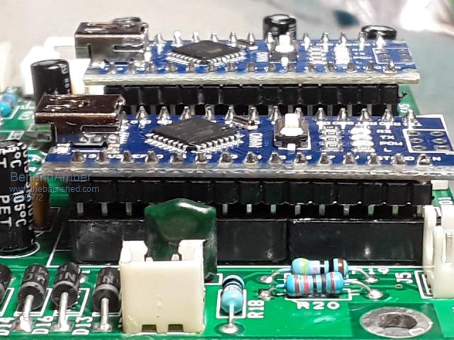

I made some Nano sockets out of regular IC socketsEdited by BenandAmber 2019-07-03
renewableMark
Joined: 09/12/2017
Posts: 1679
Posted: 06:14am 02 Jul 2019
Poida the great!
That is a great write up for nano test.... excellent.
Ben, dunno what sockets you used, doesn't look like they are pushed in all the way.
I use this type but doesn't matter as long as you get a connection.
Also make sure the USB socket faces out when installed.
Cheers Caveman Mark
Off grid eastern Melb

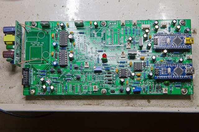

poida
Joined: 02/02/2017
Posts: 1497
Posted: 10:00am 02 Jul 2019
B & A
you have the nanos installed barse-ackwards.
here is mine, with all you need to run an inverter.
But - there is no mains sync and no RS-232 support populated.
This board works exactly as we need it to.
I placed a low power 15V DC-DC converter on it but it can not provide
enough amps to run 2 fans.
Testing....ok?
imagur link to full size photo

poida
Joined: 02/02/2017
Posts: 1497
Posted: 12:23pm 02 Jul 2019
Mark,this is board no. 2.
I used the proper supply in board no.1, I only had one of those.
This supply is a weakling and can't give enough to run the fans.
But it's good enough for testing the inverter.Edited by poida 2019-07-03

There's a couple parts that I I still haven't ordered
The lt1638 I was trying to find them cheaper somewhere
Five bucks a piece 4 through hole $5 for 10 of them a surface mount
Almost all the parts of this board is very cheap
except for just a few and those few are very cheap if you do them in surface mount
Please don't take me the wrong way
I'm not complaining
I am very grateful to just be able to have a board to build
And I am very grateful for all the hard and brilliant time-consuming work that poida the great has put into this
This could have been done this way for a reason that I don't have enough knowledge to know about
But if these few components were done as surface mount you could build these boards for a lot less than half the cost
I do understand that 50 or $60 for a complete control board is already very cheap
Please understand I am very grateful and I am not criticizing just saying it could be a lot cheaper
I bought resistor kits capacitor kits and on and on
everything that could have been bought in a kit that's how I brought it
This probably brought the overall cost up quite a bit
But all in for 2 boards came up to $152.45
So about $75 a board for me
this could have easily been reduced to at least 50 or 60 a board
if not less by not buying kits for all the components
To compare this a power jack control board is around $129 and 29 shipping
158 for power jack control board
75 for the Nano
This is not taken into consideration that's a power jack control board is a piece of crap
they tell You themselves have extra parts for it because they know it's going to blow up on you
all things considered I'm a very happy camper and I appreciate all the hard work that I get for free
Thank you

One of the Nano control board will be going into
a 8000 watt 2014 model aluminum case Power Jack
It has a bigger than Factory Transformer
I will be using the factory main board
But the mosfets will be replaced with hy4008
The second Nano will be used later
on Madness 8000 watt board
I'm going to wait around and get a Transformer that's over a hundred lb for it
Up next after the Power Jack will be a attempt to make a warpspeed inverter
For anyone that may be wondering the little four mosfet inverter
that
Poida the great told me how to build
Is still going strong
