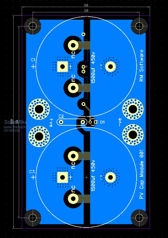

I have managed to get ten B43511 EPCOS 1500uf 450v caps from an old switch mode psu unit, tested them they seem ok, ripple rating is 14 amps @25c.
Have designed a pcb to mount multiples of two, so can do some tests on various values. If I make all the pcbs < 100mm sq then they only cost 50c each. 200k resistance with led to show they are charged..
Mike
Posted: 04:40am 30 Jun 2019
I had three 15,000uF 63v connected in parallel at one stage with a no load solar voltage of 40v.
Had a little bit of an accidental short across that, created quite a bang.
I wonder if fusing the capacitors individually might be worth doing ?
