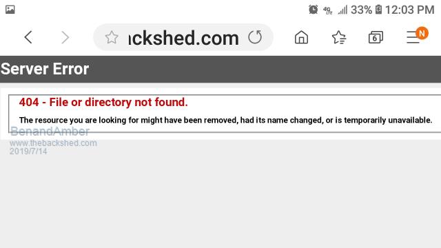

but the search function has not been working for a few days now
here's the screen I get when I click on the search function at the top of the screen
All information is really hard to find on here you have to read 4 days to find one little piece of information

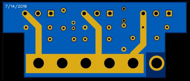

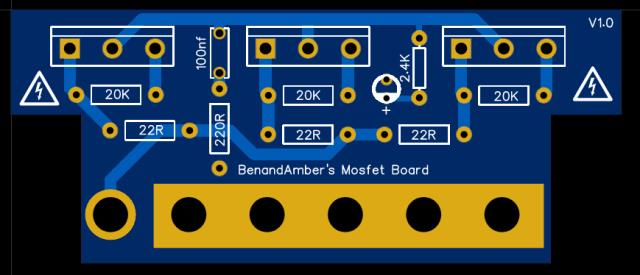

2019-07-15_133509_MosfetBoardV1.0.zip Here is the updated board
Edited by kentfielddude 2019-07-16
BenandAmber
Joined: 16/02/2019
Posts: 961
Posted: 03:36am 15 Jul 2019
That is absolutely awesome I really appreciate it

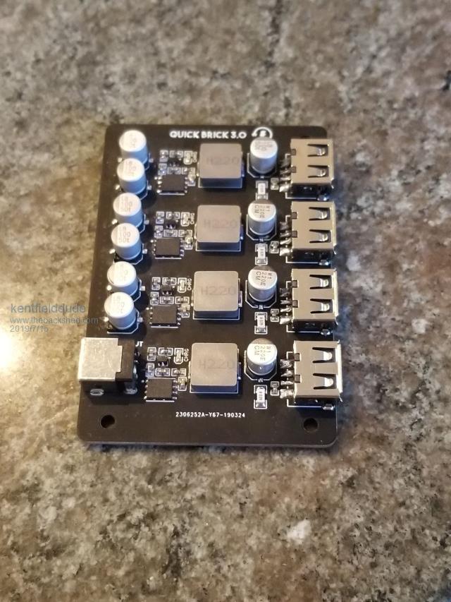

I made and designed this 4 port quick charge 3.0/apple fast charge usb charging hub. Capable of 3 amps on each port simultaneously.

Kent, That is a brilliant piece of engineering!

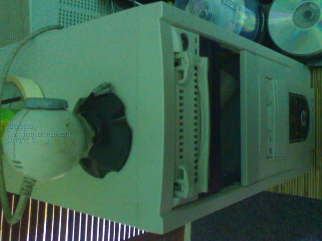

Ben, I wasn't going to spend a big amount for a PJ. I'm actually working on building a LF inverter into a old Gateway computer tower. I saved the PC tower for a DIY welder but have decided to build a Oz inverter inside of it instead.
The PJ stuff is interesting, But they are also quite disappointing. I always said If I got one, I would rip off the labels and repaint the dang thing so I don't have to see their crazy advertised wattage that's bogus.
