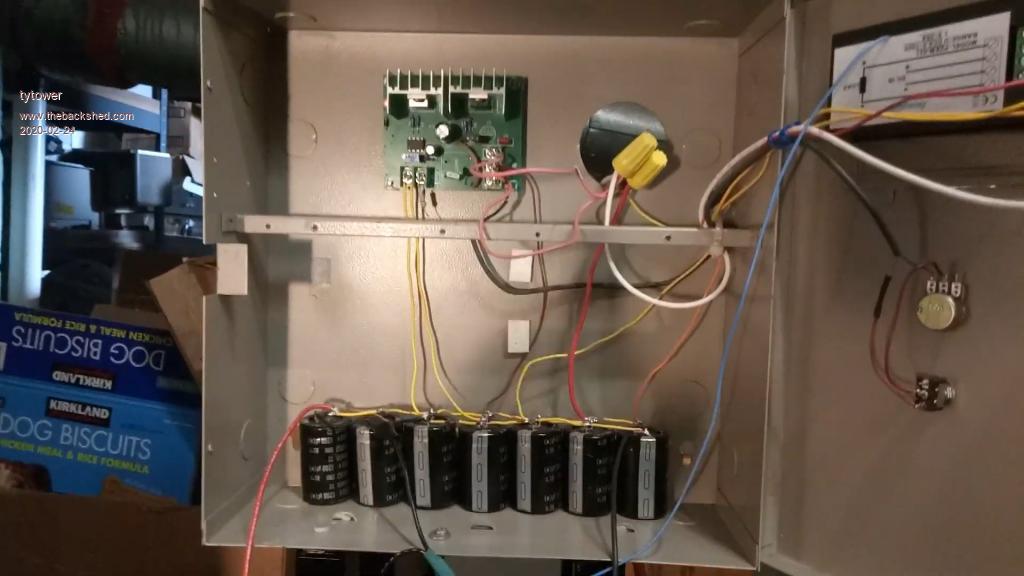

Ill start a new thread on this . Just wondered if you have seen the Youtube videos of a guy called "Opera"?
Hes heating hot water direct from solar panels he claims but I have tried following what he's doing and he has made it very confusing. Changing inverter boards and supercaps, out of focus and poor lighting etc.
Ive got one going to the point of getting a voltage out of the board but its damn hard to work out where to connect the ins and outs . So anyway I'll start another thread and hope you guys will jump in there too . Thanks.

I have been working on something similar for many months and finally cracked it.
Rather than using inverter boards, I have used a a Battery charger board and a voltage level switch.
They are both 12V but I will use them to regulate an array of panels that will go to about 260V and run on a normal 240V element.
I'm using a voltage Divider to get the voltage from the panels down to something the board can handle and measure. The panels will charge a bank of caps to their open circuit voltage and then once they reach that, the board reads the voltage and triggers an SSR.
The Caps Discharge into the element and the board resets and repeats the process.
The boards have mechanical relays which are bypassed and the output taken straight to the SSR which require less power than the mechanical relays. The voltage switch boards have an upper and lower limit. I don't think the lower limit will be needed as it will climb fast just on the caps and I don't know if the board could cut fast enough anyway.
As warp worked out, 10% off power point does not make a lot of difference to the panels and as the load from the caps is minimal during charging, they seem to come up very fast and the cycling is also.
In testing with a 100W Bulb as a load and just one cap and panel late in the afternoon, I could not get any illumination from the bulb at all, not even the faintest glow. Even with the mechanical relay doing the switching (which is very slow in comparison to a solid state device which could also just be a mosfet or series thereof,) The bulb lit quite well. A very graphic illustration of the benefits of having the panels in their happy place.
Before this I experimented with just a PWM controller. This was also enlightening ( pardon the pun) as even with this, it was evident much more power could be gained over the course of a day throttling the load at a fixed rate than just having the panels directly connected which was hopeless.
The vids opera made no sense to me but reading here I got the idea of what needed to be done and worked out what I could use to achieve it.  I imagine the efficiency is still Horrible compared to what the smart people here have built but I'm happy I was able to work this out and it's a LOT better than nothing at all that's for sure.
From here I just need to work out what are the most common and easy to get boards as well as the cheapest that will do the job so I can do some step by step how to Videos and standardise the procedure for others to follow.
One thing I may need to do is work out how to measure the highly pulsed output to compare it to direct coupled.

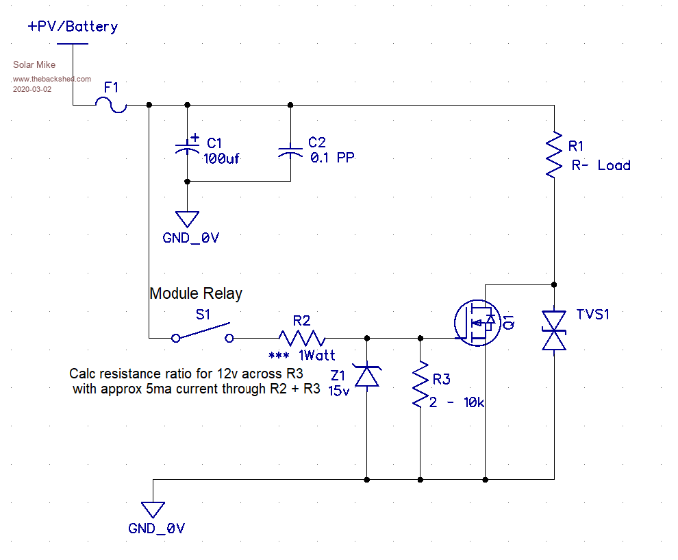

There are probably two fairly obvious contenders for mosfets.
FDA50N50 which is 500v 48 amps and rdson 95 milliohms these are available from e-bay for about $15.  I have used a lot of these, and are what I currently run in my Warpverter for the two smaller inverters.
TK62J60W this is a much more recent device 600v 62 amps and rdson 33 milliohms available from e-bay for around $25.
Either would do. I think I would prefer the cheaper device to experiment with initially, and probably the larger one for the final project once any bugs have been sorted out.
Its important to connect a transient voltage suppressor right across the mosfet source to drain. A 1.5KE350 (350v) or 1.5KE400 (400v)would be ideal.
How much heatsink ?
A 3.6Kw element might be carrying roughly 15 amps, and 95 milliohms would be 21 watts for one of the smaller mosfet. The absolute minimum for that might be about a five inch by five inch vertical flat 3mm aluminium plate, and something larger would be advisable.
A pair of the smaller mosfets would halve that power and spread the heat better.  Instead of 21 watts for a single mosfet, 10.5 total watts would be spread across two mosfets.  In other words about five watts per mosfet. That would be far better.
The larger devices are much better with 33 milliohms. One mosfet 7.4 watts and a pair only 1.85 watts each. That does start to get expensive though.
Its not so much the current carrying capacity as keeping the mosfets cool that will be the main consideration.

Could you briefly explain why you suggest those mosfets instead of something like an IRFP460? Nothing to do with the fact I'm cheap ( really!) just Curious.  Is it because of simplicity of using 1/2 of those instead of Multiple of the others?
Also, can these be nameplate rated  in this application or do you suggest say 50% rating or 25% amperage?
I looked up the voltage suppressors and have ordered them already.

I was just playing with the capacitor bank of 4X 1000 Uf units. It's just after sun set and there is no direct light on the test panel on the roof over my office. My inverter with about 11Kw of panels on it on the same roof is making 25W so it's for all intents and purposes dark as far as panels go.
I hooked up the test panel to the cap bank and put a volt meter across it and then shorted the caps with a screwdriver. When I removed the short, the cap bank charged back up in a bit over 2 seconds.
I know it was said that the cycling rate didn't matter but is this going to be too fast when there is actual sun on the panels and I'm pumping a couple of KW or more into them?  I have seen others here and on the net tend to use many more caps so should I go for 10 instead of 4 or it just won't make any difference at all?
Might drag out some panels tomorrow and hook up the water heater and see how it goes with a KW of panels attached.

This morning on my web trolling for boards I came across this one:
battery charger Board
This seems to be a new generation and step up over the existing boards. It uses an LCD readout instead of the LED decimals that look like a throw back from the '80s and the thing seems to have IO ports and mentions data collection.
I have ordered a bunch of these for both my solar water heating proclivity and to use as designed. With a 6-60V input, they can easily be coupled direct to a panel and a battery.  Used others like this but so far what I have found all needs a voltage converter to work with panels.
My father has a bunch of things in his machinery shed with rather expensive float chargers on them.  My machine shed has no mains power so these things would be idea.
One 190W panel would drive a fair few of these things to float voltage for maintence purposes and the price would be less than a 10th of a lot of these commercial float chargers.
I find looking at them the 30A rating to be highly Likley typical complete and utter chinese bullship but not really a concern. There is another similar board that is different and rated to 10A but again, for my purposes even half that will be fine and If I want high power I'll just use the thing to control an SSR.
These would also be good for a mains battery charger. Mine is a High power thing but not automated and I have forgotten about it before and boiled batterys with it.
I'll put one of these in with the posh looking LCD and not have to worry again.
Thought these were very interesting with the LCD and the IO ports as to just how advanced these cheap little boards have become.  Looks like LCDs have become cheap enough to put on other things as well now.
I do wish they would do away with the mechanical relays and use SSR's or Mosfets though. Make my water heater setup that much easier. Haven't seen any that use a Mosfet so far. I'd think that would be an advantage for reliability and for use in not having a relay clicking all the time.
Solar Mike
Joined: 08/02/2015
Posts: 1255
Posted: 05:08am 02 Mar 2020
Hi Davo, that's a good find, keep us informed how well it works.
You could add a mosfet to the mix, see cct below; use the on board relay to switch a +ve gate voltage to an external mosfet or 2 in parallel.
If you need assistance in calculating suitable R2/3 values PM me.
Mike
