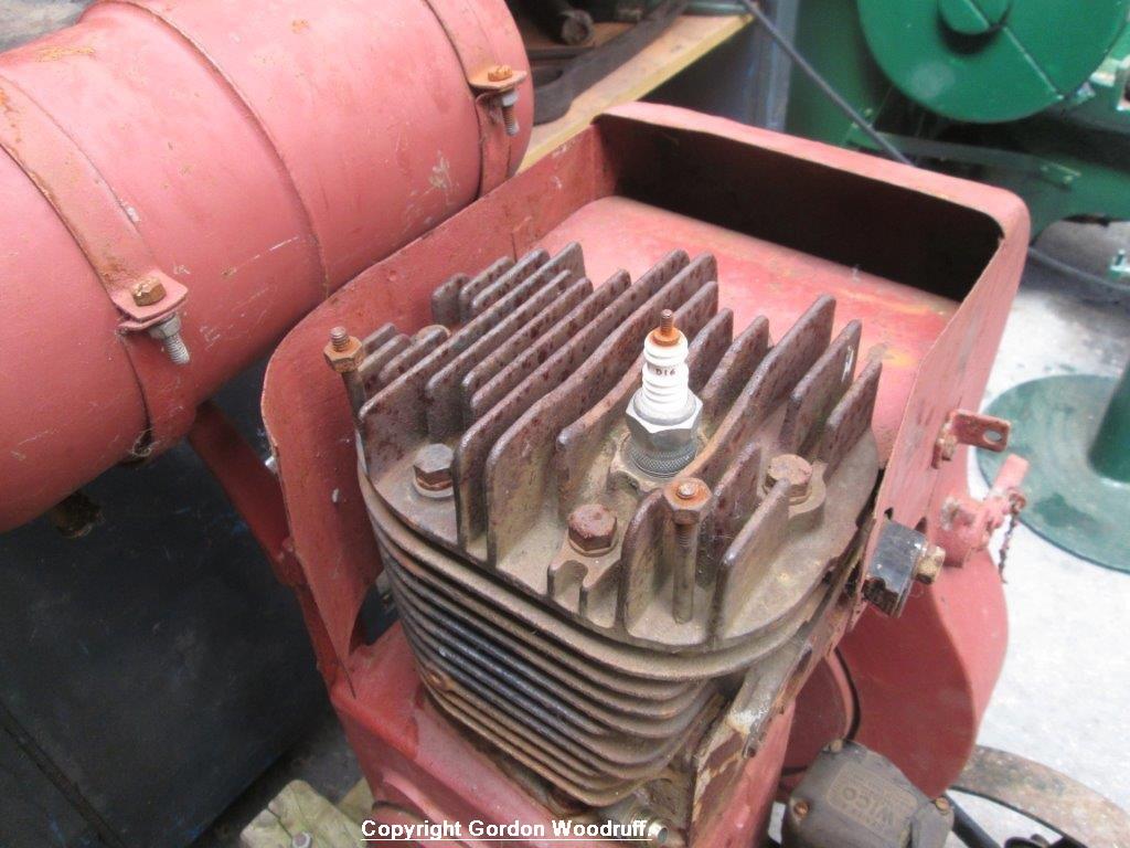

Dave,
This Wisconsin has a very large cast iron crankcase, with a finned cast iron barrel bolted on top with four studs. The crank spins on two enormous ball bearings.
Physically its quite well put together and very strong.
I may never actually do any of this, but right now its just something to think about.
I will probably eventually just get a more suitable water cooled engine.
As I already have an unlimited supply of natural gas out in the shed, whatever I get will definitely end up with spark ignition, even if its a Lister !

  Warpspeed said  Dave,
I can only ever remember working on 1 Wisconsin and it was a typical briggs type aluminium setup.
It's a wonder an all cast Iron engine wasn't a lot more popular. The Briggs engines were absolute garbage, how anyone ever thought they were decent and they gained a following is beyond me.
An all cast engine would have been strong, repairable ( especially if it has a separate bore) and last a good long while.  Briggs had an aluminium bore and then sleeved the IC ( industrial/ commercial) series with an iron liner to give the things some longevity.
Never saw a Briggs with roller bearings although I believe they have been using them since I stopped mucking round with small engine repair.
The Briggs had the crank and cam also running straight on the aluminium housing. They could wear that much that you couldn't set the points because of the crank slop was greater than the points gap.
That Wisconsin sounds like an engine built for work and to last.

Posted: 04:04am 22 Aug 2019
Wisconsin S12d crank (same as mine) picture off the internet.
The main bearings are eye poppingly huge.
These came in various different bore sizes, the S12 was the 12Hp version.
This Wisconsin has both a bolt on cast iron barrel, and cast iron head.
My head is aluminium.

Posted: 08:43am 22 Aug 2019
Thats quality!
Aluminium head would be better than cast as well. Much better thermal conductivity.
If you did a water cooled head you could muck around with the squish chamber and bump the compression especially if you were using gas.
Clearly there aren't going to be any stress issues with the bottom end.
