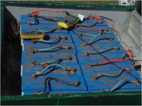

I did some work for a fella who needed a few kilometers of trees pushed down to allow his overhead wires to go to his house and get grid power.
As it turns out, the grid was duly put on, and I thought no more of it, he paid for the fuel and hydraulic oil and transport ... no problems........the months tick by......
Yesterday, he fronts up with a utility full of 125 AH 6v yuasa batteries (UXH125-6).... 16 in fact.... 48v@250AH. as a thanks for helping him out ...... with a grin from ear to ear.
So I quickly put them on the end of the chainsaw blade mill to see just how stiff the windings actually are.
Here are the new gifts...

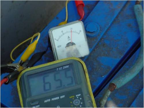

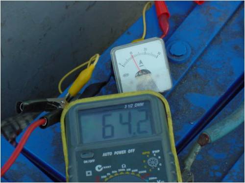

It was another clear day with fairly light winds with a few gusts from time to time. Mostly it sat around at this level (500-600watts or so)
Now and again a decent gust would come along ,but only lasted for a minute or so then go quiet again (500w) .. a 1300watt gust looks like this:
A decent gust came through which lasted for about 2 mins, and pushed it up to 31 amps at 70.6v.. or about 3 horse power in the old money. (2100 watts).... and the camera was back at the shed.
The way the mill pushed up the battery voltage I think shows just how low impedance this alternator really is, or how rapidly it charged them up to fullish, and then pushed them up fast.

I am not so sure of this. I know the alternator is a great performer. I am a bit concerned at the batteries. Either they are fully charged, I would not think so, or need some TLC. Probably some sulfation going on there. I would take a few kWhr out of the battery and try again and see how quickly the voltage rises when there is somewhere to put some power.
The batteries should handle 10-20A without too much voltage rise when absorbing.
I am still using dead batteries after 2 years Even a residual 10% capacity gives enough power to run a plasma TV for a couple of hours

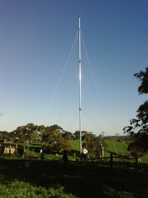

PS I attach a photo of a good tower for your mill.
19m high and 150mm Gal steel. check the relative height of a person.
become more energy aware

You are correct, the batteries are fully charged (they weren't, but by the time I finished fiddling around, this mill pushes them up pretty fast, and when the gusts finally come on in the late afternoon, they are too much, too late.
Apparently they take 40 or more amps when they are down, I just have not got a load of any consequence at the moment. I will use a 4kw DC motor into a 7kw 3Ph motor and drive it into the grid.... at least get my 80 cents back (20c per kwh)
I will have to drop 5-6 kwh out of them (12kwh pack), and try it all again....
I do like the tower, I have two 12m lengths of 7"x1/8" wall galvanised pipe for mine.... If I'm developing this kind of power at ground level on nice days, I should have plenty to go around when I'm high in the air.
The chainsaw is out again, we are cutting some new blades from Macracarpa for the AWP up the hill at Jamies place... covered in saw dust again.
Edit: It is interesting that it only raised it a volt when the amps went from 10-20 amps, but another 4 or so when it pushed over 30amps.... The 30 amps came a bit later, so SOC was probably way over the top by then. interesting.

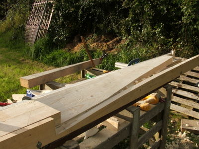

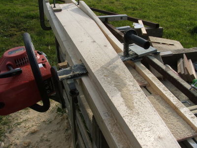

Well, our friends in Ireland have had a go at this chainsaw business, and done a way better job than me at it.
Check this out.... Irish renewable site
and this photo collection. The man did some magnificent jigs.... I've been shamed big time...
pictures of the jigs etc
There was also a picture on Hughs site of another fellow in Ireland building them at one of Hugh's classes at Galway...I think, but the picture has moved somewhere else..
These blokes have taken it to a new height methinks.
And with improvements like handles on the blade slide jigs too, and roller bearings on the side...... WOW
The finish is beautiful, and the twist is complex not just simple like mine was....
