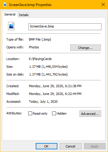

Has something become broken in the 'save image "filename"' command?
When I try use it now, either from the command prompt or in a program, the system hangs with SD activity.  The reset button is required to regain control. A file is created on the SD card with the expected name but zero length and time code of 00:00 00-00-1980
(Release version 5.03.03)
Never mind, I see it just takes a while to save the full mode 1,8 screen: 65 seconds!

  vegipete said  Has something become broken in the 'save image "filename"' command?
What size is the file?

  CircuitGizmos said  What size is the file?
The resulting BMP file, after impatiently waiting for ages, is 1440054 bytes, as reported by Windows:
The image is 800x600 pixels.
It takes my system about 6 - 7 seconds to save in any of the mode 1 screens.
Running latest beta firmware but I never noticed any slowdown in any of the firmwares.

Sounds like I have some experimenting to with my SD card. 4Gb card with about 11 Meg used at the moment. Card has been completely problem free otherwise, always worked fine on an original CMM too.
Posts: 6606
Posted: 11:29pm 01 Jul 2020
I was using a 2GB card which gave the 6 second save.
I just tried a new 16GB card and had to change my setting to OPTION SD TIMING CONSERVATIVE
Now the same 800x600 save image takes 2.06 seconds.
