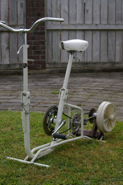

Hmmm.... I dont think the efficiency of the F&P needs to be be all that bad.
Unfortunately I dont have a nice lathe or motorised rig to do any tests but I did build a rather simple pedal generator on an old exercise cycle.
When I started on that project I found the F&P almost impossible for me to pedal at even a few hundred RPM even without a load connected. So I started changing things.
My final configuration retains the heavy metal flywheel of the exercise bike and I added another chain stage to drive the F&P which now has about a 6:1 ratio with the pedal crank.
According to the cycles at the gym I can pedal for extended periods of time at about 100-110 RPM.
What is the output of a F&P at 600RPM into a battery load? A few hundred watts I imagine.
Around about now readers of this post will be thinking I am away with the fairies as there is no way a 60+ overweight office worker can put out that sort of power, and they would be right especially if I recall correctly a Tour De France rider puts out about 500 watts!
What is different though is that I modified the F&P by cutting away about 60-70% of the stator! Thats right, with my trusty saw I cut around the stator removing all the coils for about 2/3 circumferance. This of course also reduced the magnetic losses and 'cogging' drag by the same amount.
Gentle relaxed pedalling produces about 60 watts into the battery and just a little more pressure on the pedals, I dont have to get out of the seat or anything like that, produces in the region of 120 watts.
From this I conclude that the F&P has very high losses at low RPM and that the efficiency is higher at higher RPM though no doubt there is a peak above which efficiency falls off with rising RPM and maybe rather steeply.
I think that if one built two windmills with the same blades one driving an F&P directly and the other geared up driving an F&P with half (or so) of the stator cut away there would actually be more power produced by the later.
