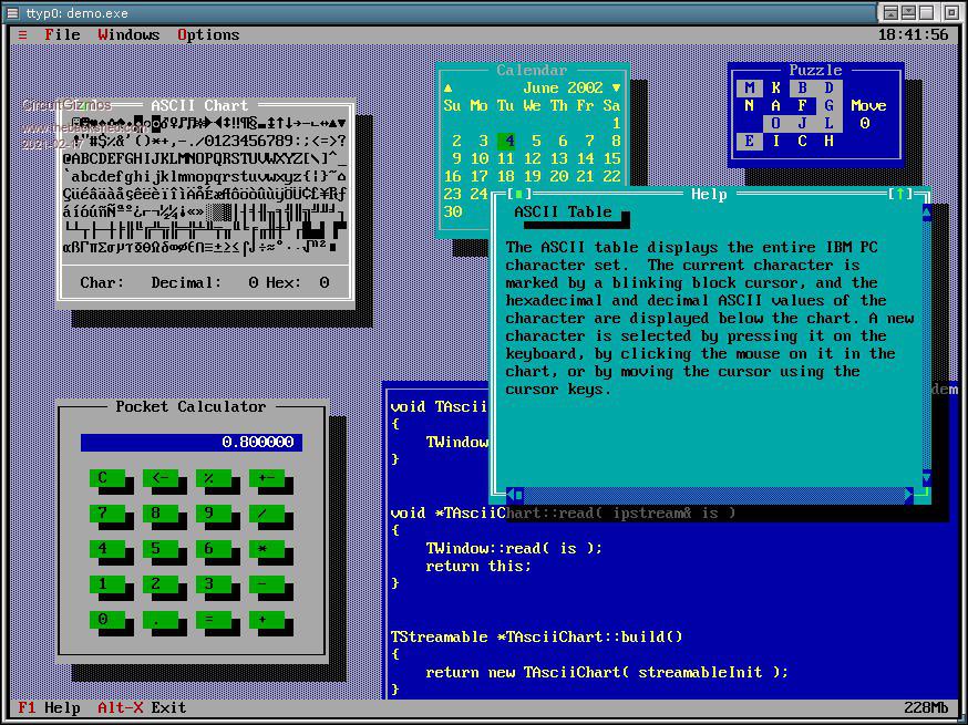

  RetroJoe said
Along with VegiPete's standard file dialog, there were multiple threads in the ancient past (i.e. before the CMM2 had mouse support) about creating a TUI toolkit, and TassyJim's test code (e.g. the Quit button) provides a tiny glimmer of how a GUI would work.
I'm wondering if this is something a few members of the MM community would want to collaborate on via GitHub i.e. a rudimentary "Windows 1.0" era GUI builder with user-definable command buttons, check boxes, radio buttons, et al.
I'd like to see a TUI like this:
I think it would be simpler and faster than graphics. I know the display is graphic and not character based, but this is still doable, smaller, and likely more responsive than graphics. Plus you can still do graphics inside a TUI element.
As a "standard library" a TUI would help in educaton.
Edited 2021-02-17 02:58 by CircuitGizmos

  CircuitGizmos said  I'd like to see a TUI like this:
But perhaps not via TeraTerm if it doesn't support the box-drawing characters which that screen-shot makes use of extensively.
There is a question here of whether a TUI should be designed just for use via the VGA display or also via a Serial terminal, which the 1980's shows us should be possible.

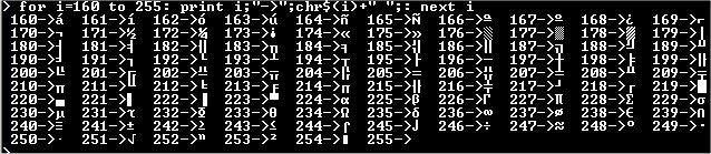

Posts: 3879
Posted: 06:11pm 16 Feb 2021
puTTY in VT100 mode works (mostly) for me for PC-type line drawing characters:
I did not pursue why some of the characters (e.g., some corners) didn't work.

Yikes, the code? This is in C code compiled into MMBasic DOS, a project put on the back shelf some months ago, with output to a usb/serial module (the same one (or two of them rather) that you posted about a few days ago).
But on an Armmite F4 (CMM2 not available to me now), and Teraterm in VT100 mode, this lists what's available:
for i=160 to 255: print i,chr$(i): next i
Or, more compactly: for i=160 to 255: print i;"->";chr$(i)+" ";: next i

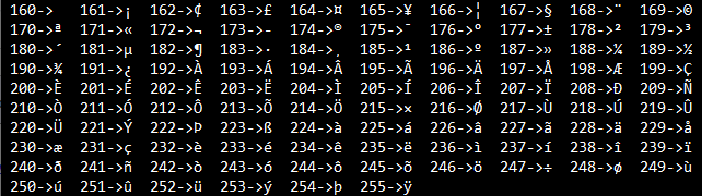

Posts: 4398
Posted: 08:13pm 16 Feb 2021
Thanks @lizby, what I've been seeing is:
However I've now discovered if I switch the font to "Terminal" then I do get the correct characters - you live and learn, it's a pity it's such a strangely proportioned font. I thought it was a code-page problem and couldn't find a way to change the code-page in TeraTerm.
Thank you,

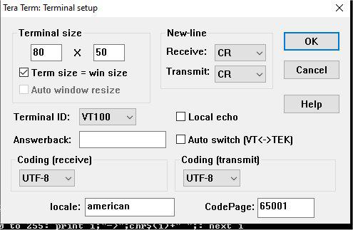

Posts: 3879
Posted: 09:38pm 16 Feb 2021
This is my Teraterm terminal setup:
I found that when I tried to copy (Ctrl-c) the Teraterm screen with the line-drawing characters and paste it into the forum here, I got the characters you show. That's why I did a screen shot.
