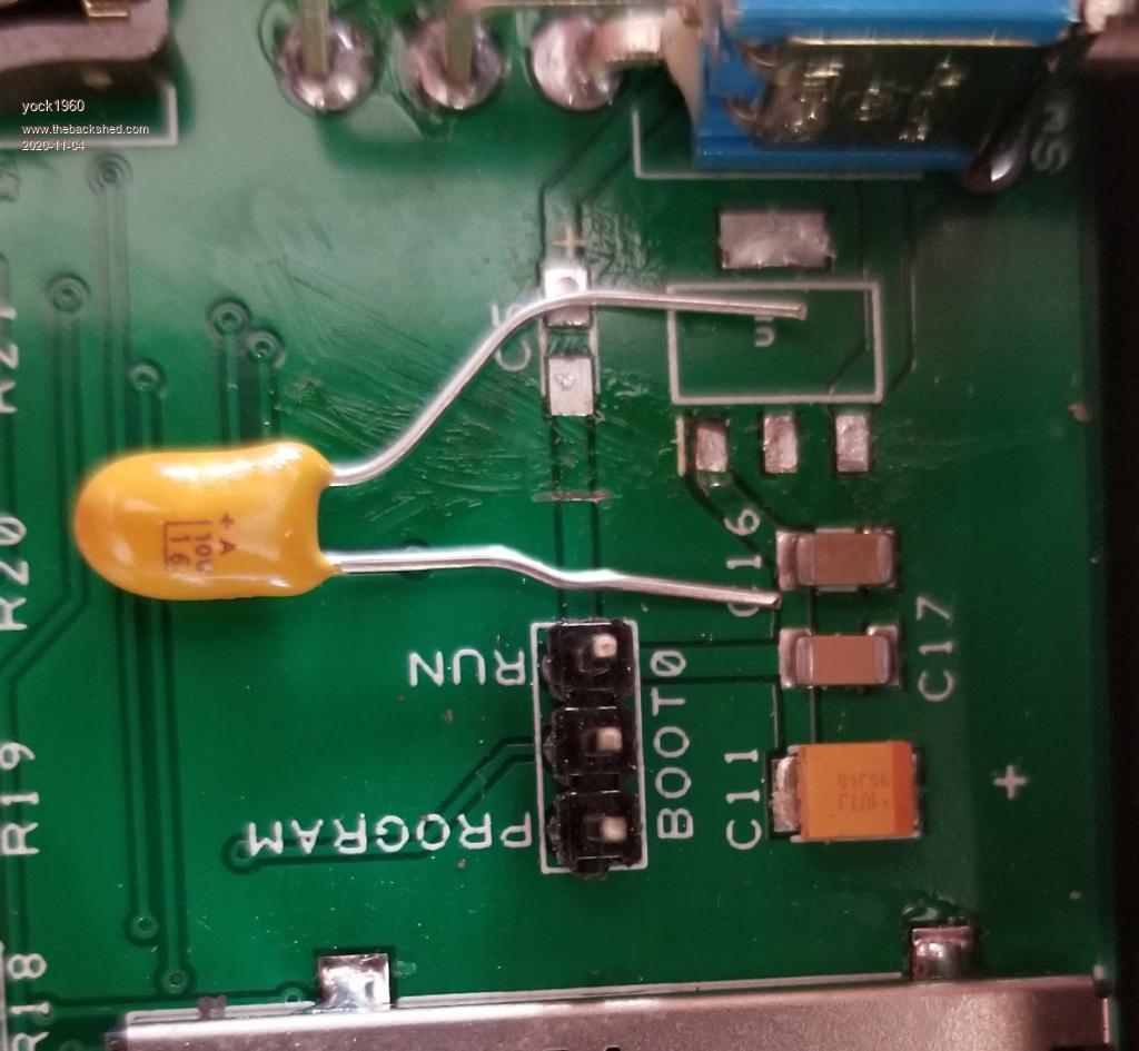

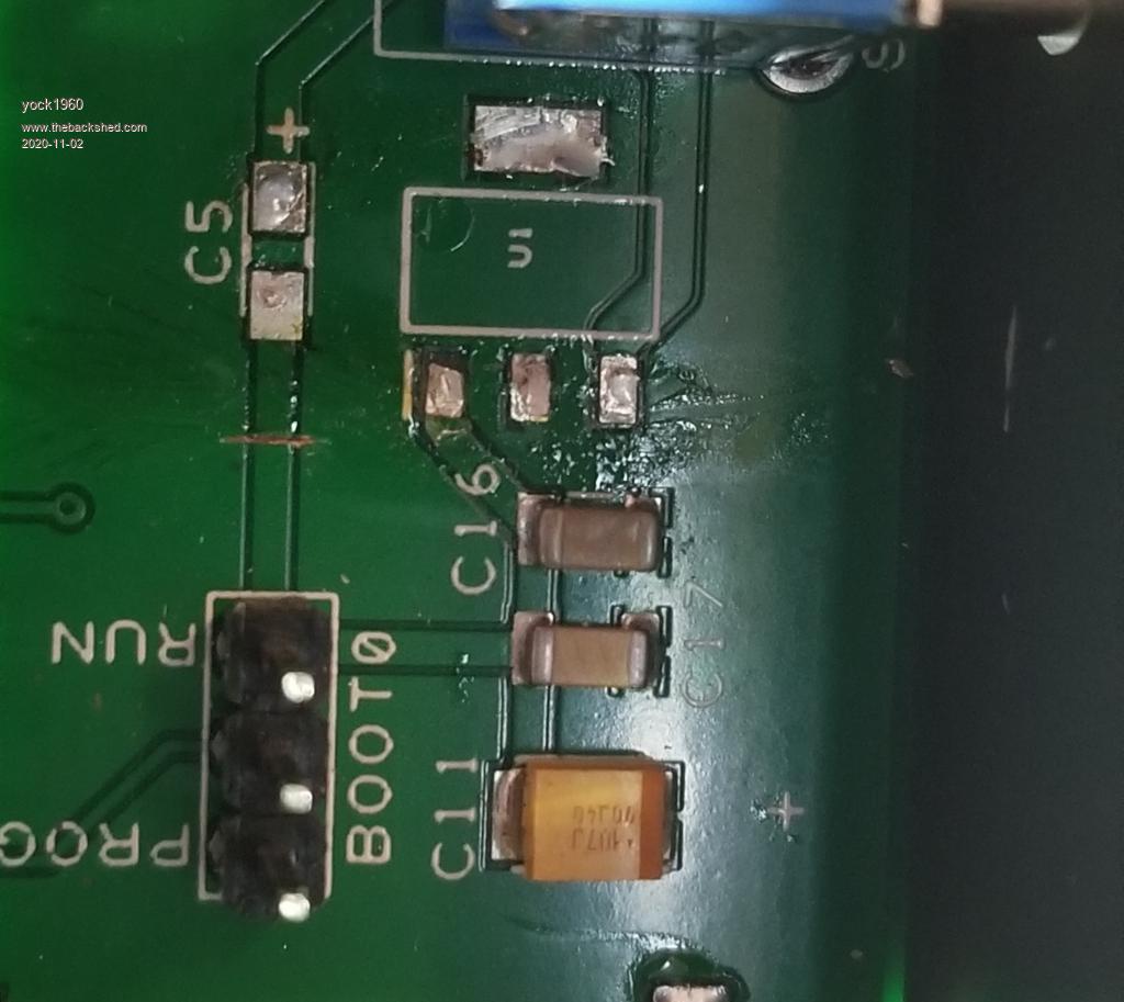

Well, C5 was easy to get off....the regulator...not quite as easy. One of the traces tore loose a bit...is that fatal?

I just checked and I have continuity between the damaged trace/pad and C16, with the other end trace and the + side of C5...I guess I'll look at the schematic to see if I can figure out where the other two pads go to and check those....and order a couple of regulators.

The damaged pad doesn't look too bad. I have seen a lot worse on some I have done.
The AMS1117 is the same as the LM1117.
Either will do but make sure it's the 3.3V version. They both come in a number of different output voltages.
The one you linked to is correct.
The two pads you haven't traced/checked yet are both the 3.3V output and are connected to the top side fill area. You should be able to see the small links from the pad to the fill. The small links are used to give thermal separation from the big copper ares. If the connection is too big, it makes them hard to solder.

I would be extremely careful with the damaged pad as it is the GND pin and the top layer cooper pour is actually on Vcc.
If it was me I would cut the pad away so there is no loose track or pad even left. Then solder an LED wire or stiff single core wire from the leg of the replacement Vreg to the side of C16 that the trace would have gone to. Making sure there is no possibility of shorting to the copper pour area..USE A METER to test that the fix is clear of the vcc pour.

How about just stabilising the loose track with a spot of superglue from a toothpick, making sure it's in the right position. Solder the new reg in afterwards once it's stuck down. IMHO putting  a wire link in might be more difficult. Dabbing a wire on anywhere along that ground line would run the risk of shorting it to + anyway. The solder mask will help, of course, just as it will in the reg position. Plenty of flux and  some quick soldering.

My concern is the large area of copper that flows around all of the pads on the TOP layer is connected to VCC IF the loose trace moves and touches this copper area (called copper pour) then you will short Vcc to GND.
You 'could' possibly glue the pad back but the trace has been compromised and really should not be relied on especially as this VReg supplies all of the 3v3 power to the CMM2.
I said LED leg as it is generally a bit thicker than a Resistor or capacitor leg, I would avoid braided wire as a stray strand could find its way through to the copper pour.. Solid strand is easier to solder anyway.

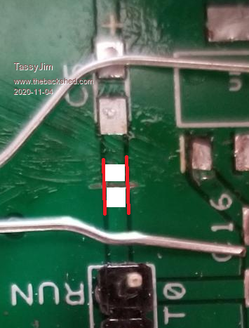

I would run a scraper down the edges of the track you cut earlier. What Mick is correctly worried about is shorting the trace which is ground to the copper fill area which is 3.3V
The area circled looks a bit suspicious.

In light of TassyJim's concerns above, can I do something like this? Scraping a small section of the trace, soldering there and being very careful not to get solder in the cut.
Steve
Posts: 11873
Posted: 06:37pm 03 Nov 2020
Solder a new regulator on and if you have a clean supply you can probably ignore C5 completely. Certainly no issue testing without it

  yock1960 said  In light of TassyJim's concerns above, can I do something like this? Scraping a small section of the trace, soldering there and being very careful not to get solder in the cut.
Steve
It is the vertical gaps either side of the original trace that worries me.
When you did your horizontal cut, it looks like there are some copper dags that were left at the ends of the cut.
A quick scrape down the vertical gaps will ensure that they don't bridge to the copper fill area.
Your capacitor lead would be a good candidate for using as a solder aid if required but your cut is nice and narrow so it shouldn't be needed.
At Peter suggests, try without the capacitor first. If it doe work than consider the capacitor as a second step.

Could you make a sketch on one of the photos to illustrate what you mean? My original understanding, before I knew about 'copper pour', was that I would be scraping off some solder mask on either side of the cut, then bridging the gap with solder. Now, my...less than complete understanding,  needless to say, is that perhaps I cut too deep, getting into the copper pour and my bridging solder would potentially short this trace to that. Maybe this was inevitable, maybe not...but given this, I'm not getting your 'scrapes on vertical gaps' and what this would accomplish.  Sorry to be so dense...but this kind of stuff is a bit beyond my experience!

My description is not the best.
In this photo,
Run a scraper over the gap marked in red to make sure that there is no stray bits of copper that always appear when you do a cut. I can usually feel the scraper catching on the copper bits as I drag across the area.
Do this before starting to solder and there will be much less chance of solder running where you don't want it.
Then, scrape off the solder mask from the area in white ready for soldering. The bare copper exposed should be easy to solder to and provided you don't use too much solder, it will not spill over onto the unwanted areas.
If it does, a clean iron without any solder will usually take back any surplus solder.

Capeesh! Thanks!
