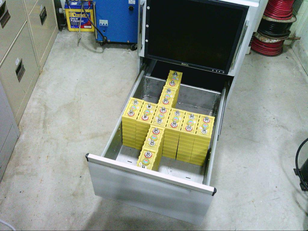

When one cell failed, I just bridged it out, so there was then 3.3 volts less. Then a second cell failed, 6.6 volts less.
With three now gone, the total battery voltage was getting down to the point that the Warpverter was not happy first thing in the mornings under load before sun up, so I just disconnected the whole battery at that point.

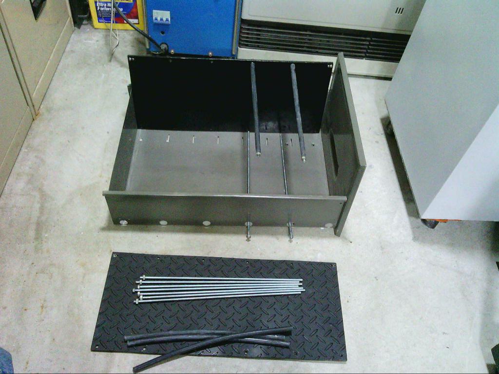

The thirty cells are stacked 6 x 5 between two sheets of 6mm steel plate. The steel plates are held together by twelve lengths of 6mm all thread.
The nuts are just nipped up, finger tight plus one turn.
That all fits perfectly into a standard filing cabinet drawer, with just a few extra mm of space all around. It makes for a very neat installation, highly recommended.
It would also work very well for a 48v system where cells could be paired, giving 15 cell pairs and 50v nominal.
The whole battery cannot really swell, but one cell can, but only very slightly.
And that is what you can see, its only a few mm bulge, but its definitely there on all three cells.
That is a Bloody Clever and neat setup indeed. Brilliant.

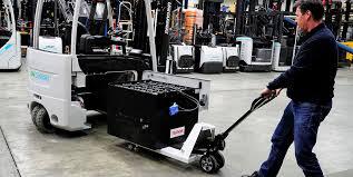

All the the fork lift batteries I have seen are usually constructed as a giant metal box  that can be removed as a complete plug in module with a fork lift, and the larger ones are incredibly heavy. One giant very heavy immovable cube!
On the other hand, large commercial stationary batteries commonly have all the cells lined up in rows on shelving, and cells can be maintained or removed individually. So shifting or installing a whole large battery could be done one cell at a time.
I am sure the battery supplier would supply just bare cells without the heavy metal box, which would just be an expensive and useless addition.

I suppose it depends on the size of the fork lift and the battery.
From what I am told, the basic idea is that a fork lift should be able to be totally thrashed by a minimum wage idiot, for a full eight hour working shift, and be able to fully  recover with an overnight eighteen hour recharge.
If it begins to slow down near knock off time, the minimum wage idiot complains to his supervisor, and management fits a brand new battery.
So a lot of pretty good batteries do get trashed, and might be gold for us solar crazies.
A different scenario is the people that sell second hand fork lifts from companies that go bankrupt.... Nice forklift, very few hours, brand new battery only $xx,xxx.
So the original battery might be down a bit, but again if the forklift sales shark can get more than scrap value, he is very likely to sell it to some gullible solar worthy.
Don't really know a lot about the fork lift industry, but I used to fix a lot of the fork lift electronics, and have designed battery chargers for the industry, and have heard the stories....

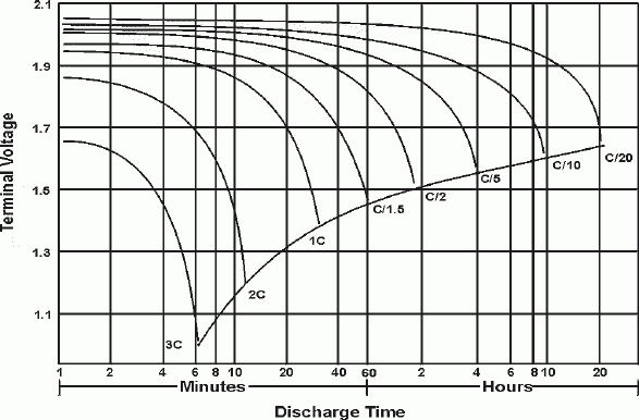

A C5 discharge rate means a 100 amp hour battery discharged at 500 amps over 12 minutes (1/5 of an hour).
No lead acid battery can possibly do that.  If it were possible we would be using lead acid batteries in all our drones !
Standard way of rating general purpose lead acid batteries is over a ten hour discharge rate or C0.1 so a 100 amp hour battery could deliver 10 amps for 10 hours.
Sometimes batteries for special purposes have other ratings such as C0.05 or C0.2 for example.
The ten hour rate would be about right for a fork lift battery that operates over an eight hour shift, and it makes no sense to use anything other than the C0.1 rating.
It would be about right for over night solar storage applications as well.
Reference battery university, which is the holy grail.
https://batteryuniversity.com/index.php/learn/article/how_to_measure_capacity
  Quote  SAE (Society of Automotive Engineers) specifies the capacity of a starter battery by Reserve Capacity (RC). RC reflects the runtime in minutes at a steady discharge of 25A. DIN (Deutsches Institut für Normung) and IEC (International Electrochemical Commission) mark the battery in Ah at a typical discharge of 0.2C-rate (5h rate) for starter batteries. A 60Ah battery would discharge at 12A.
If some battery salesman ever mentioned 20C with relation to a lead acid battery, I would run for my life.
That would suggest a three minute discharge time from a fully charged battery, down to the fully discharged end point, wow , like WOW.

In this case I see the battery is 100 Ah @ the 20 Hour rate and at the 5 hour rate it is 79 Ah. They specify the discharge to 10.50 V. At the 1 Hr Rate it's 58 Ah and down to 9V. ( EEK!)
In the case of the fork Batterys, I would surmise they are at least 20% more capacity at the 20 Hr rate than their 5 Hr rating specified to whatever voltage 80% Discharge is which is probably a lot more than the 42 V it would work out at as these battery's are specced. If the things are Failing at less than 80% capacity @ the 5 hr rate, then they would be pretty damn close to full spec as I always take standard ratings at 20 Hr.
Going as a rough guide, if this battery could do 5A for 20 Hours and is 100Ah, then a 700 Ah 48V fork battery should be able to do around 35A or 1.6 Kw Continuous for 20 Hours. Much more than would be practically used I think and in that 20 hours you are going to have some recharge at least depending on weather if not a full recharge with a solar setup. Going to take a lot to get that down to 80% Dod with any decent solar setup.
One thing with a fork battery, being the size it is one could get Lipo like recharge capacity up to 80% anyway. I suspect the amount of amps they could take even for the end charge would be as much as one could practically pump in with a home setup  and still a good rate ever from a generator.
The C rate terminology may not be precise or as some understand it, but when put in context of the way they are specifying it in hour discharge rate, these fork batteries are pretty impressive to me.

Yes there are many different ways of stating battery capacity, but the "C" rate of discharge has a definite and very specific meaning.
If you want to talk about hold up time, that is also valid, but its the inverse of rate of discharge and a very different thing.
There cannot be multiple interpretations for a basic engineering unit!
Sometimes you will find hold up time referred to as C by sales people that should know better.
You will never find hold up time written as C in any engineering dictionary or reference work written by an engineer.

Is there a term/ specification/ Correct name for what the battery manufacturers are using?
Seems  a number in the battery industry are using this rating so one would hope they have a Correct term for it that differentiates it from the Correct definition of C rate.
Posted: 12:57am 07 Dec 2020
Hold up time is a fairly typical term, especially for something like a UPS.
A laptop computer may have a similar rating for how long you can run the thing off the internal battery before it dies.
Those sorts of ratings are usually given for equipment by the equipment manufacturer.
A battery supplier will (or should) always use C.
The interesting thing about those curves for lead acid is its C/20 or C DIVIDED by 20 which is twenty hours down to the end point of 1.7 volts.  Note its the slowest discharge rate over the longest time. Strictly speaking that is wrong and confusing, it should be written as C0.05
Someone that did not know might see that as C20, which probably explains all the confusion.
A very big difference between 3C or C3 and C/3.

  Quote  The cells have not been thrashed, never charged beyond 3.45v never discharged below 3.10 volts.
I am planning on using some Lifepo4's.
Battle Born recommends floating from 3.35-3.45v
On the A123 datasheet, they recommend 3.45v
It's disappointing that you're getting failures.  Are you actually floating the cells, or just charging to 3.45 and then disconnecting?
Greg
Greg
Posted: 09:34am 19 Dec 2020
What happens when you charge Wistons, the voltage very slowly rises over a few hours.
When it gets to about 3.45v the rate of voltage rise suddenly accelerates.
At 3.5v the voltage is rising at a fantastic rate, it just goes exponential.
Now if you have a very large series string of many cells, one particular cell might reach 3.45v ahead of all the others, and suddenly "take off".
There is really no point in charging to much higher voltage, that I can see.
Suppose it takes three hours to reach 3.45v, ten minutes to hit 3.5v and twelve minutes to hit 3.8v.
How many extra amp hours do you get over the last few minutes ?
Permanent battery damage occurs above 4.0v supposedly.
I don't think I am losing much capacity by terminating charging when the highest voltage cell reaches 3.45v.
I have noticed a very similar effect at the low voltage end of discharge point.
One cell will be lower than the others, and the voltage of that low cell drops like a stone compared to all the others.
Best to have a low voltage disconnect that trips when the lowest cell hits the limit, in my case 3.1v
I charge at full current until the highest voltage cell hits 3.45v, then charging completely terminates.  It stays off until total darkness when solar voltage falls to zero.  That resets the system.  At dawn, charging re commences at full available current.
From what I have read, that is the optimum strategy.
But three cells have still died.
So if I am doing it all wrong, I have no idea what needs to be changed.
