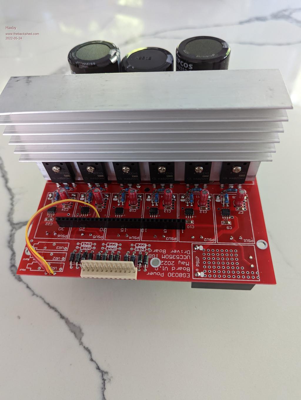

Good stuff Poida.  I've designed a 3 phase 200v IGBT board at my end. I have sent the design away and I'm just waiting for it to be manufactured. I can send you one if it will help you out? It uses UCC5350M gate drivers and is supposed to work with the EG8030 carrier board. It uses my favourite Hi-Link 3w power supplies for gate drive power supply.
Haxby
Joined: 07/07/2008
Posts: 427
Posted: 03:32am 24 May 2022

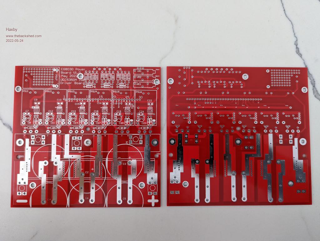

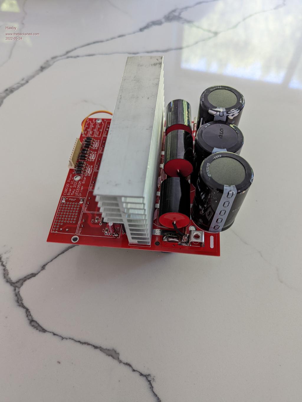

My boards came in. Yay. But I'm waiting for the EG8030 on the egs031 carrier board before I can test it. Might still be a month away. Boo.
My board uses 6x ucc5350m drivers. Very fast (not opto based) 6amp isolated drivers with Miller clamp built in. I have high hopes for them not to cause trouble at 200 to 300v DC.
IGBTs chosen were ikw75n60. 75A at 100c. Hoping will be good for 3 or more killer-wasps at 200v per phase. So 10-12kw or more inverter with only 6 IGBTs. We'll see.
The EGS031 carrier board uses eg3012 MOSFET drivers, which are only good for 100v max. So I'll remove the driver chips and wire the logic straight through to the original pinout. This logic signal then goes directly to one of 6 IGBT drivers.
You can see each of the 6 identical drivers in the pic below. Each driver section has a good old Hi-Link 15v independent power supply, Mounted on the back of the board. A further single 5v Hi-Link power supply powers the egs board and the LV side of the isolated drivers.
I'm thinking of drawing up a carrier board that houses a mega mini 2560 running Poidas 3 phase code, with dead time chips onboard so that the pinout is interchangeable with the EGS031. There was a good discussion under the topic of "dead time insertion" on this awesome forum. This would break away from the unknown vagueness of the EG8030 (non existent English) manual.
Anyway if anyone wants to tinker with 3 phase inverters or speed controllers, PM me and I'll send you a board at cost, or could send you the board file.
Revlac
Joined: 31/12/2016
Posts: 1309
Posted: 01:57pm 24 May 2022
Boards are looking great Haxby, and should make very useful size inverter, well done.
I Might have some questions at a later stage.
Cheers Aaron
Off The Grid
rogerdw
Joined: 22/10/2019
Posts: 957
Posted: 02:19pm 24 May 2022
Agreed, they look awesome Haxby. Can't wait to see the completed project. And great idea hiding the converters under the board.
What sort of transformer/s will you be using.
Cheers,  Roger

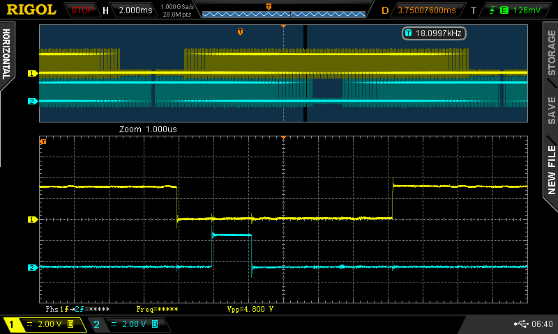

I have a look at the Arduino Due again since it can do separate dead time
for the start and end of a pwm pulse.
This might be important in this design with IGBT and isolated drivers on
both low and high side giving difficult to calculate gate rise times.
And the rise times could well be different, potentially setting up shoot through.
below is a DSO capture showing 1us dead time on the left and 4us on the right.
The Yellow could be the low side drive signal
The Light Blue being the high side signal.
The dead time is able to be set in increments of system clock
which is 84MHz, and can go all the way to 100% of the 20kHz PWM
No need for all that though, we have plenty of control here.

I have never thought of having separately programmable on and off time. That's an interesting feature.
What are the ramifications of a very long dead time and vastly different on/off time?
If I try to use the 3 phase IGBT modules that I have, I'd be inclined to start with a 1.5uS dead time and a low-ish 5khz frequency.
