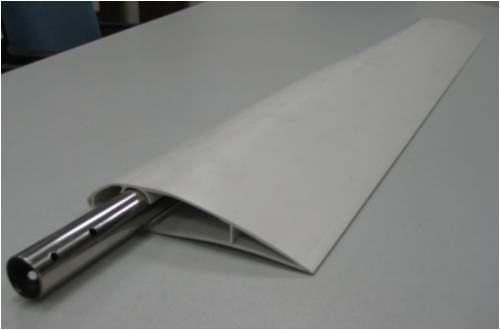

When a 25mm tube is inserted into the blade it is quite tight, I will try to up-load a photo of the blade with the tube inserted tomorrow. The PVC blade “expands” when you push the steel tubing inside, in fact the PVC extrusion could accommodate tubing from about 23mm to 27mm. I will be happy to send you, or anyone who is instead a short sample (5 or 6 inches long) by post, just email me your mailing address wes@oemparts-express.com.

As promised here are a couple of photos of my Extruded PVC Blades with a 25 mm stainless steel tube inserted.

It appears that the tube distorts the airfoil section. How easily does the uPVC blade allow a twist?
A tight fit is OK, but the tube you show seems to be quite a bit larger than designed for. This is evident by the gap between the airfoil skin and the tubing. Any riveting would create a depression in the skin.
The correct tube will be a certain dia, and not necessarily a range from 23mm-27mm.
I would prefer to see a complete blade with a flat mounting surface, rather than a tube arrangement.

Thank you for pointing out that the blade doesn’t quite fit around the tubing, I never noticed that. I am planning to have another test run of extrusion made using a slightly softer grade of PVC which I hope will facilitate the twisting of the blade around the steel tubing. At the same time I will have the extrusion dye changed to make a better fit, as you can see the problem only exist on the top side of the extrusion.

I just got a sample of the blade by mail. I think it has great potential for homebuilders as well as for production. The curvature is just as Glen posted on the previous page. Robust leading edge and thin trailing edge. Sturdy.
There is one small item I had not picked up until I got my hands on the blade. Notice in Glen's photo, there appears to be a line down the length of the blade, on the right side, where the rod is inserted. It's on the sample blade also.
On my blades, that caused noise in normal operating mode. Not a lot, but some. I added more fiberglass to bring it to flush. The noise subsided somewhat. So, I added a .080 inch weed trimmer line at the same point and it made the blades barely audible above the wind.
