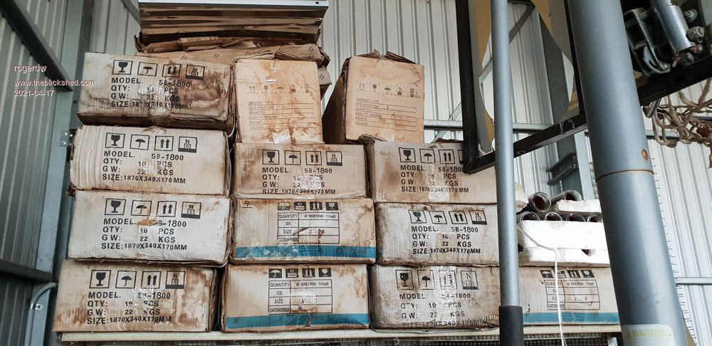

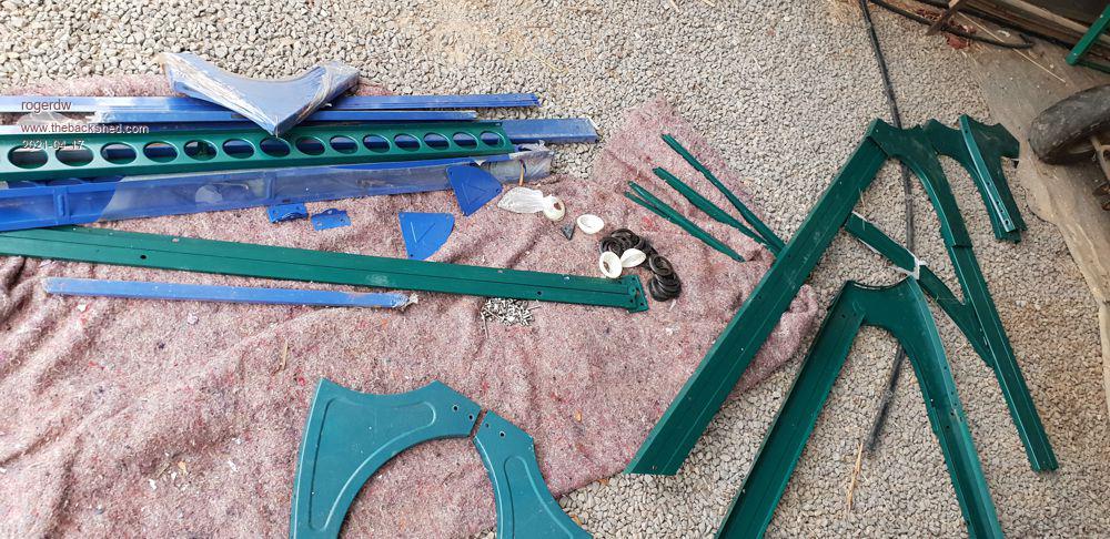

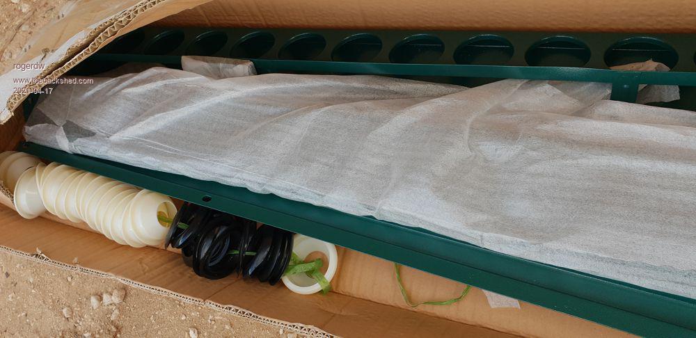

Finally picked up all the tubes and frames today.
10 tubes per box for most and 12 in two boxes. A couple with broken glass sound, so a few fatalities.
But still about 140 tubes.
Were also 4 complete frames. Bit like an Ikea project except no instructions  ...  and a handful of reflector panels that I assume go behind the tubes for a bit of reflective light.
Biggest surprise was that the frames are designed for 18 tubes. Most of the ones I've ever seen were either 10, 20 or 30 tube sets.
I'm especially happy that there's some sets of rubber seals for the top of the tubes and the plastic inserts to protect the nipple on the bottom of the tubes.
And I'm sure I can make use of some of the other bits.
Cheers,  Roger

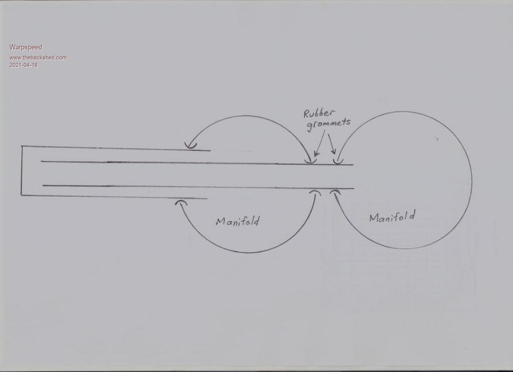

Posted: 02:51am 18 Apr 2021
  Quote  Probably the most difficult task I can see is to have to fit 30 short pieces of tube (to fit the centre pipes into)  ...  onto a 7 or 8 inch thin wall inner metal tube, the inner cold air manifold.
This is how I would do it (not to scale):
The grommets could be home made from standard soft rubber extrusion, cut, and superglued into a circle.
The outer tube would be painted black, and the glass vacuum tubes would slip over the outside of the larger tube.
Edited 2021-04-18 12:54 by Warpspeed
rogerdw
Joined: 22/10/2019
Posts: 957
Posted: 03:14am 18 Apr 2021
That is cool, I like it.
And so much easier too. No welding.
Clearly more than one way to skin a cat.
Actually the more I think about it the more I like it.
Thanks very much Tony.
Cheers,  Roger

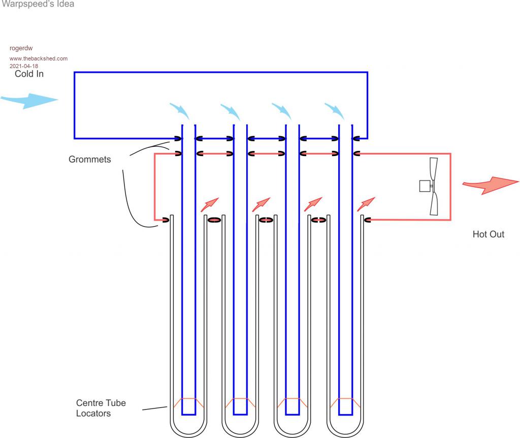

rogerdw
Joined: 22/10/2019
Posts: 957
Posted: 04:28am 18 Apr 2021
So I drew it out to help with my understanding of how it might physically go together and have a few questions.
What are your ideas on the fan  ...  should it push or pull?
And would it matter if the inlet and outlet were at the same end?
And any thoughts on summer time  ...  I guess it'll need to be covered or it will be sitting on the roof getting red hot but not going anywhere.
Edit: Reduced size of graphic.
Edited 2021-04-18 14:32 by rogerdw
Cheers,  Roger
Posted: 05:35am 18 Apr 2021
Your drawing looks a lot better than mine !!
Fans should always push if you have a choice. Fans that pull work in less dense air, especially if its hot, and may cavitate more easily.
Usually a reversed return is the best engineering solution, especially if the manifolds are small or excessively long. But if most of the pressure drop is in the pickup tubes, and the manifolds are a decent flow size, air distribution should be pretty even.
The outside of the pickup tubes should be dull black for max heat absorption.
I would use VHT exhaust pipe paint, its dull black and works to 1,500 Celsius.
Should last for years.
https://www.ebay.com.au/itm/VHT-Flame-Proof-Flat-Black-Header-Exhaust-Paint-SP102/254517145459?epid=244328521&hash=item3b42676f73:g:cLQAAOSwrSpemFKG
Don't know about summer, but beware of thermal expansion. Anything rubber may have a short life, may need to rethink that part.
rogerdw
Joined: 22/10/2019
Posts: 957
Posted: 07:21am 18 Apr 2021
  Warpspeed said  Your drawing looks a lot better than mine !!
Haha, thanks.
Okay that is easily fixed. Done.
  Quote  Usually a reversed return is the best engineering solution, especially if the manifolds are small or excessively long. But if most of the pressure drop is in the pickup tubes, and the manifolds are a decent flow size, air distribution should be pretty even.
Had to google 'reversed return' to work out what it was. Never heard of it before.
So if I understood it correctly, it would still pay to have the inlet one side and outlet on the other  ...  last in, first out.
  Quote  The outside of the pickup tubes should be dull black for max heat absorption.
That I do understand.
  Quote  Don't know about summer, but beware of thermal expansion. Anything rubber may have a short life, may need to rethink that part.
Yes, that may be a bit of problem, though if the concept works well I will be happy to invest more time and effort into it.
A comment you made earlier about not wanting the whole assembly to get too hot and to draw out the heat before it rises too high, has me wondering if I'd get away with fairly thick pvc pipe for my manifolds  ...  at least for my prototype.
Certainly with the new design I should be able to get away with pvc for the cold one  ...  but perhaps even for the hot side.
Depending on how many evac tubes I use, I could use either 6 inch or 8 inch tubing.
Cheers,  Roger
Posted: 07:31am 18 Apr 2021
Sorry about the "reversed return" its a bit of engineering jargon.
But as you know it just means the "to" manifold goes one way, and the "return" manifold reverses back to the starting place, so in and out are at the same end.
Should work fine with inlet and outlet at the same end, providing the manifold is generous, and not too long.
When I was involved with State Government solar thermal projects many years ago, the rule of thumb there with PVC pipework is that anything that runs continuously at 80 Celsius, and the pipework turns into flaccid spaghetti. Sags like a limp noodle.
No problem in winter with the blower going.
In summer there may be issues.
My own gut instinct suggests that the pickup tubes and manifold should be metal.  But beyond the manifold PVC should be quite adequate. Even if you fire it up in summer, the temperature extreme will quickly fall back before the pipework melts. That all assumes sufficiently high airflow.  This will all work a lot better with a very high volume of warm air, rather than a low volume of very hot air.
When it heat soaks in summer with the fan off, temperatures could get extremely high, but not beyond the manifold with the fan off.
Edited 2021-04-18 17:57 by Warpspeed
rogerdw
Joined: 22/10/2019
Posts: 957
Posted: 11:09am 18 Apr 2021
  Warpspeed said  Sorry about the "reversed return" its a bit of engineering jargon.
Mmm  ...  now I'm confused.
I read up on it and was left with the impression that a reversed return was  ...
  Quote  "A reverse return system is a type of closed loop system where the return header is connected to the most hydraulically remote load, as shown in Image 1. Compared to the direct return system in Image 2 where the return header is connected to the load closest to the pump,"
So from that explanation it would be best with in and out at opposite ends? Unless I'm still reading it wrong.
  Quote  When I was involved with State Government solar thermal projects many years ago, the rule of thumb there with PVC pipework is that anything that runs continuously at 80 Celsius, and the pipework turns into flaccid spaghetti. Sags like a limp noodle.
That's very helpful thanks. I have seen 70 degrees C at 5pm on a fairly average day  ...  so if we happened to cop a bright sunny winter's afternoon, it would definitely go much higher. Again, on a fairly mild afternoon with just a bit of sun it's reached 150 C, so no point messing with plastic at all by the looks.
  Quote  My own gut instinct suggests that the pickup tubes and manifold should be metal.  But beyond the manifold PVC should be quite adequate. Even if you fire it up in summer, the temperature extreme will quickly fall back before the pipework melts. That all assumes sufficiently high airflow.  This will all work a lot better with a very high volume of warm air, rather than a low volume of very hot air.
Yep, ok. Looks like metal manifolds and down tubes. Ducting would probably be some insulated flexible aircon ducting.

Here you go, Google image, reverse return.
Lots of pictures:
https://www.google.com/search?q=reverse+return&hl=en&gl=ar&tbm=isch&source=hp&biw=1637&bih=920&ei=sSR8YKStFpeQ4-EPrI-E8Ao&oq=reverse+return&gs_lcp=CgNpbWcQAzICCAAyAggAMgIIADICCAAyAggAMgIIADICCAAyAggAMgIIADICCAA6CAgAELEDEIMBOgUIABCxA1D0HVizPGDyP2gAcAB4AIABwQGIAfUOkgEEMC4xNJgBAKABAaoBC2d3cy13aXotaW1n&sclient=img&ved=0ahUKEwjkyY235IfwAhUXyDgGHawHAa4Q4dUDCAY&uact=5
This is the classic layout, two manifolds and the inlet and outlet are at opposite ends.
Edited 2021-04-18 22:36 by Warpspeed

  Warpspeed said  Here you go, Google image, reverse return.
Lots of pictures:
Thanks Tony, the pictures help. I can be a little slow at times.
Still, better to ask than carry on the wrong way.
And thanks Mike as well.
Cheers,  Roger

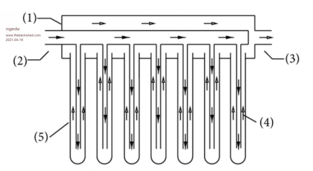

I know I said I am building an air heater and not a water heater  ...  but bear with me.
I came across this image this morning and it looks very familiar.
It comes from a paper  where experiments were made comparing this 'down tube' method with the very basic (no heat tubes) system  ...
...  where the evac tubes just plug in the bottom of a tank full of water and thermocycle as best they can.
Turns out in their conclusion  ...  that with down pipes, they get a whopping 5% extra heat output!!!
Also interesting to see that for an internal diameter of 47mm  ...  the best down tube size turned out to be 32mm
Very close to Tony's suggested 70% diameter  ...  which provides the same cross sectional area in as out.
So the point of bringing this up, is that with air being very similar to water  ...  is it possible that I may not need downpipes for my air heating system either?
I'll paste an extract below to save trying to find it  ...
  Quote  Copyright 2015 Jichun Yang et al. This is an open access article distributed under the Creative Commons Attribution License, which permits unrestricted use, distribution, and reproduction in any medium, provided the original work is properly cited.
A novel all-glass evacuated tube collector manifold header with an inserted tube is proposed in this paper which makes water in all glass evacuated solar collector tube be forced circulated to improve the performance of solar collector.
And a dynamic numerical model was presented for the novel all-glass evacuated tube collector manifold header water heater system.
Also, a test rig was built for model validation and comparison with traditional all-glass evacuated tube collector. The experiment results show that the efficiency of solar water heater with a novel collector manifold header is higher than traditional all-glass evacuated tube collector by about 5% and the heat transfer model of water heater system is valid.
Based on the model, the relationship between the average temperature of water tank and inserted tube diameter (water mass flow) has been studied. The results show that the optimized diameter of inserted tube is 32 mm for the inner glass with the diameter of 47 mm and the water flow mass should be less than 1.6 Kg/s.
Cheers,  Roger
