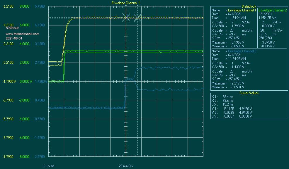

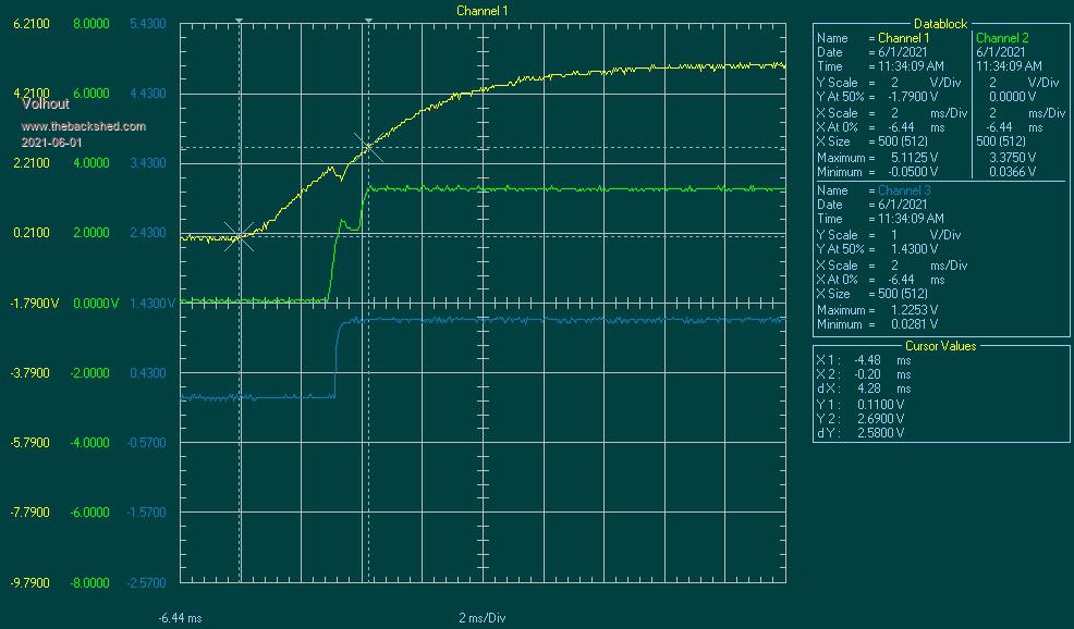

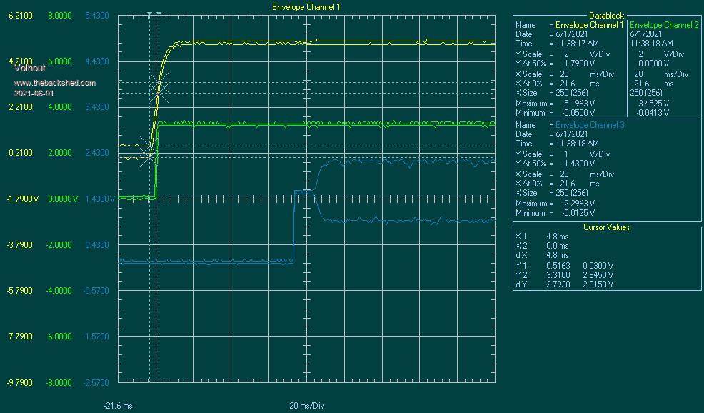

@mixtel90
Power up (yellow=5V, green = 3.3V blue = 1.1V)
Voltages are stable in miliseconds.
The dip in the 5V is caused by the current limitter of the 5V supply (set to 200mA). A capable charger will not product such a voltage dip.
Tested the crystal oscillator startup on both boards 9thye good, and the faulty).
Please note the scope is in envelope mode, otherwise you would see aliasing in the crystal.
Both boards enable the crystal oscillator after 75ms. Then within 12ms the crystal oscillator produces a stable waveform.
The bad unit
The good unit
If it is caused by the crystal oscillator, it is very critical since the boards are not behaving very different.

Nope... I doubt if there's any difference that wouldn't be ordinary component tolerances - and pretty close at that.

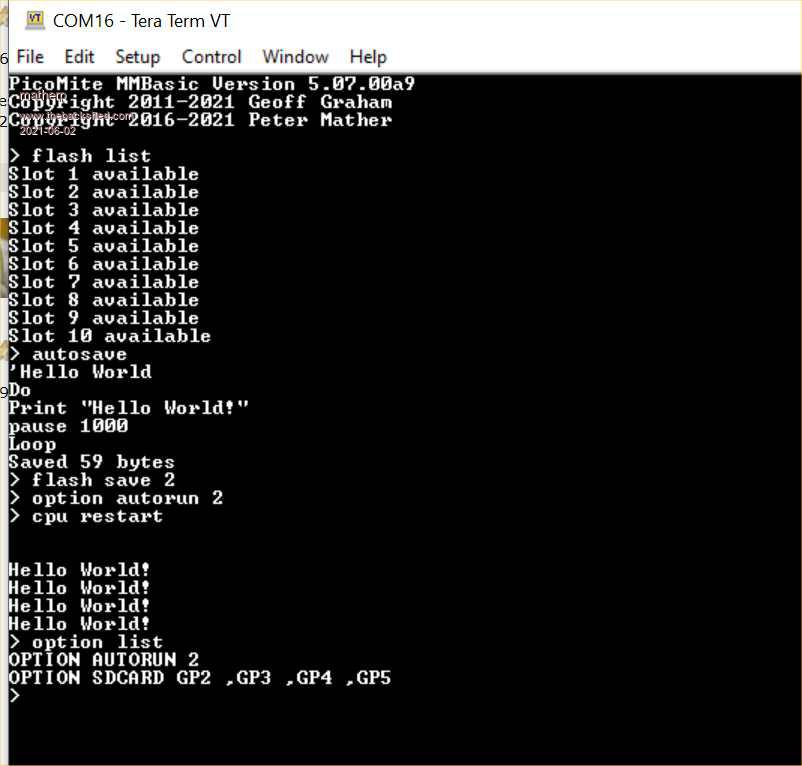

Posts: 8981
Posted: 02:21pm 01 Jun 2021
Just tried
'Hello World
Print "Hello World!"
pause 1000
in flash slot 2
Then OPTION AUTORUN 2
Power cycle or temporarily ground RUN pin
Starts up
Prints header
Prints a space and the prompt.
There is no prog in editor.
OPTION AUTORUN has reset
Same problem if the comment is removed
FLASH LIST is lovely. :)
