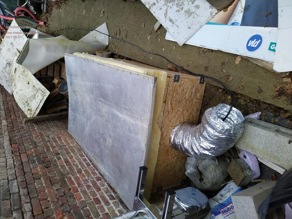

Hi, I need to read up yet, but this is how I did:
I used 2 wooden compartments mechanically decoupled by 22cm thick isolation. I used 20cm in and outlet noise reducing hose used in ventilation systems.
I think I had a 10db reduction, it was quite impressive actually. It's already a "silent" inverter but still loud.
But now I don't hesitate using it during the day, only concern now is the smell when there's not much wind.
The unit Hyundai unit is capable of doing 3.2kva but I'm only using it at 1000va most of the time, max 1.6kVA. So no heat concerns, and probably better for long term use. It has a remote for turning it on or off, so if I'm on the right spot I can start it in the house. With about 7liters I can run around 8h, and let it shut off itself on heavy clouded days. The generator is selfcooling so I did screw the side off for a better fit, but no extra fan was needed for the power level I'm using.

Good day Nick, Well done
It sure is a lot of insulation 22cm, but 10 db noise reduction is also impressive.

That looks pretty efficient Nick, very neat and compact too.
Some of the "silent" portable generators now available are very quiet.
Lack of an electric start for fully automatic operation discouraged me from getting one myself, and it would not be an easy thing to add.
But for the occasional battery recharge during mid winter it should work very well.

I missed your post Nick but that sure looks like it would make anything quiet.
What do they call that sort of Insulation? Not sure I have seen it before.
It looks like the Genny may be able to be heard if you were standing on top of it and listening for it but probably less noise than the outdoor unit on an AC or something like a Pool Pump.
In my mind, I don't need anything to be silent, just quiet enough to be acceptable like other things mentioned.  This certainly looks like it would fit the Bill. I was watching a vid yesterday on people trying to silence their Diesel heaters like I have. I like the sound of work Quietly being done and being able to tell if something is still going. I like the gentle sound of the little heater, I think we all find it quite soothing.
Thanks for the pics. They are very interesting. What you have done is simple and straightforward but easy to see would work really well.
I wasn't aware of the silent Ducting.  I'll ask my mate that does AC about it. Looks to me like the standard Insulated Double layer stuff they have here but maybe it's thicker or Tar lined or something like that?
"Silent" I think is a bit of a stretch with a lot of those Gennys. Funny enough I looked at some Vids of the Hyuandi's  the other day and they seemed quite loud but hard to tell in vids as cameras tend to zoom in on sounds and amp them up to a standard level anyway.  Looks like what you have set up would come as close as one would practically get to silent and there are no mods to the machine itself.
