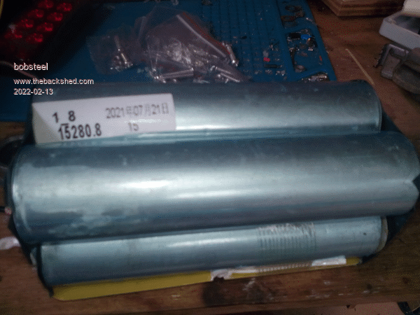

Generally fellas there is a lot of misinformation and bias in this thread . I'm not going to keep going through this rubbish arguing the toss .
What I suggest you do is get hold of say a 50 Ah 12 volt  LFP battery from ebay. Digi Marker I know and trust. about $190 AUD I think  You can afford to try that.
It has cylindrical cells of their own make in it ,I've looked .
So its discharge rate is constant 30 amps so its a bit limited . I use one to power my rideon . The BMS didn't like the larger current out (Its less as the volts don't sag) so I opened it up with a butter knife and shorted across the BMS so it could output the power I needed . Its lifetime will be less but what the heck I like to experiment .
Now when it comes to charging, the internal mower charger works fine and if needed I can put a modern battery charger on it . Check the battery charger is putting out 14 volts . 14.6 is maximum charging voltage.
I use one in my 5K generator too to start it and you can run your shed radio or security lights on it too. Wherever you have used that sh*tty little lead acid you can use it directly to replace it . Even in a small gas car. I run a 4 cylinder Pajero with a 135 Ah LFP without any modifications whatever .A 200Ah model handles my 6.354 6 cylinder diesel starting. A 100 Ah starts my 4 cylinder Fiat tractor.
So give them a try

bob.steel
Joined: 27/02/2020
Posts: 188
Posted: 06:45am 14 Feb 2022
  Warpspeed said  If one of those smart fully sealed 12v Lithium bricks does spit the dummy with a dead cell, you have to replace all four cells.
If you buy individual cells, at least you get to replace only what is actually dead.
UMM,Ummm, NO!  thats totally wrong again . The top is sealed with rtv silicon . Working carefully with a butter knife and a chisel you can lever the top off gently and get at it all . When finished stick it down the same way.
Now its very interesting you say this because EVERY set of cells I have bought , I have bought at least on extra to pull apart for my facebook page members to see. So they don't have to do it and they know whats in them .
As with all batteries with cells in them, each cell can be separated out and charged or discharged individually as you wish . The BMS is always on the negative line and can be disconnected and replaced if you want to .
One problem has developed with some dropins, generally the foil pouch cell types . One cell can get to top voltage first and cut the entire battery. Then it can't be discharged because its not connected . It can't be charged because its disconnected ,so you sit there for as long as it takes with no power until the self discharge brings that cell back into spec. Voltage drop is very fast up at the top charge knee so its usually pretty quick . Its easy to overcome by putting in a direct negative connection point between the terminals.

Edit got me again . Here is the Pro Power I first opened up. I had the zero voltage cel out for the dendrite treatment.
Can't work out what the admin is doing with these pictures . Ive never seen so many ridiculous restrictions Admin . Its time you took another look at this . Everyone wants to edit there posts so they are coherent  and errors are removed . You don't allow it?
This silly little picture that comes up here ,you cant see a thing . Pointless posting it!
