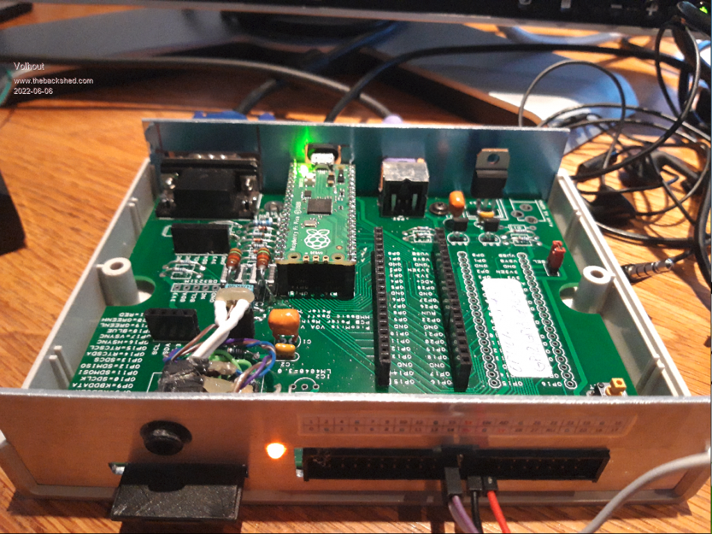

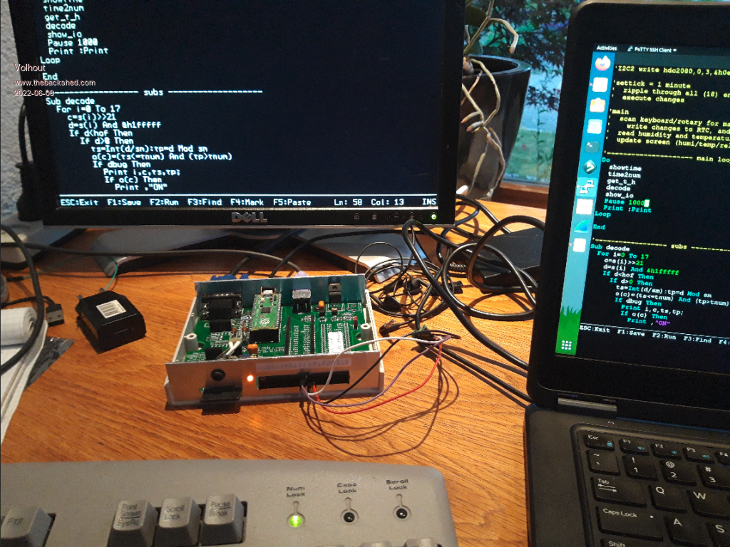

Posted: 08:41pm 05 Jun 2022
Finally the box arrived and the bare pico board is mounted. My dev. setup...
close up (SSTV interface removed from shadow pico socket)
The linear regulator seems reverse, but I only had a LM1086-3V3 in my toolbox.
I did separate the VGA signals from the shadow sockets and the 40pin header to improve video quality.
The audio filter is an idea from MIXTEL90, using inductors, to get better frequency response and 44kHz reduction.
This week my RTC will arrive....
Edited 2022-06-06 06:49 by Volhout

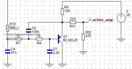

Posts: 6101
Posted: 09:40am 13 Jun 2022
@ Peter,
This is the alternative for the inductor based filter.
Resistor R22 is only needed to limit the output level to the level similar to the level that your 1.4 board outputs. For headphones it is not needed. Most audio amplifiers may not need it. The transistor is not critical, it can be any PNP, as long as the pinout is right. BC558, BC327 -or- the mirrored pinout 2N3906/2N2907.
It's only drawback is 5V. What I like is that it can also be fully SMT.
Harm
Edited 2022-06-13 19:48 by Volhout
Posts: 9123
Posted: 11:12am 13 Jun 2022
That configuration still gives me the creeps when you feed it from a device that can't stand more than 3.6V on its pins according to spec. :(
If the pin is OFF and the 470R isn't fitted (or headphones connected) there is about 4.3V on it via the forward-biased emitter-base diode, albeit a bit current limited by R7, R8, R9 & R10. With the 470R connected that drops to about 3.75V. That might be survivable, but it's still higher than 3V3+Vf of a schottky diode.

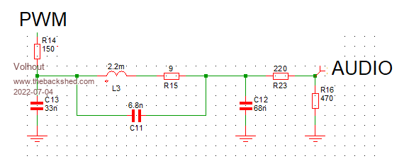

Posts: 6101
Posted: 01:18pm 04 Jul 2022
@Peter,
For the new revision of the VGA demo board, I would like to suggest following.
1/ Video
On MY monitor the picture quality is not degrading in any way if I simplify the RGB interface to:
GP21 -------- 270 ohm ---------- R
GP20 -------- 390 ohm ---+------ G
GP19 -------- 820 ohm ---+
GP18 -------- 270 ohm ---------- B
No diodes, not potmeter

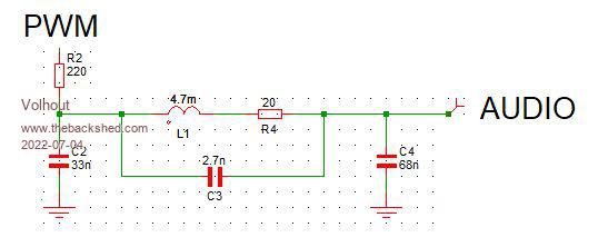

2/ Audio
If you want the widest audio spectrum the previously discussed filter is what I can propose (up to 19kHz -3dB). The 150 ohm is perfectly OK, even 100 ohm works as a charm (no distortion)..But 100 ohm degrades the spectrum.
However....

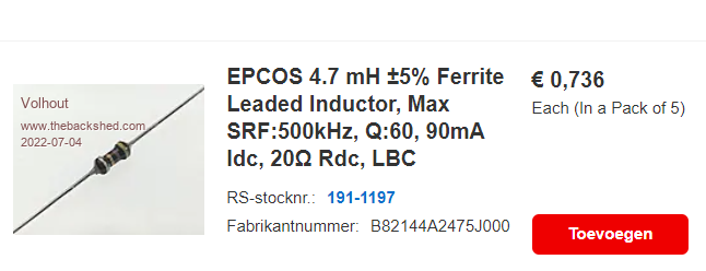

My personal preference is to limit the bandwidth to 12kHz. Honestly, my hearing is not the best in the world, I am anyway deaf above 15kHz. With this filter you do not need to terminate, and the 44kHz rejection is around 10dB better even. Because of the lower cut-off you also suffer less from mirror images. The circuit can be the same as above, only values differ.
Additional benefit: it does not need the 220 ohm and 470 ohm terminating it. The frequency spectrum remains very acceptable over loads.
The inductor designed for (Mick prefers R&S because lower shippig cost, maybe you do to (in UK))

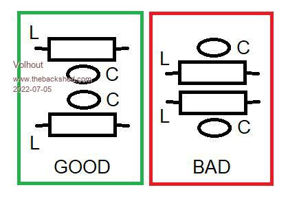

Posts: 6101
Posted: 02:01pm 04 Jul 2022
Hi Mick, Peter,
If you make a layout of the board, please take care that these inductors are not too close to each other. They are not magnetically shielded, and couple magnetic field when right adjacent in the layout. Maybe by placement of components between them you can prevent this.

Posted: 09:34am 06 Jul 2022
Hi Volhout,
Just to be sure, the resistor R4 (20 Ohms)in the above circuit diagram, is that an actual resistor, or is it showing the resistance of the inductor, so not a separate component?
Thanks Kevin.
Posts: 9123
Posted: 10:22am 06 Jul 2022
It's the resistance of the inductor, not a separate one. It's needed for the simulation.
Posts: 6101
Posted: 10:27am 06 Jul 2022
@Kevin,
As Mick said, it is the resistance of the thin copper wire that is used to wind the inductor. It is only needed for the simulation. I was to lazy to remove the part from the picture. Sorry.

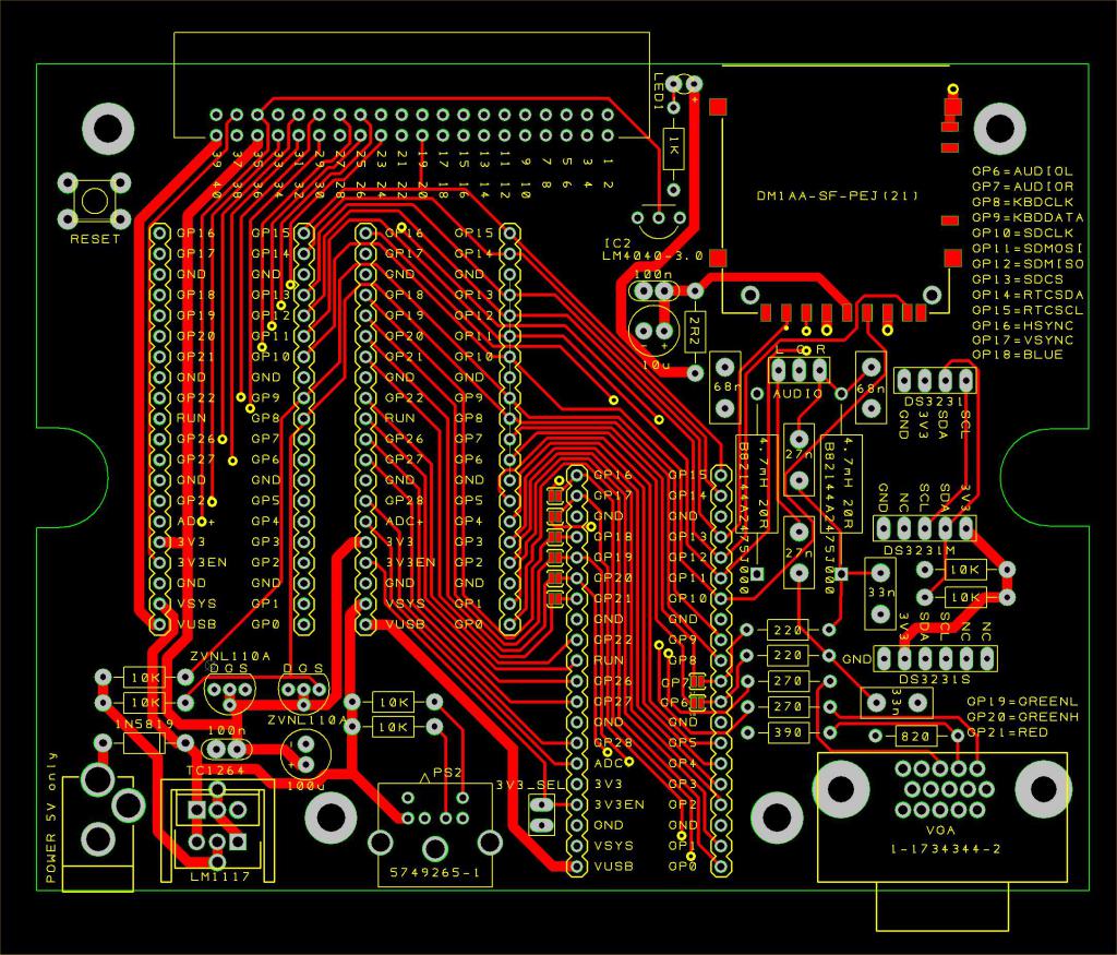

Posts: 11836
Posted: 11:50am 18 Jul 2022

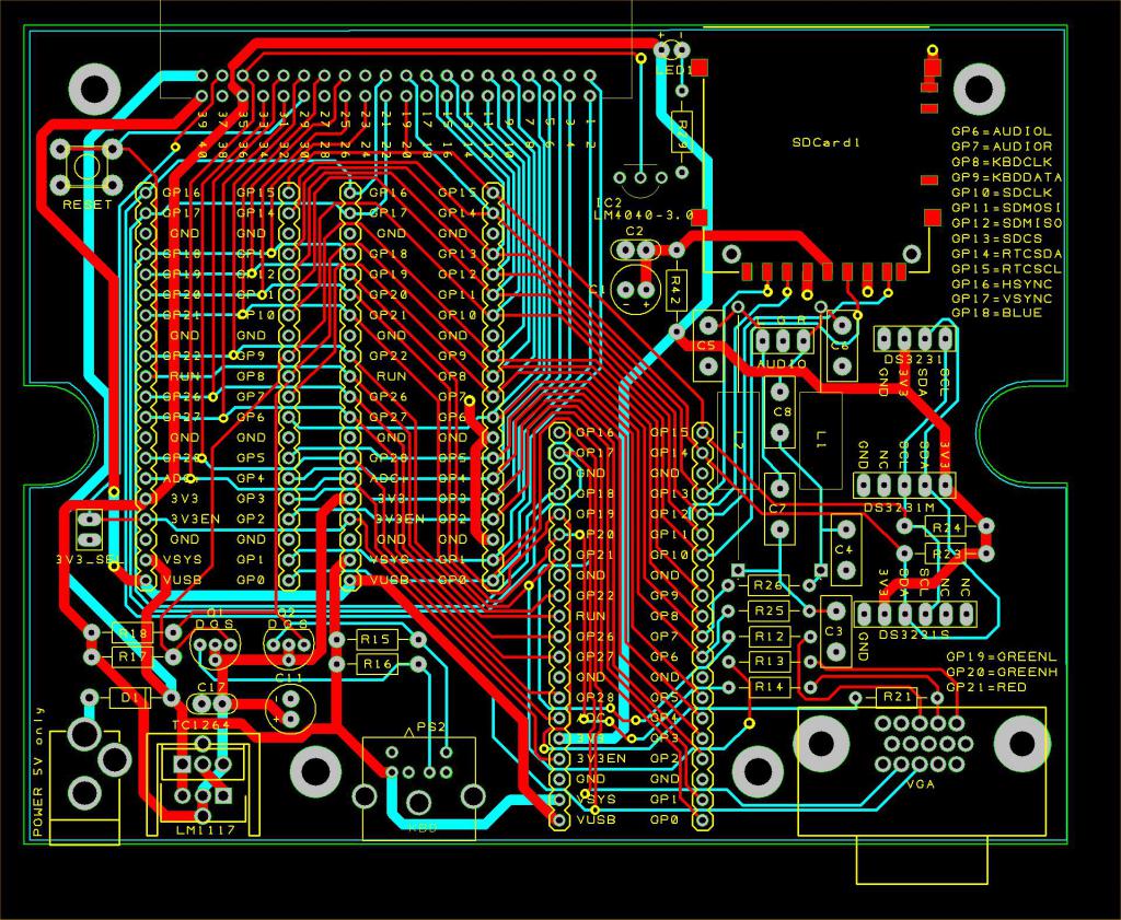

New version 1.6 of the PCB which I will get made and then release the gerbers and design files.
Changes:
Option for LM1117 regulator
SDcard swapped for the "standard" Maximite version (same as Geoff's PicoMiteVGA PCB)
Revised audio filter as per Volhout (thanks)
Revised VGA I/F using just 4 resistors and no diodes
40 way connector now wired correctly (pins 21-40 were wrong)
Pic omits the GND plane so lots of GND wires appear unconnected
Schematic

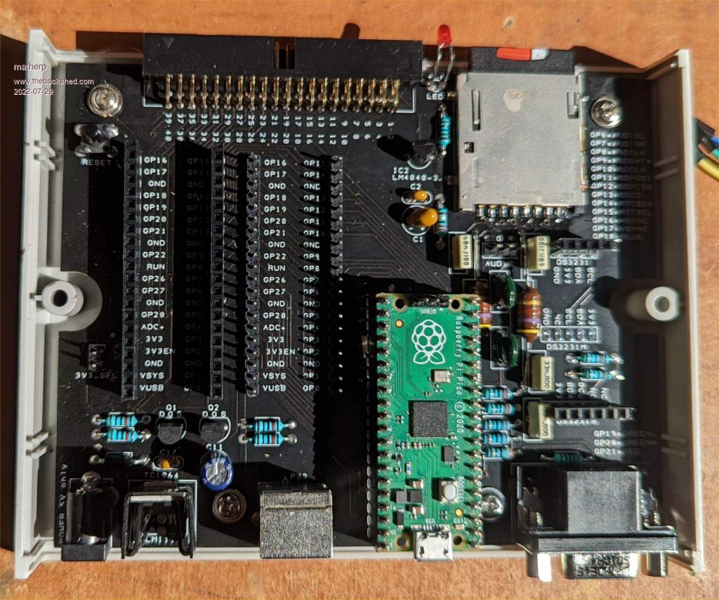

Posts: 11836
Posted: 10:04am 29 Jul 2022
Here is the "final" version of the PCB. Cost GBP7.42 for 5 boards from JLC (+postage). To get boards made just drop the 1.7 zip onto the web page at JLC - as easy as that.
No BOM as all the non standard components are labelled on the silkscreen together with the values for the resistors and capacitors
Changes:
By default the VGA and audio pins are not connected to the two Pico additional footprints or the edge connector. Connection can be made using a solder blob on the shorting links
Traces re-routed to improve signal quality for audio and VGA
Schematic
VGAMite - Project.pdf
Gerbers
VGAMite V1.7.zip
Design files
VGAMite.zip
Edited 2022-07-29 20:08 by matherp
