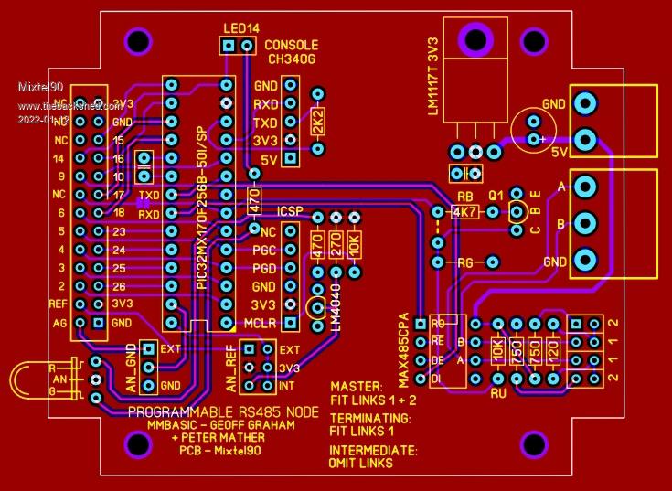

@mixtel90,
I did not investigate the MX170 datasheet, but when there is a chance of connecting the modbus UART RTS pin to a GPIO, then use that GPIO for the DE signal. In that case the UART itself controls the RS485 data direction and not software.
The signal needs an inverter in that case (simple 2N7002 and a pullup resistor will do, fast enough).

@Volhout and mixtel90, The DE pin is pin 7. If DE is not specified in the COMSPEC then it can be toggled under program control so that it does not need inverting.
Works for me.
  Quote  SUB TxMsg
 pin(DE) =
1
 TXD$ = TXD$ + CRC16$(TXD$)
PRINT #1, TXD$;
DO: LOOP UNTIL LOF(#1) = 256: PAUSE 20' Wait til message sent
 pin(DE) = 0
END SUB

  Turbo46 said  @Volhout and mixtel90, The DE pin is pin 7. If DE is not specified in the COMSPEC then it can be toggled under program control so that it does not need inverting.
Works for me.
  Quote  SUB TxMsg
 pin(DE) =
1
PRINT #1, TXD$;
 pin(DE) = 0
END SUB
Bill
Hi Bill,
It is fine that it works for you, but this code forces a turn around time of up to 20ms (where at 2ms is standard at 19200 baud, 3.5ms at 9600 baud). May very well be this works in practice, but that is why I proposed to use the RTS pin. Then the turn around time is minimal, and not determined by some fixed number.
Turbo46
Joined: 24/12/2017
Posts: 1694
Posted: 10:23am 11 Jan 2022
Two points
1. The 20ms can't be changed? Is it likely that a new message will be sent by the Master in that time? I don't think so. The Master will have a time out period much greater than 20mS surely. The delay does not affect the time it takes the slave to respond.
2. The pause is no longer needed anyway because Geoff has since fixed it so the LOF is now true when the final character has been sent.
Do you really see it as a deal breaker?
Bill
Posts: 9134
Posted: 12:13pm 11 Jan 2022
I've put the DE inverter back now as it costs virtually nothing. I like that system, it's elegant and neatly supported in MMBasic. :) I've added suitable pads/links so it's also optional.

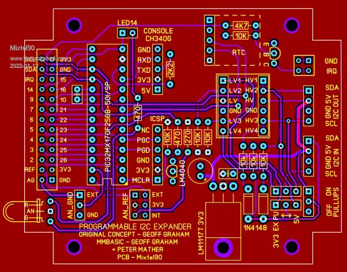

Posts: 9134
Posted: 08:02pm 11 Jan 2022
Big day. :)
Piccies and Gerbers.
Micromite I2C expander.zip
Micromite 485 node.zip

Turbo46
Joined: 24/12/2017
Posts: 1694
Posted: 11:31pm 11 Jan 2022
Thanks Mick, They look good
Is there any chance that you can post a rear view and circuit please. I just may have to get some.

Turbo46
Joined: 24/12/2017
Posts: 1694
Posted: 01:11am 12 Jan 2022
  Quote  Does the RS485 driver have RX/TX LEDs so can see activity?
+1
  Quote  is there any cost advantage to using discrete RS485 components
I'm interested as to what you mean by 'discrete RS485 components'?

  Quote  Geoff has since fixed it so the LOF is now true when the final character has been sent
Not true, he has fixed it so that the CLOSE #n command will wait for the last character to be sent before actually closing. A PAUSE is still required for the DE pin in my program. The pause time could be calculated by using the baud rate as I have done in a later version of my Slave program.
I don't know how the DE pin when specified in the COMSPEC works.
See
Bill
Posts: 9134
Posted: 07:58am 12 Jan 2022
Updated circuit diagrams to follow. I'm one of the naughty ones because I do the PCB first then do the schematic from that...  ;)
There are no specific TX/RX LEDs. There is a single bi-colour red/green LED. Normally red is "power on" and Green is via a link LED14 to pin 14 so it is under user control. You could remove the ground end of the resistor for the red led and connect it to a pin to put that under user control too if you so wished.
There is no RS485 module. It does use a RS484 transceiver chip, but so would a module. The I2C version uses a level shifter module, is that causing confusion?
I've no idea about how DE works either. However, I assume that, as it's inverted, it might be under hardware control as Geoff could have corrected it in firmware otherwise.
@Bill
Which board would you like a rear view of?
I've been considering a "high power" IO box. Same IO connector but linked by a ribbon cable. My idea is that you could have two or three stacked on top of one another, perhaps a couple of relays in one, 4 opto-isolated inputs in another. You get the idea. Links would decide on which pin they were allocated to, perhaps with a choice of 3 for each type of box.
Please note:
I've referred to these modules as an IO Extender and a RS485 Node.
The I2C Extender is intended to be, literally, IO extension to any MMBasic platform using  I2C. That's why the modules loop through and are short range. It can also run as a stand-alone Micromite by changing the firmware.
The RS485 Node can be a RS485 master or slave. You could link, say, three together and use switches on the master inputs to control outputs on the slaves. The terminating resistors let you set the system up appropriately. The range is *far* greater using these, but at the moment no MMBasic platforms are specifically designed to work with RS485. (Yes, I'm thinking about it...  :) )
Edited 2022-01-12 18:20 by Mixtel90
Turbo46
Joined: 24/12/2017
Posts: 1694
Posted: 09:05am 12 Jan 2022
@Mick,
I'm mainly interested in the RS485 unit. I just would like to see the schematic and both front and rear views to verify the design (no offence meant). That was part of my life in my working days. I think it suits my Slave program, or the program can be mad to suit it.
I suspect you're right about the DE pin.
I respect your decision to make whatever you want for I/O interface board(s). If I can justify the cost of buying a copy of SL6 to myself, then maybe I can have a go at it.
Bill
Posts: 9134
Posted: 09:14am 12 Jan 2022
I must admit, I wasn't sure about getting SL6. You have to bear in mind that it isn't a full featured PCB design package - and you aren't paying for that. For simple boards it seems to be fine, and the test probe facility is excellent for finding problems in your design. The learning curve is shallower than a full package and, IMHO, more suitable to occasional use where you don't have to keep re-learning stuff whenever you come to use it! Try the demo - it won't save or do anything useful, but it gives you an idea of the facilities and what the help file is like.
I'll sort out schematics and rear views. Probably later today.

Posts: 9134
Posted: 10:20am 12 Jan 2022
The circuit of the RS485 version is pretty simple really. COM1 on the Micromite is connected directly to the MAX485 chip. Pin 7 (DE) is connected to both /RE and DE on the MAX485 via an inverting transistor as pin 7 is normally high, going low during transmit. (Thinks... I should perhaps have included a highish value resistor to turn the transistor on so that the system is in RX mode if the Micromite IO isn't initialised.)
