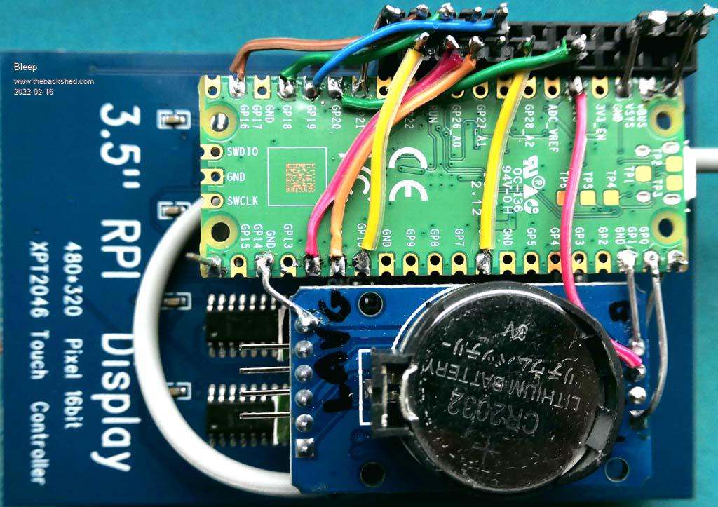

Posted: 11:59am 16 Feb 2022
Finished 3.5" Raspberry Pi touch display, attached to a Pico, & RTC, in a perspex case that came with the display, Display on Ebay.
Many thanks to Peter for PicoMite and pointing me in the correct direction for connecting the diplay and the fact that even though it was a ILI9486, the PicoMite  ILI9481 driver worked fine, which it does. :-)  Because I got the back screen brightness working I have also done automatic brightness, depending on time of year and time of day, it can be overriden with the touch screen brightness control.
Thanks to all involved,
Regards, Kevin.

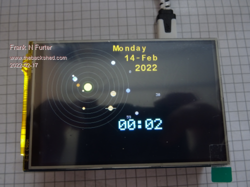

Posted: 11:47am 17 Feb 2022
@Bleep:
Thank you very much for your phantastic project:
Currently still without RTC...
@homa
...and thanks for pointing out the beautiful display! (https://www.thebackshed.com/forum/ViewTopic.php?FID=16&TID=14512)
Frank

Posted: 03:12pm 17 Feb 2022
Impressive project! Cool!
Bleep
Joined: 09/01/2022
Posts: 820
Posted: 08:11pm 17 Feb 2022
Hi Frank, Sorry, I haven't updated the original post with the latest, which will fill a 480*320 screen, See below.
Regards Kevin.
