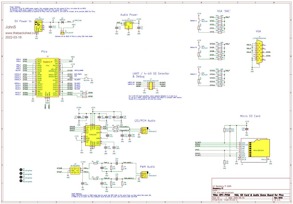

The problem,Tom, is that the VGA pins on that board aren't usable for anything else as they'll have the VGA resistor networks on them. They are useless as PicoMite VGA pins because you couldn't get enough free memory to support them. Likewise, the I2S audio pins are already connected to a non-supported device. It's probably pretty good if you want to write games & demos in C, but not when you need a BASIC interpreter on board.

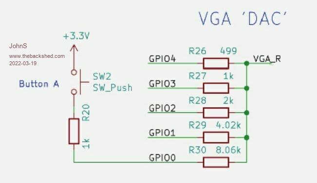

I know the result will have no GPIO, the user-base in this thought experiment is people who just want to dick about with a modern boot to BASIC retro-computer without any thought of additional hardware interfacing.
I naively assumed there would be a firmware implementable algorithm by which the 4 bits of data that the VGA PicoMite currently uses to drive the VGA (R, GL, GH, B) could be mapped to the 12 bits of data that this board requires (R1-4, G1-4, B1-4), e.g something like:
 R1 = R
 R2 = R
 R3 = R
 R4 = R
 G1 = GL
 G2 = GL
 G3 = GH
 G4 = GH
 B1 = B
 B2 = B
 B3 = B
 B4 = B
Edited 2022-03-18 23:43 by thwill

My feeling is that wiring along those lines "probably" (software man's term) would work.
You'd have to not connect various other things as the PicoMite VGA / the board wouldn't be happy.  I've spent no time trying to figure out which if any these are.
So you'd end with a number of flying leads or similar, at least unless someone re-does the PicoMite firmware (if anyone does).  Even then you'd lose most (all?) of the I/O that makes MMBasic of interest, I suspect.

Ah, this I couldn't guess at. It would probably depend on both the resistor networks and the firmware. I've not looked for the circuit of the board.
Posts: 4378
Posted: 02:42pm 18 Mar 2022
  Mixtel90 said  Ah, this I couldn't guess at. It would probably depend on both the resistor networks and the firmware. I've not looked for the circuit of the board.
By way of example:
The rest will be in the hardware design doc I hope.
Section 3.2 is VGA Video
Section 3 is the whole VGA etc board.
Edited 2022-03-19 00:45 by JohnS
Posts: 4378
Posted: 02:55pm 18 Mar 2022
Aha, here's the schematic for the board. I hope I didn't mangle it...
Edited 2022-03-19 00:55 by JohnS
Posts: 9134
Posted: 03:23pm 18 Mar 2022
The existing PicoMite VGA firmware won't run on that board no matter what you do. It's permanently set to use different pins. Even if you could change the pins used (by changing the firmware) you'd have to either drive multiple pins at the same time,as Tom suggested, or set the 11 unused ones to tristate. You've lost them anyway because they are tied to the VGA otput. The I2S audio is connected to the ADC pins so you've lost the ADC too. It's not a good general purpose board at all.
