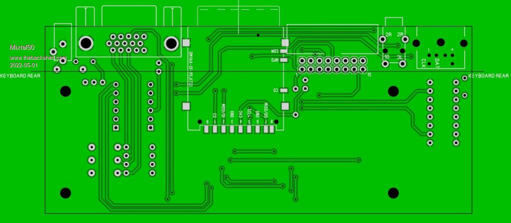

Posts: 8981
Posted: 10:12am 29 Apr 2022
Here's an idea.
You are looking up from the bottom of the keyboard. The PS/2, VGA, power & audio sockets are on the top (the other side) of the pcb. The PicoMite and SD card are surface monted on the bottom (facing you). The pcb is fastened to the bottom of the keyboard using the fixing holes, with the sockets projecting from the back. That adds about 19mm maximum to the back of the keyboard. The PS/2 skt could be left off and the wire cut and soldered on, but I think plugging it in is better. You can simply remove the PCB and just leave 4 little holes. You need 8mm height 40mm in from the back of the keyboard.
Incidentally, the projection of the actual PCB behind the keyboard is only 13mm. The 19mm dimension includes the full depth of the VGA socket.
Edited 2022-04-30 03:52 by Mixtel90

Posts: 8981
Posted: 07:13pm 29 Apr 2022
The point of this design is that it's not intended to go into a keyboard, it goes under it. :) You could screw it to the bottom (using something like #4 x 6mm self tappers with nylon spacer washers) or even use sticky pads to hold it. When you get fed up of it you can just take it off again.

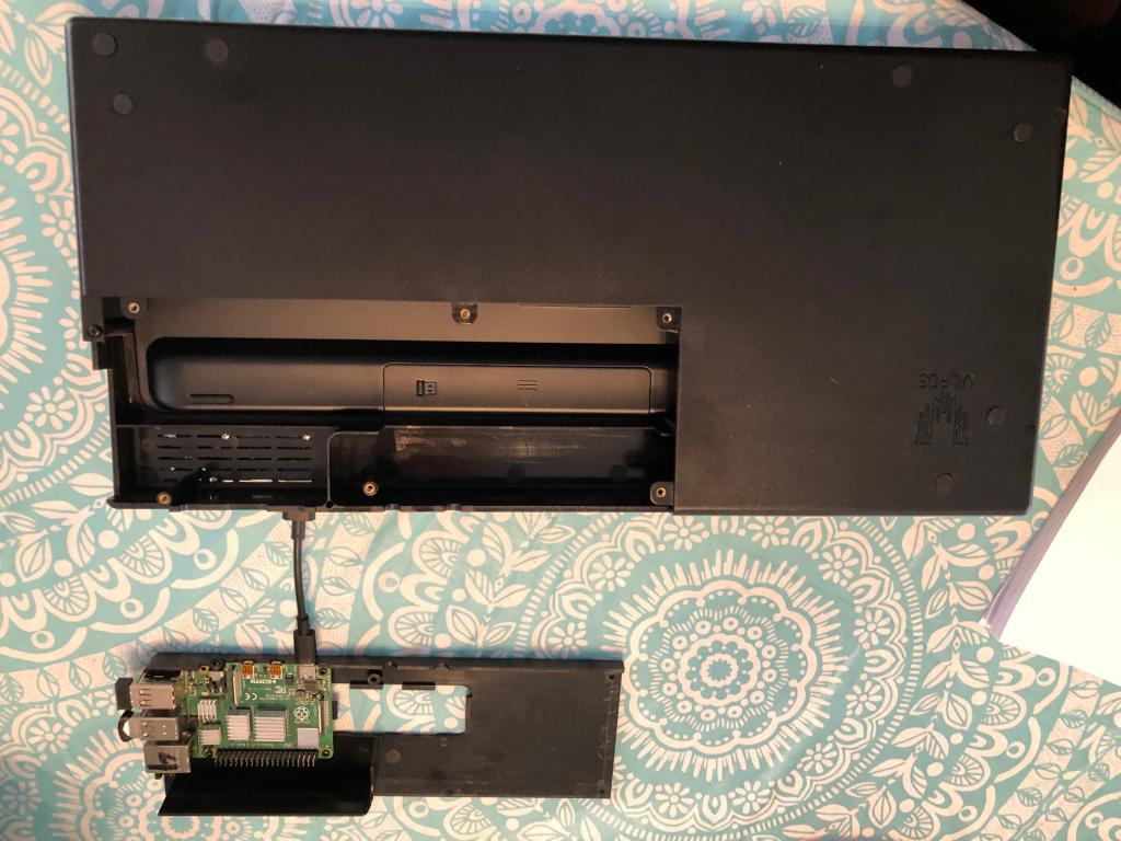

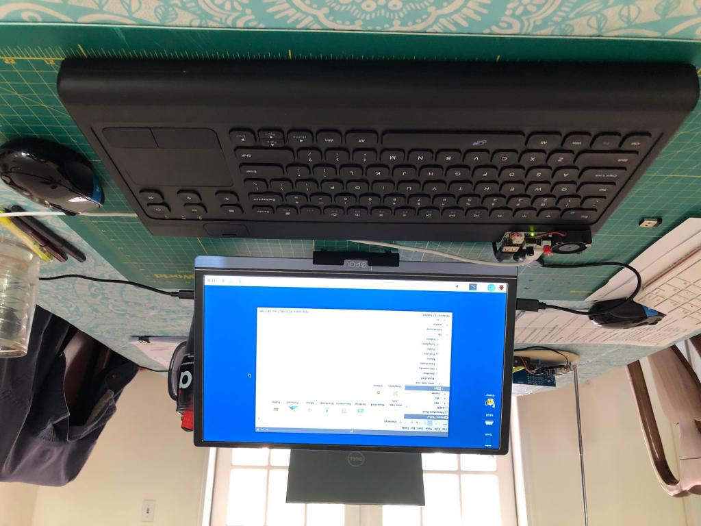

cdeagle
Joined: 22/06/2014
Posts: 269
Posted: 07:37pm 29 Apr 2022
Here are two pictures of the Vilros keyboard with a Raspberry PI 4 and a fan/switch on the top. Bought it for $20 on sale. Lots of room. Switch for turning the KB on and off.
Posts: 8981
Posted: 07:52pm 29 Apr 2022
My problem, when I was looking at a design, is that you have no idea what the keyboard is going to be like. You were lucky finding one with so much space in it. :) Daniel has made a lovely little board system that may well tuck away inside some keyboards. It certainly wouldn't in my PS/2 keyboard. So, my approach doesn't even involve opening the keyboard up (unless you are checking for a safe place to drill holes). It's not as pretty as a truly integrated system, but I think it's probably a good compromise - especially if some way of making a "lid" to cover the 13mm projection could be sorted out. It also gave me some entertainment creating the footprint for surface mounting a PicoMite. :)

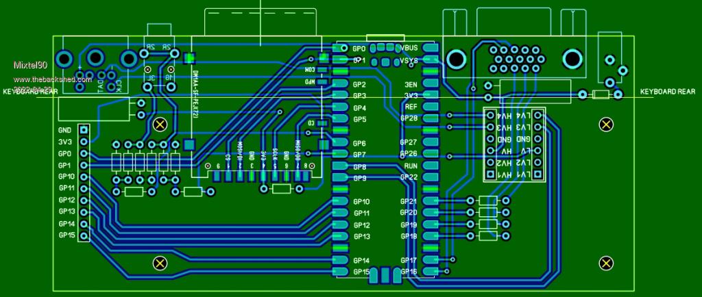

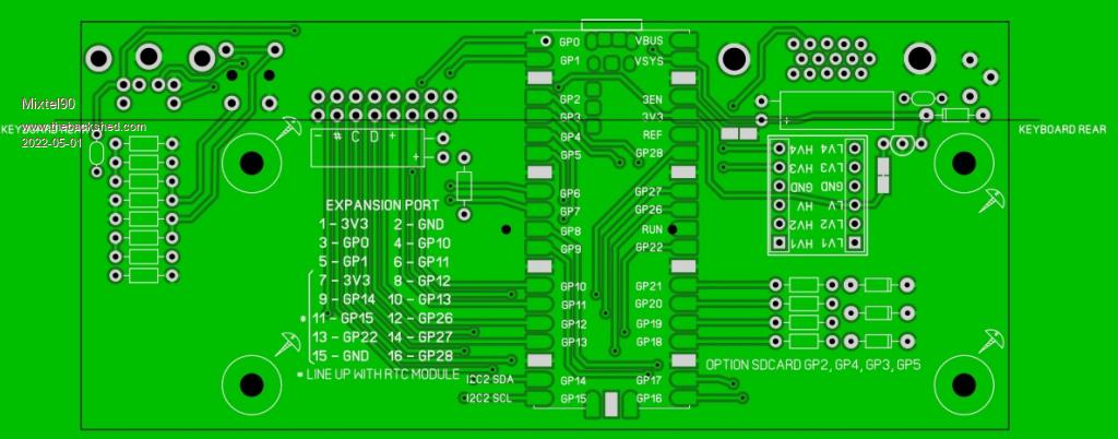

Posts: 8981
Posted: 06:04pm 30 Apr 2022
Had a go at making it more compact. Short of getting a steam iron on it I doubt if it will go much further. :) As a surface mounted Pico will be at least 1.5mm thick there's not a lot to gain by changing to SMD resistors and they are more fiddly.
The bottom (components / against the table) side:
The side that goes against the bottom of the keyboard:
The expansion port (a 2x8 rear-facing box header) will take one of the little RTC modules plugged into pins 7,9,11,13 & 15 (top row, pointing upwards). Unfortunately it covers GP22, but that's hard luck. Unplugging it gives you that back, together with GP14 and GP15. I used a box header so that a 16-way ribbon could be used.
The default is to use a MCP linear regulator, but this can be left off and solder blob links changed to enable the SMPS.
Audio output is line level only.
Unfortunately it's too big for JLCPCB's special $2 offer. :(
Posts: 5999
Posted: 07:30pm 30 Apr 2022
Mick,
Nice, sign me up for one!
Check if there is solder resist on all pico pads that are not ground.
Posts: 8981
Posted: 09:11pm 30 Apr 2022
I might change the audio filter for your 2-stage "green" curve. It doesn't need much messing about to do.
You were right about the solder resist. That would have made it fun to build. lol I've moved the pin names outside the pads too.
