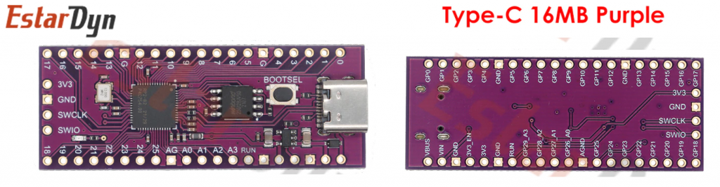

One of these on the way - end of Jan.
Winbond 25Q128 no logo on the RP chip, just RP2-82. Cheap enough to have a punt.
Appears to have linear 3V3 reg.

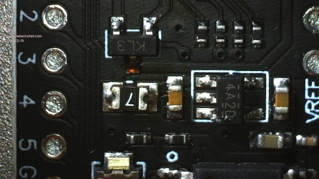

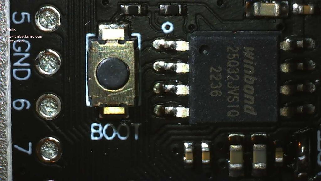

The ones I bought and successfully use do also look like there would be no Logo on the RP2040 chip on the seller's site. The arrived modules do however have the Raspberry Logos.
https://www.thebackshed.com/forum/ViewTopic.php?TID=15398&P=2#195152
Flash memory:
I suppose one of these is the regulator:
Latest order was 3.30EUR incl shipment and VAT (4MB version). Still to come 16MB version at 3.63EUR incl shipment and VAT.
Up to now all of the 4MB modules have functioned as expected for PicoMite.

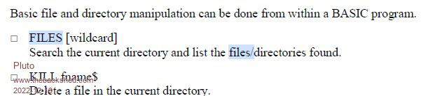

A stupid question again
FILES
FILES "A:"
FILES "A:/"
Are these not supposed to be in a program?
It results in: "Error : Invalid in a program"
Posts: 11668
Posted: 01:32pm 19 Dec 2022
  Quote  Are these not supposed to be in a program?
No: they clear the variable memory for buffer space to do the sorts so not possible
Pluto
Joined: 09/06/2017
Location: Finland
Posts: 411
Posted: 01:44pm 19 Dec 2022
Thanks Peter!
Could maybe be mentioned in the manual.
Page 38 in the PicoMite User Manual says:

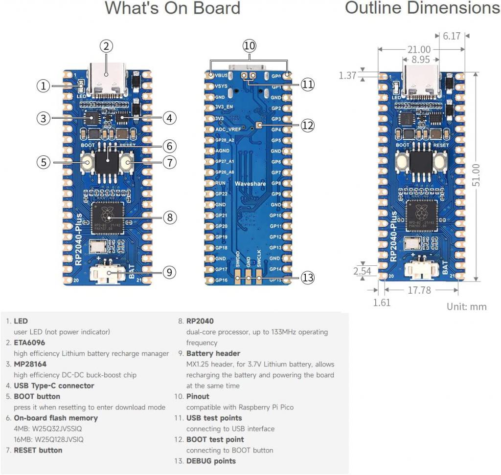

Season's Greetings;
Very excited for the files system changes.
I purchased this Waveshare RP2040-Plus with 16mb from Amazon.ca.
I don't expect it till the end of January either as it ships from China. Considering the state of the country it may be delayed.
Not much risk here as it's from Amazon, $24.89 CAD with pre-soldered headers, free shipping.
Here's wishing you all and your loved ones the season's best!
