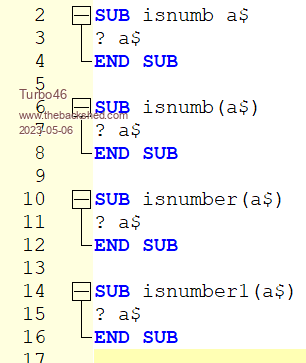

Hi Jim, It seems like the intention is to colour code subs and function names with the default colour brown (or similar). It doesn't seem to work all of the time.
sub isnumb a$
? a$
end sub
doesn't turn isnumb brown but:
sub isnumber a$
? a$
end sub
does
The same with functions, it seems to me that the name needs to be eight characters long more or less doesn't do it.
Bill

What happens with
sub isnumb(a$)
? a$
end sub

Went back to test and now it's not colour coding it at all?
But here it is
I'm confused
Bill

Save the program.
After the save, all highlighting is correct..

Thanks Volhout, when I reloaded it the colour coding was there but earlier it changed to brown as I typed the eight character and then back to black as I deleted the last character. Other entries are colour coded as you type them so I'm still a bit confused.

Posts: 6603
Posted: 12:49pm 06 May 2023
The line that the sub is defined is only updated when you press <enter>
(and a few other times)
I have recently made a few improvements regarding the colourcoding of user subs and it might help here.

User sub names are only entered into the keyword lists when you press enter to leave the line as you define the SUB.
Updating as you type would slow a long program down unacceptably.
Once in the list, the word will turn brown when it is complete, just like builtin keywords.
When you swap tabs, the list is saved and reloaded to suit the new tab.
When a program is loaded, the program gets scanned to make the user list for that program.
This is where there was an issue. You could load the program and the user subs would not be highlighted until you changed tabs then back again.
This is the issue I fixed a couple of days ago and will be in the next update.
I also need to provide a "refresh" menu item. Currently, if you change the name of a sub, the old name remains in the list until the program is re-loaded.

I think that explains why the colour changed as I typed the eighth character. Because it was already in the list and adding one more or deleting one meant that it wasn't one that was in the list. For the other list of three subs above I think I just copied and pasted them, edited them and used the mouse to move around.
