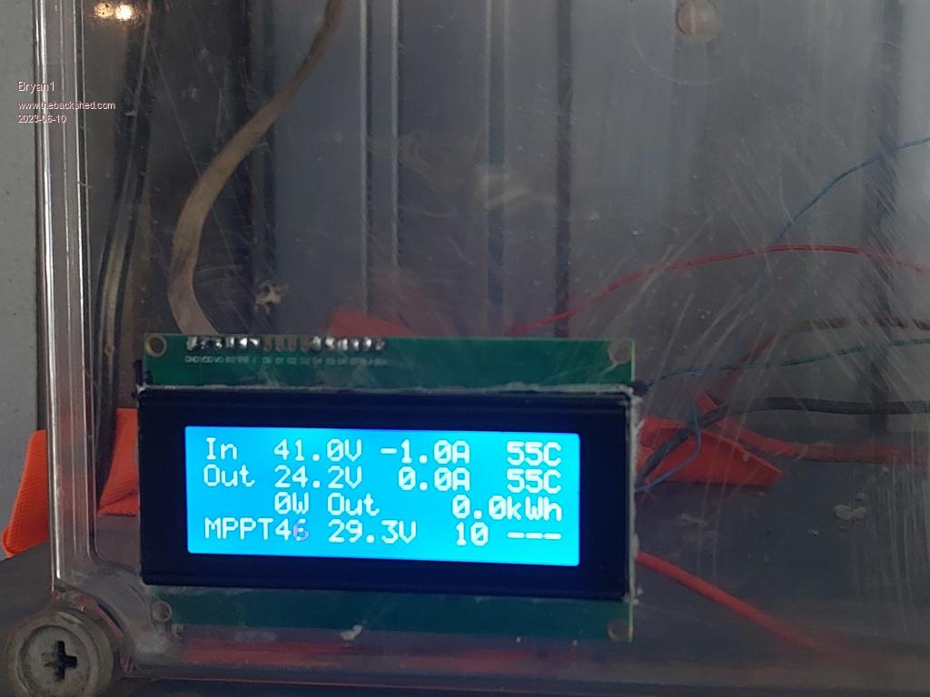

Hi Poida I just put my panels in series for 3 strings and the open circuit voltage was a tad over 40 volts, so connected the input power back on and the input power was drawn down to the battery voltage and it just stays in night mode.
So getting close but still no banana's
Cheers Bryan

Have you measured the current that the batteries are actually trying to draw?
Assuming favorable solar conditions, the only reason the panel output would fall to Vbat is when charge current is greater than the Panels can supply to the batteries,  a bad connection to the panels, or a fault in the controller, but a fault would become apparent rather quickly if the panels were previously tested in parallel and the controller itself was the cause.
Just throwing a few thing out there, you may have checked these already, hope you get it sorted soon, should be great once it's running correctly.

Bryan, are you waiting too impatiently ? When in nite mode it takes 60 seconds to start up after it got sun power, you can see the numbers in the bottom right corner counting.
Poida might explain that feature better.

OK new day and 170 watts coming in and still nite mode   saw a glimpse of 10 amps coming in too so something isn't right. Will leave it going and hopefully it soon wake up.

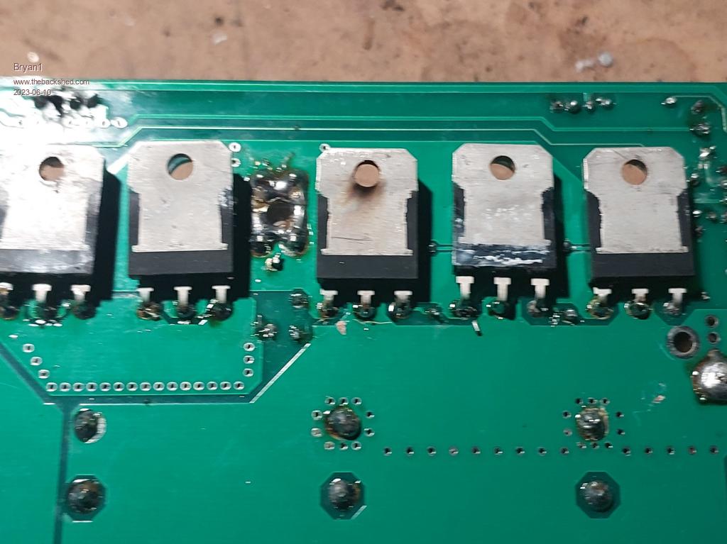

It sounds to me like there's a short across the mosfets (or they're shorted themselves. Or permanently turned on).
So as soon as the panels are connected they get pulled down to battery voltage.

Just put the probe on the TLP250 and pin 1-4 are all gnd where the right side is Vbat, now R1 is at gnd so no power going in from U1.
With the fets the gate is at gnd the source on Vbat and the drain on gnd so to me the fets are not even turned on. Also I did change fets after that spark with my dmm probe.

Not what I was expecting:-
For the fets (q1 - q3), i would expect drains to be at solar+, the sources to be at bat+, and with no signal to turn them on from the tlp250, the gates should also be at bat+
For the 'diodes' (q4, q5), i would expect the centre leg (labelled d) to be at bat+, and the other two (g and s) at ground.
All voltages measured relative to ground ( ground, bat negative
, pv negative, all being the same).

Hi Mab, I just checked the fet voltages and yes they correspond with what you wrote

If the voltages are as i wrote (specifically, the gates of q1 - q3 are at the same voltage as the sources  (bat+)), then the fets are turned off.
Therefore the drains of q1 - q3 (solar+) should be at the open circuit voltage of the panels (40v? Did you say?), NOT near bat+  .
So it does still look to me as if you have either a shorted fet or a short from drain to source across q1 - q3.

Maybe a silly question, but do you have the FETs and Diodes isolated from the heat sink. The MPPT needs to be isolated, unlike the Inverter which can be mounted directly onto the three separate heat sinks.

Good point Gerry as I did use M3 countersunk screws they could be making contact with the heatsink. It's an easy fix as I do have a heap of that white tape that is used to put behind the fets so I'll cut some disks out with my hole puncher then a 3mm hole in the centre then lightly tighten the M3 countersunk bolt.
Coffee is needed first then a quick test with my fluke 865 scope meter will let me know if the heatsink is at Vbat.

            Well I reckon I finally got membership in the blown fet club
So fitted all new fets and carefully checked they were isolated and machined up plastic inserts for the fet holes so the screw couldn't touch the fet and short out.
Got all setup again and eh Roger lets make a time mate as one problem is solved another is standing out no current
Saw 80 volts coming but no current so changed it back all parallel and no change to the current. Probed the incoming side of R1 and no voltage present.
Cheers Bryan
