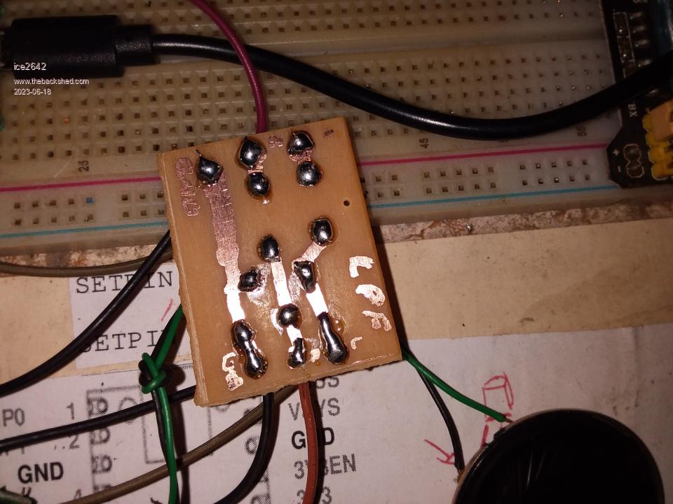

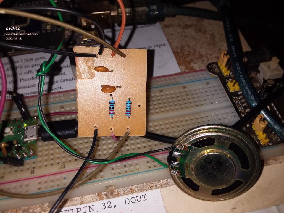

Posted: 12:19am 18 Jun 2023
Yes, I do not read the silicon chip article, just buy the board, I hope they send instructions with it.
I build the LPF very simple, and it work in simple way too :)
I intend to do another one.
Someone out there calculated the diameter, thickness and quantities of spirals to make the 4.7mf inductor ??? Did you need any iron-type stuffing or did you use air?

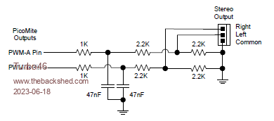

Posted: 02:50am 18 Jun 2023
I don't think that anyone has wound their own inductor. They have bought them. Somebody may be able to tell you where to buy the 4.7mH inductors.
This is the original filter circuit from an earlier manual. The 2k2 resistors reduce the output level to a more suitable level.

Posted: 03:14pm 18 Jun 2023
"Someone out there calculated the diameter, thickness and quantities of spirals to make the 4.7mf inductor ??? Did you need any iron-type stuffing or did you use air?"
I got a component tester, one that measures inductors, most do so could hand wind around a 1MR resistor with varnished copper wire from a transformer but I bought a 5 pack of 4.7mH inductors ebay £2 free p&p. Why bother making?
Posts: 8973
Posted: 03:35pm 18 Jun 2023
An air-cored 4.7mH inductor, using 0.25mm wire is about a 90mm cube. You really don't want to be winding one. :)

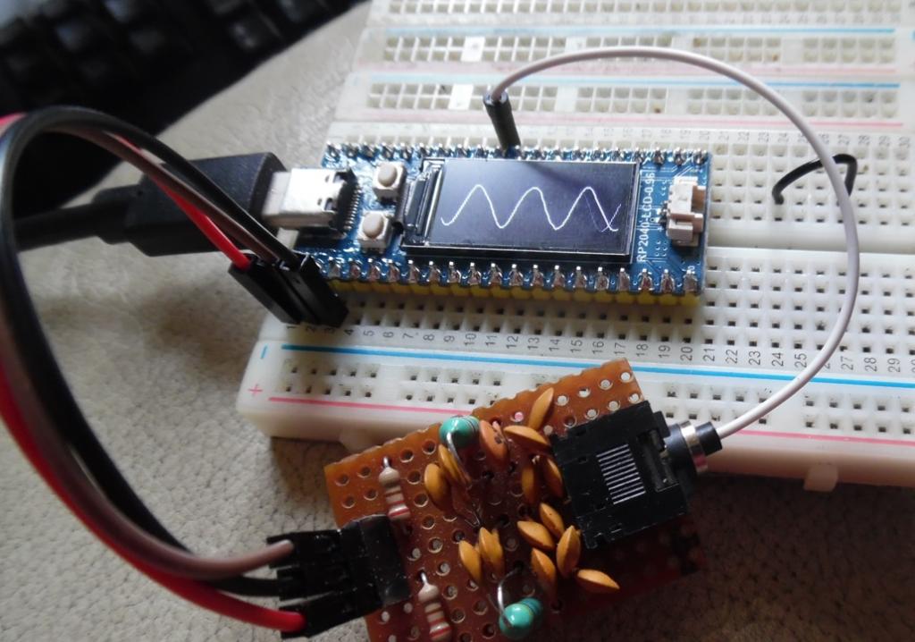

Posted: 08:49pm 18 Jun 2023
Thought so, no hint of sine wave, just carrier , looks like pwm 40KHz.
This is the filtered 10KHz tone
filter is important for sound so regards to the designer
Edited 2023-06-19 07:33 by stanleyella

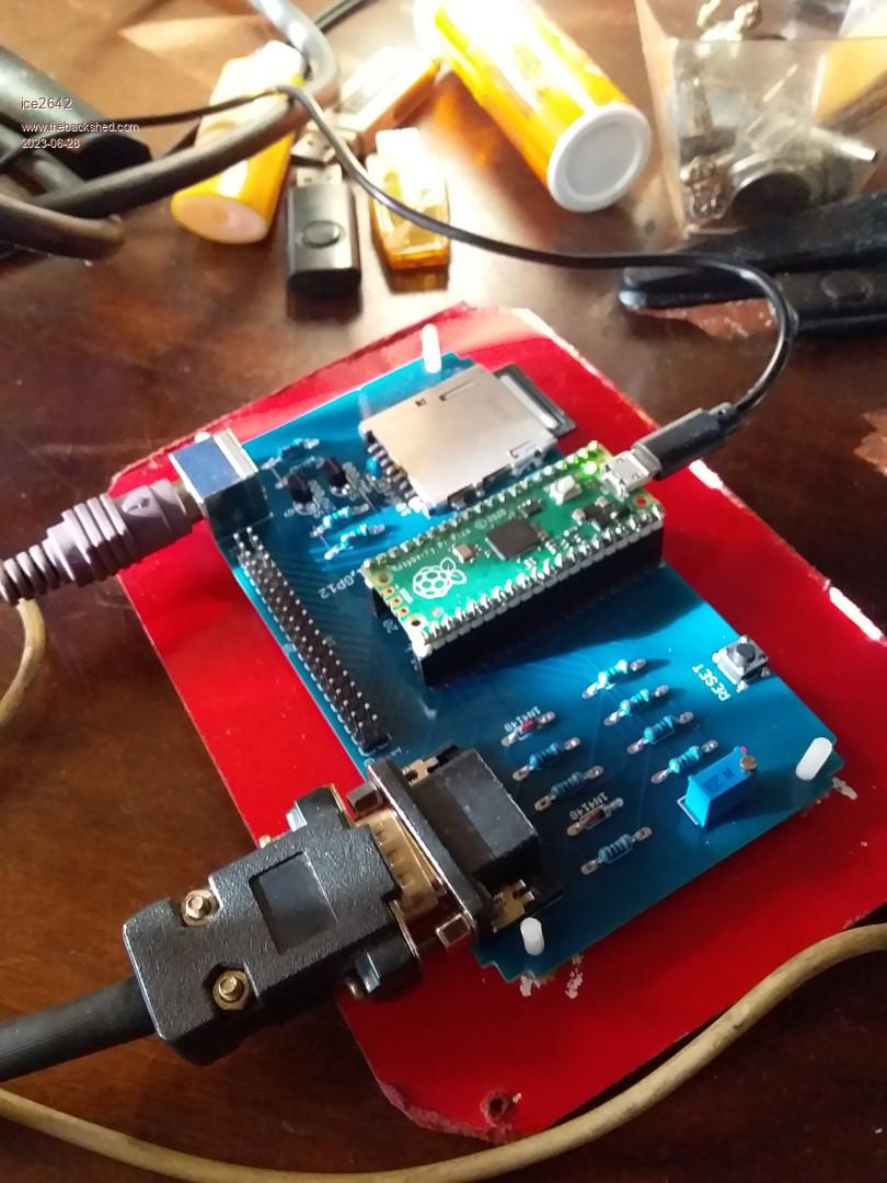

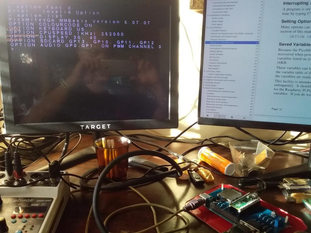

Posted: 07:28pm 27 Jun 2023
My picomite vga arrive yesterday, and now it is done and working fine.
I am waiting now the parts for the sound
The quality of the board is very good, but the PS2 role for fixation is missing, I cut of the 2 pins, and ok, just care now when I plug the keyboard.
Stanley , your wav it's show very good.

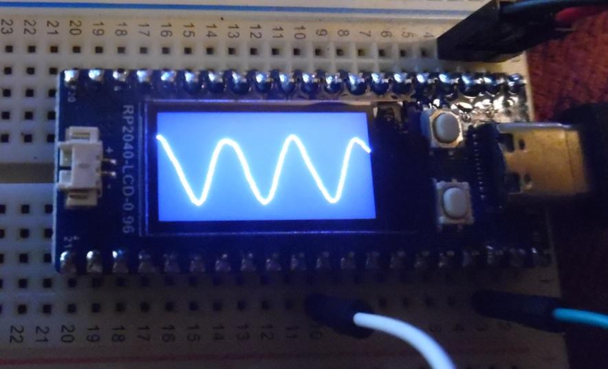

Posted: 01:44pm 28 Jun 2023
10KHz Tone. My simple scope code to improve. Needs sync. For 160x80 LCD.
 dim count%,sync!,sync2!
 Dim samples!(160)
 Dim old_samples!(160)
PLAY TONE 10000,10000,60000
 SETPIN GP26, AIN
 'SetPin GP18,pwm1A 'this optional test signal comment out
 'PWM 1,5000,50   ' 50% = square wave ,this optional test signal comment out
 Pause 100
 adc open 500000,1 'samples per second
 cls
 adc start samples!()'get new samples
 for count%=0 to 159
   samples!(count%)=(samples!(count%)*20)+10 'scale 3V samples to 0 to 79 pixels
 next count%
 for count%=0 to 159
   old_samples!(count%)=samples!(count%) 'copy samples to old_samples
 next count%
 for count%=0 to 158
   line count%,samples!(count%),count%+1,samples!(count%+1),,rgb(white) 'draw first samples
 next count%
'-------- main loop
 do
   adc start samples!() 'get new samples
   for count%=0 to 159
   next count%
   for count%=0 to 158
     line count%,old_samples!(count%),count%+1,old_samples!(count%+1),,rgb(black) 'erase old_sample
     line count%,samples!(count%),count%+1,samples!(count%+1),,rgb(white) 'draw new sample
   next count%
   for count%=0 to 159
   next count%
 loop
end

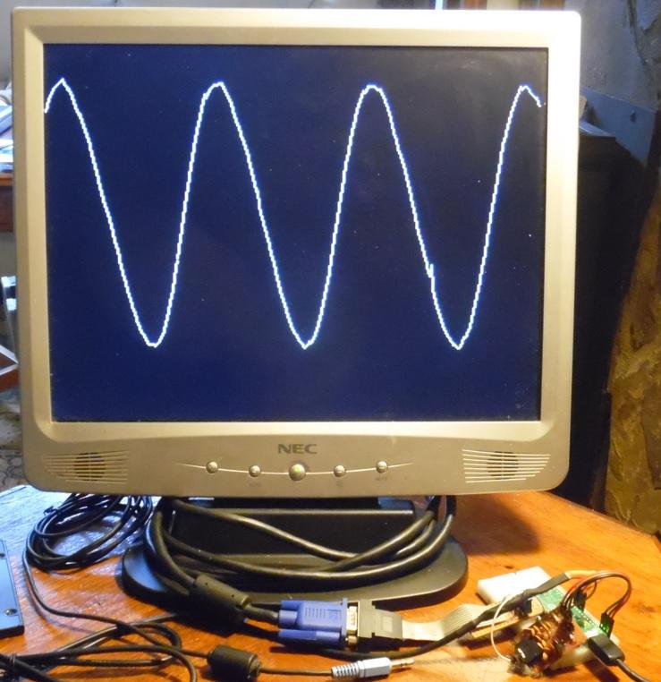

vga version
mode 2
Dim samples!(320)
Dim old_samples!(320)
PLAY TONE 1000,5000,600000
SETPIN GP26, AIN
Pause 100
cls
for count%=0 to 319
  samples!(count%)=(samples!(count%)*60)+10 'scale 3V samples to 0 to 79 pixels
next count%
for count%=0 to 319
next count%
for count%=0 to 318
next count%
'-------- main loop
do
  for count%=0 to 319
  next count%
  for count%=0 to 318
  next count%
  for count%=0 to 319
  next count%
  pause 1000
loop
end
Posts: 5998
Posted: 04:19pm 28 Jun 2023
Tip: you can replace the for I=0 to 159 loops with MATH commands.
Math commands can perform offset and gain calculations on the whole array in one instruction
Also copy one array to another.
P.s. I think the thread derailed a bit from it’s topic.
Edited 2023-06-29 02:23 by Volhout
