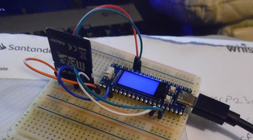

wired the adapter and 16mb card but typing files in teraterm shows
> files
A:/
  <DIR>  .
  <DIR>  ..
00:00 01-01-2000          4  bootcount
2 directories, 1 file, 712704 bytes free
tried to change to "B:" command not recognises error.
I never used sd card so how to test on non vga.
using option sdcard gp16

First, make sure that the pins you are using aren't being used by something else on that board. You can use any pins for a SDcard if you specify them all. You can use the system SPI pins if you like, but with a CS pin that isn't shared with anything else.
You won't see the file listing on the LCD normally, only on the console.
After that just enter FILES. If there's no card in it'll tell you, otherwise you should get a listing.
Cards have to be formatted to FAT16 or FAT32 - Not NTFS, which is what Windows always wants to use by default. They can be up to 32GB.

Thanks again Mick, sd csard adaptor not working, files show A:.
I think choosing GP16 as CS was a mistake,should have used gp22. How to reset option sdcard gp16 please. sorry to be a pain, it's new stuff to me.

You'll have to clear the setting with OPTION SDCARD DISABLE then put the new options in.
The display is using GP8-12 and GP25 so I'd have thought you'd have been ok with GP16.
Make sure you've followed the manual with regard to how to connect it. If you have put it on System SPI then you only need OPTION SDCARD GP16. If not you have to specify all the pins.
I'm not sure which version of MMBasic you are using. Try using DRIVE B instead of B: to change drives.

Posts: 2807
Posted: 07:12pm 21 Jun 2023

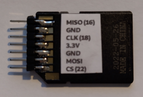

Maybe my soldering is carp. I tried not sharing spi with display and used optin sdcard but no joy. can't think of anything else. The 4GB has a file.bas but just shows drive A:
I'll solder another. yawn :) Ta for helping though Mick :)
> option list
PicoMite MMBasic Version 5.07.07
OPTION SYSTEM SPI GP10,GP11,GP28
OPTION LCDPANEL ST7735S, RLANDSCAPE,GP8,GP12,GP9
OPTION SDCARD GP22, GP18, GP19, GP16

If you are specifying all the pins the sequence is
OPTION SDCARD CS, SCK, MOSI, MISO
These have to line up with the card connections, obviously.
In order from the chamfered corner of the holder the order is 9,1,2,3,4,5,6,7,8
9: no connection
1: CS
2: MOSI
3: GND
4: 3V3
5: SCK
6: GND
7: MISO
8: no connection
Note that there are two GND connections (they may be linked elsewhere but it does no harm to connect both).
Better check your wire connections to the socket. Maybe try a different set of holes on your breadboard too. Your soldering doesn't look bad to me.
Are you certain that the card is formatted FAT16 or FAT32? If you just put it into a windows machine and format it it will probably end up as NTFS and it won't work.

Posts: 2807
Posted: 08:45pm 21 Jun 2023
The card is fat 32 with a .bas file.
The card was wired correct for sharing the spi with the display, just added option sdcard gp16 then reset and used gp22 instead.
Then tried option reset and set up again but OPTION SDCARD GP22, GP18, GP19, GP16
No pins used twice
Still no joy ie files lists A:
Now the waveshare 2040 lcd displays any running program for a second then blank screen then displays a second repeating 4e4. I'll reflash hardware but think I messed it, never seen this :( want to see a video?
edit I'm not using lcd gp25 backlight, could that be the once a second blanking.
let you know
Edited 2023-06-22 06:58 by stanleyella

Posted: 09:18pm 21 Jun 2023
Hi Mick. The every second blanking WAS not using gp25 backlight. Me smug mr spock :)
handy tip for waveshare 2040 lcd users
sdcard adaptor no shorts but maybe no connection to card? not meant for soldering,try again.
the backlight pin must default on if not set up
Edited 2023-06-22 07:33 by stanleyella

Posts: 2807
Posted: 10:42pm 21 Jun 2023
Melted 2 more adaptors. Buy one that works. spend £5, less haddock,I give up.
