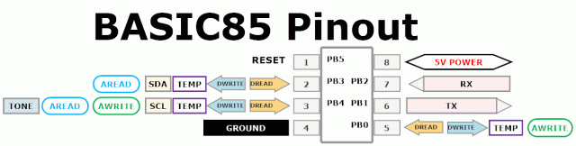

  Quote  Is this right?
Missing aread on pin 2

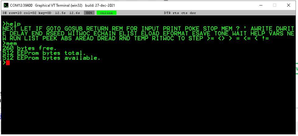

I have been playing
 10 'kw\attiny
 20 N = 16384
 30 PRINT n* 2
 40 n = n * 2
 50 PRINT n
 60 PRINT n-1
RUN
32767
OK
Trying to print 32768 gets interesting.
