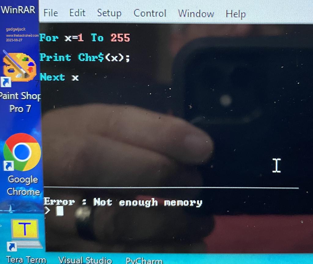

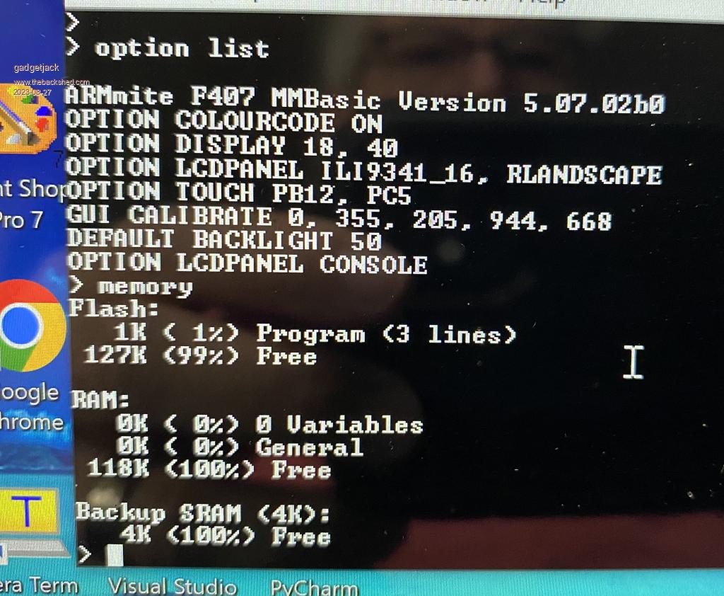

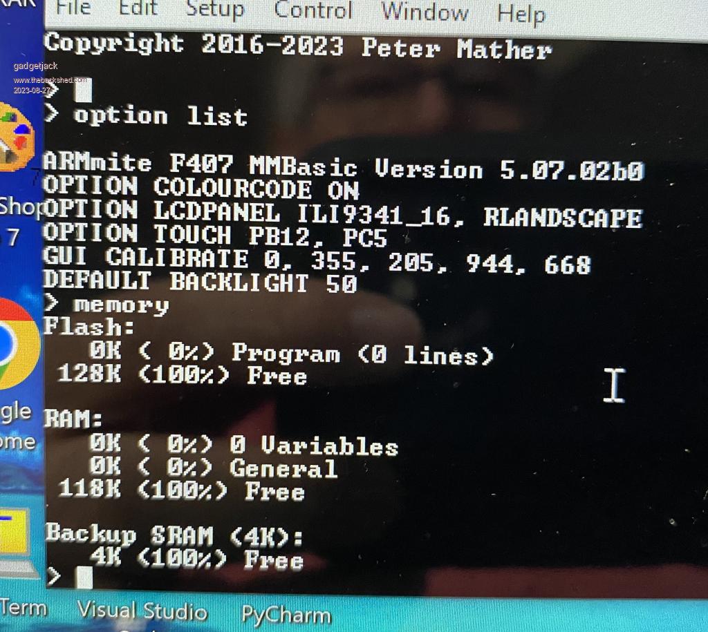

I tried both yours and Peters last firmware loads. Both do the same error with lcd console on. I went back to Peters previous firmware from 2021 and no error. Edit works and saves fine. Somewhere in Peters last update got a bug and followed into your update too. I was thinking I screwed something up on my board. I hope it is an easy fix as I love all the new stuff you both added.
disco4now
Joined: 18/12/2014
Posts: 1151
Posted: 03:34am 26 Aug 2023
Can you give a printout of results of  for commands.
a) OPTION LIST
b) MEMORY
Gerry

disco4now
Joined: 18/12/2014
Posts: 1151
Posted: 12:02am 27 Aug 2023
Error: Not Enough Memory
I can see on the ILI9341_16 screens when OPTION LCDPANEL CONSOLE is set, I think I have a fix for that. This does not affect the SSD1963_x_16 displays with hardware scrolling.I suspect the IPS_4_6 will has this issue as well, same fix.
I also am seeing the editor not quite working correctly when OPTION LCDPANEL CONSOLE is set.
It seems to use double spaced lines, it corrects itself if scrolling with UP/DOWN arrows only, but PgUp,PgDown, Home and End show the double spacing.Its double spaced when initially opened.

Armmite F4 5.07.02 Beta 1
Manual and Firmware
ArmmiteF4_5.07.02betas.zip
Fixes
Resolves the Not Enough Memory when using EDIT with OPTION LCDPANEL CONSOLE.
It affected all LCDs without hardware scrolling. i.e. all except SSD1963_x_16
Resolves issue of double spacing of lines when using the EDIT command with OPTION LCDPANEL CONSOLE set.
Function RGB() now accepts  GREY
ST7735S IPS 160*80 SPI LCDPanel support added.
Updates for no Battery

gadgetjack
Joined: 15/07/2016
Posts: 236
Posted: 03:16pm 27 Aug 2023
Gerry , Thank you very much. It works perfect now. I did not expect you to do it so fast.
And by the way , welcome to the "Can you fix this?" club. Might give Peter a well deserved break.

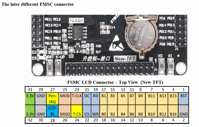

Joined: 18/12/2014
Posts: 1151
Posted: 04:51am 01 Sep 2023
I think this is the alternate FSMC connector that some have received. The board is identified by the New-TFT on the silkscreen next to the connector.
Can anyone who has received one lately verify the version on the back of the board.

I just received a board marked V36.
If you want me to report anything about it please let me know what.
Oh - typo above: I think FMSC should be FSMC.
TrevorH
Joined: 06/04/2018
Posts: 145
Posted: 09:16am 01 Sep 2023
Is this a peculiarity with the later version board only, as clearly the old FSMC connector board works OK. Will do some more testing today. The pinout is identical except for pins 1,2,29 & 32, correct me if I am wrong.
I have done the LED-A mod on the display and used backlight 100 OK.
Trevor
disco4now
Joined: 18/12/2014
Posts: 1151
Posted: 11:59am 01 Sep 2023
  TrevorH said  The pinout is identical except for pins 1,2,29 & 32, correct me if I am wrong.
Yes these appear to be the only difference that I can see (I don't have one).
I guess you have connected the SSD1963 by wiring the relevant pins with jumpers.
As I understand it, once you enable touch with OPTION TOUCH PB12,PC5 it appears just to freeze.i.e can't get a response from the console. How do you recover from there, unplug the LCD Panel and restart? Power Restart with K1 held down?
You could try BACKLIGHT 0,S to turn backlight completely off, then check whether enabling touch causes the same freeze.(This will prevent backlight using any power to prove it not a power issue.)
You are probably the first to use the SSD1963 with the new FSMC layout, but on the surface this should not cause a problem.
Gerry
F4 H7FotSF4xGT
TrevorH
Joined: 06/04/2018
Posts: 145
Posted: 12:10pm 01 Sep 2023
I have done my own PCB for the conversion using SL6, home etched, will do some more testing and report back.
Trevor
TrevorH
Joined: 06/04/2018
Posts: 145
Posted: 12:59pm 01 Sep 2023
If I load a picture onto LCD from SDcard, works OK, enable touch and then run gui test lcdpanel, the picture stays on the LCD but is flashing on and off. If I then ctrl-c to exit the test (console NOT frozen) and run cls rgb(red) console responds OK but nothing on LCD. It's as if the LCD is not enabled any more.
I did check 3v3 with and without LCD and with or without touch, also backlight %, no change.
Trevor
