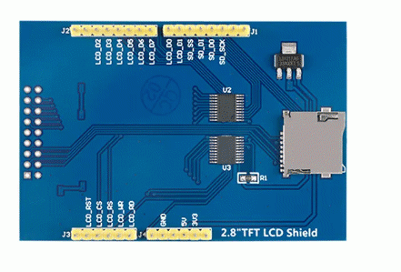

Posts: 3879
Posted: 03:21pm 26 Sep 2023
  matherp said  Support for 8-bit parallel ILI9341 display
I happen to have one of these "Arduino" ILI9341s, purchased by mistake 4 years ago. It  has pins labelled LCD-D0 through LCD-D7. Is it likely that it can be connected with flying wires as yours is to work in 8-bit parallel mode?

Posts: 3879
Posted: 05:52pm 26 Sep 2023
  matherp said  Should work, certainly worth trying
Which pins need to be connected to which?
Posts: 11838
Posted: 06:26pm 26 Sep 2023
  Quote  Which pins need to be connected to which?
As per the manual for a SSD1963.
