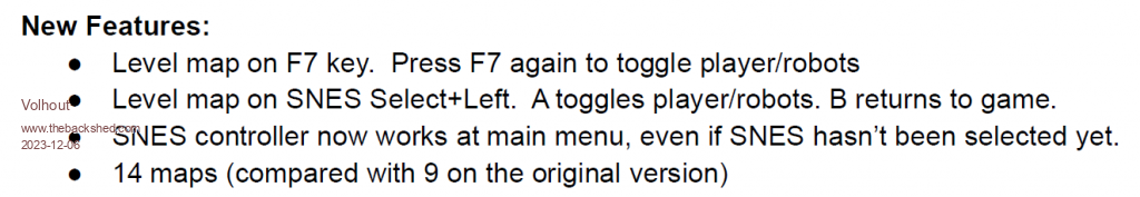

  Volhout said  I have on my todo list a piece of text how it all works.
Need Martins support fot the mod files and samples.
Here is my attempt at an explanation
'no comment

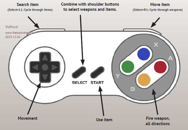

Thank you. Note that the SNES buttons could be mapped to meet the definintions by David Murray. Not sure if this is playable.
The other controllers we can decide for ourselves.

I needed to search to find it, but this addendum for the C64-REU version shows the implementation on SNES controller for MAP mode (the TAB key).

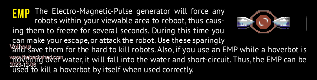

1. Unless I'm misremembering from my play session I believe the (roller?)bot can still shoot whilst under the influence of the EMP is that correct behaviour ?
2. I seem to recall from one of David's videos him saying that two EMP blasts would permanently disable a robot (presumably not the EvilBot). It doesn't in the MMBasic version, should it ?
Posts: 6101
Posted: 08:37pm 05 Dec 2023
Hi Tom,
I am not sure about shooting, but after few seconds they wake up again.
It is not hard to adapt the shooting, but I simply don't know.
EDIT: just tried it on the DOS version, and yes, the rollerbot should stop shooting.
EDIT2: it is implemented in the next revision.
Edited 2023-12-06 06:55 by Volhout
