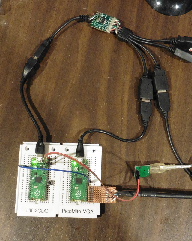

have just got a "PicoMite VGA Duo" set up and running (yes - i have officially named it) using an Fe1.1s USB 2.0 hub chip and a compact layout USB keyboard.
it works superbly!
however, the default font that the picomite uses for VGA output (including when editing) is absolutely horrendous! this is the 8x12 font that gives an 80 column by 40 line text screen. apart from the hideously mangled lower-case "m", the lack of descenders makes reading text entirely unpleasant. it looks like it has been designed for maximum characters on screen with zero regard for readability.

my setup:

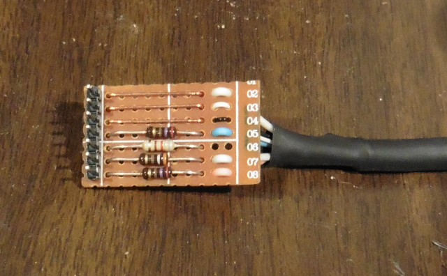

VGA components on daughterboard:
