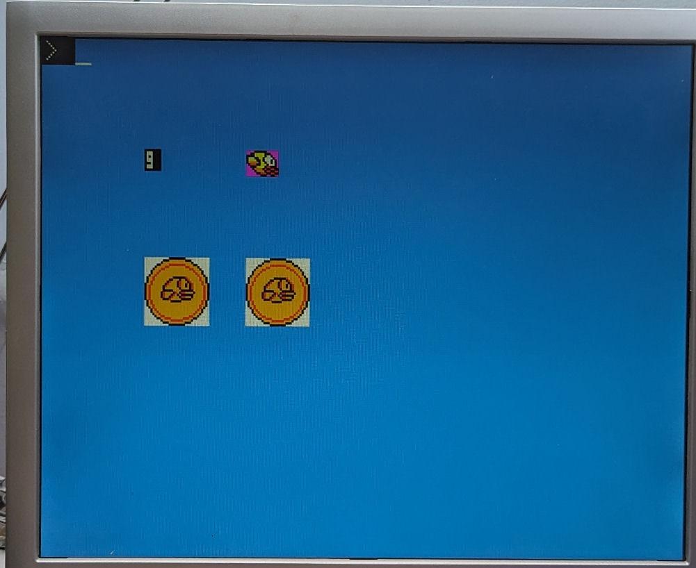

Peter, Geoff,
I would like to report a bug in the PicoMiteVGA firmware V5.08.00.
It is about the SPRITE LOAD command. There are 2 issues
1/ SPRITE LOAD only works when you increment the sprite number with 1 each successive load. You can not load sprites 1,2,7,8 without loading 3,4,5,6 in between. (you do not get an error, but when showing/writing sprites 1,2,7,8 you get black squares for 7 and 8. This is an inconvenience, and may not be worth fixing.
2/ SPRITE LOAD seems to inherit the vertical size from the sprite loaded before. See attached test program. It load the same sprite as #3 and #4, and shows them both.
You can clearly see that #3 has the vertical size of (previously) loaded #2. This is an annoying bug.
sprite_fail.zip

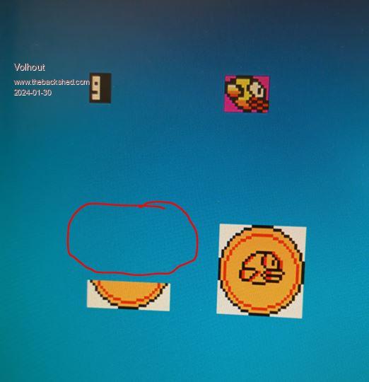

Posts: 5995
Posted: 08:01am 30 Jan 2024
The bug is even clearer to see with this version.
sprite_fail.zip
Note that in the missing area of sprite #3, sometimes parts of other sprites show. Not in this simple program. So it may be a pointer pointing to the wrong address.
Note also that sprite #2 (16x12) is not cropped to the vertical size of sprite #1 8x10). So it does not happen for all sprites.

Posts: 11657
Posted: 12:20pm 30 Jan 2024
  Quote  The bug is even clearer to see with this version.
What am I supposed to be seeing?
Posts: 5995
Posted: 12:51pm 30 Jan 2024
Huh....
I tried this on 2 different platforms (your VGA rev.1.7 and PicoGameVGA 1.4) and both show the problem.
The only thing I can think of that may be different, is that there is daya in FLASH slot 3 and slot 2. I erased all data from flash slot 3 and 2, and the problem still shows.

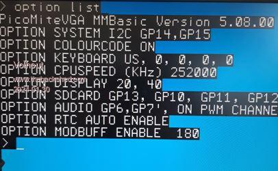

Posts: 11657
Posted: 12:58pm 30 Jan 2024
Your option keyboard looks very strange - try OPTION KEYBOARD DISABLE and then OPTION KEYBOARD US
Try re-flashing with this - will erase all the options, a: drive etc.
IMPORTANT: then apply the options manually, don't use disk load just in case

Posts: 5995
Posted: 01:23pm 30 Jan 2024
Hi Peter,
EDIT: MY PS2 KEYBOARD DOES NOT WORK WITH THIS VERSION (ONLY USB Teraterm).
But it fixed the sprite issue
I cleared the flash, reloaded the version on Geoff's website, manually added all options, and the problem is also gone. I have no idea what this was, but on multiple systems.
Edited 2024-01-30 23:40 by Volhout
Posts: 5995
Posted: 07:03pm 30 Jan 2024
Hi Peter,
Small update...
My second unit at home is not fixed. I tried
- Nuke flash + your above suggested PicoMiteVGA(3).zip, no options added(*): problem remains.
- Nuke flash + Geoff's V50800, no options added: problem remains
- Add options, one by one : problem remains.
Sorry to say, but this is not fixed.
I will do some more experimenting..
(*) No options means run from A:
HOERAH, FOUND IT
When I copied the files on B: using the PC, it worked correct.
When I copy the files to A: using MMCC (XMODEM) it does not work, I get half sprite
When I copy the files from B: to A: using COPY "*.*" to "A:" it works correct.
Apparently XMODEM corrupts the sprite files (appends ?) and that causes the problem.
Thank you for your attention. Maybe this experience should be common knowledge.
