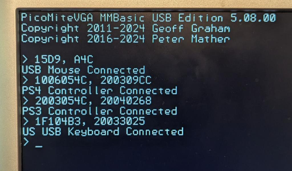

Posts: 11657
Posted: 06:49pm 28 Jan 2024
Quick update
I've got a USB keyboard, USB mouse and a Sony DualShock4 all working perfectly within MMBasic using the same code. Now the question is will they all work together - as long as Amazon deliver a new hub I'll know tomorrow

Posts: 11657
Posted: 06:23pm 29 Jan 2024
Progress
