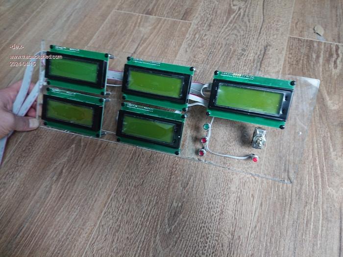

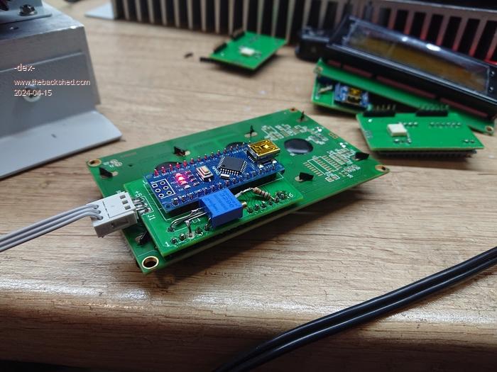

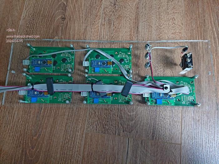

I placed the LCDs on a piece of plexiglass. They are supported by nano controllers placed on adapter boards.

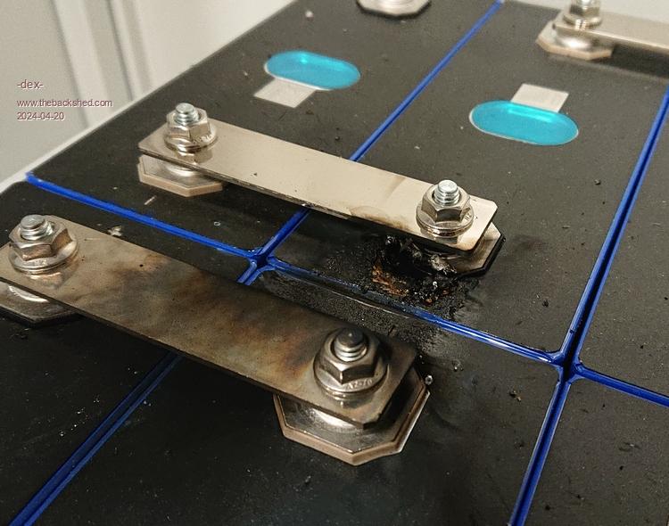

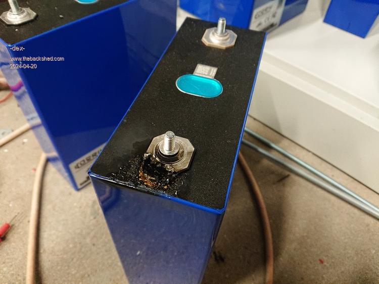

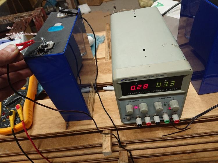

First serious bang bang!
So far, for testing purposes, I have used a set of 4 small AGM batteries as a power source.
The inverter has been pre-started, so there is no chance of any wiring errors.
Today I installed the target set: 16pcs of lf280k cells. The links were pressed together using two sheets of metal and screws. The voltage of the entire battery pack was 53V. Everything looked OK.
I switch onthe MCCB breaker that supplies voltage to the busbars to the system and at that moment there was a huge flash, a beam of sparks from the cell, I realized that it was a short circuit and immediately disconnected the fuse.
How did this happen? I don't know. But I found out how dangerous these small, inconspicuous blue boxes are.
-dex-
Joined: 11/01/2024
Location: Poland
Posts: 104
Posted: 12:14pm 20 Apr 2024

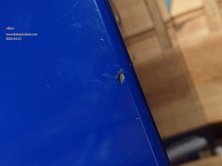

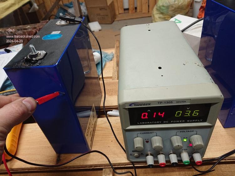

After this accident, I checked whether the "+" and "-" buss were shorted behind the switch. After MCCB breaker there is no short circuit.
I can only add that the negative busbar is connected to ground, and the entire housing is also connected to the ground busbar. In other words, the entire case has a "-" battery potential
Is it possible that the short-circuit current flowed through the cell housing into the system housing? I didn't use any additional spacers/separators.
I dismounted battery pack and it turned out that some of the cells were slightly injured and could have come into contact with the metal screw, and then screw with metal housing.
I further checked whether the cell's aluminum casing had any potential under the blue foil. It turns out yes. Some of them have "-" on the housing, and the rest have "+" on the housing. However, it is not a full connection with the terminals, there is some resistance between them.
rogerdw
Joined: 22/10/2019
Posts: 957
Posted: 12:47pm 20 Apr 2024
Ouch, that would have given a fright. Sorry I have no experience with those cells at all. I have read of some types where there is concern about the insulation on the outer battery case being too thin or being damaged and causing issues.
It's always nervewracking switching things on the next time after a blowup ...  well it is for me anyway  ...  so good luck when you fire it up again.
Your mppt chargers turned out really well too, congratulations. I plan to fit my displays and some analogue meters like that to the front cover  ...  when I get to that stage.
Cheers,  Roger
Murphy's friend
Joined: 04/10/2019
Posts: 678
Posted: 01:06pm 20 Apr 2024
I do not think it is a good idea to ground the battery negative to chassis. I certainly do NOT do that in my inverters.
Instead I connect the AC ground to the chassis/housing.
That way there is no bang if one of your battery leads accidentally touches the housing cabinet.

Any large lithium battery can cause havoc quickly due to the much lower internal resistance compared to lead-acid/AGM batteries.  I also learned the hard way.  I second Murphy's suggestion.
KeepIS
Joined: 13/10/2014
Posts: 2282
Posted: 09:35pm 20 Apr 2024
The aluminum case is normally at one potential- some brands cells normally come with a type of fiberglass spacer sheet, can be bought in packs if you have nothing suitable, these protect close mounted cells, a 54v LifePO4 battery bank is seriously extremely dangerous.
That looks like a breakdown between the case and the opposite polarity terminal. That should not happen. Shorting out a 54v bank normally vaporizes the object causing the short or cable. Did you have a BMS connected - that's one of the things it's meant to stop- total battery destruction with almost unlimited current available in the event of a external short.
Solar Mike
Joined: 08/02/2015
Posts: 1255
Posted: 10:08pm 20 Apr 2024
That would give you a fright! With these type of battery cells the blue shrink wrap insulation is not sufficient to prevent cases shorting; always place an insulator like thin glass fibre sheet or thin polycarbonate sheet between all mating cell housings and the bottom if sitting in a metal box.
That splat looks like between the case and terminal, wow something wrong possibly in that cell or the case was touching another.
Posts: 3412
Posted: 08:36am 21 Apr 2024
  Quote  Some of them have "-" on the housing, and the rest have "+" on the housing.
If the base of that cell was in contact with the metal shelf then the connection between the terminal and the case would blow like a fuse.
Check the base of that cell for damage to the blue skin.
If that is what happened it is possible that cell can still be used if the cells sit on plastic.

Posted: 11:43am 21 Apr 2024
Yes, the blue insulation is damaged. This is a small damage and there is no trace of high current flow, nor is there any trace on the screw. If there was a knocking surface, it was not large considering the current that flowed.
I'm not sure if I want to continue using it. This short circuit didn't make much of an impression on cell - the voltage dropped by less than 100mV. However, there is a hole from which some liquid leaked.

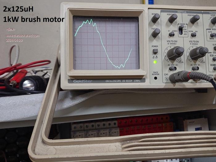

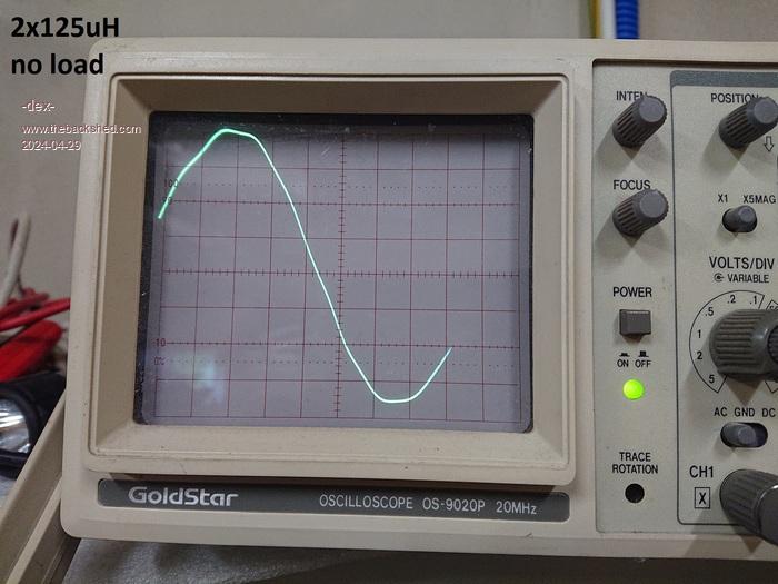

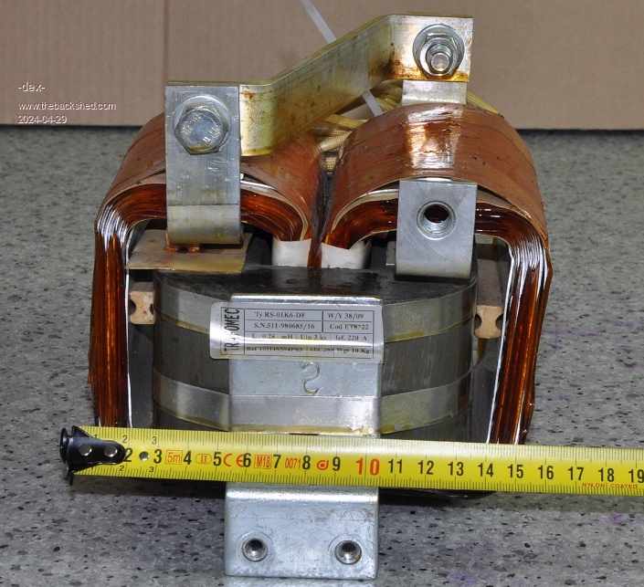

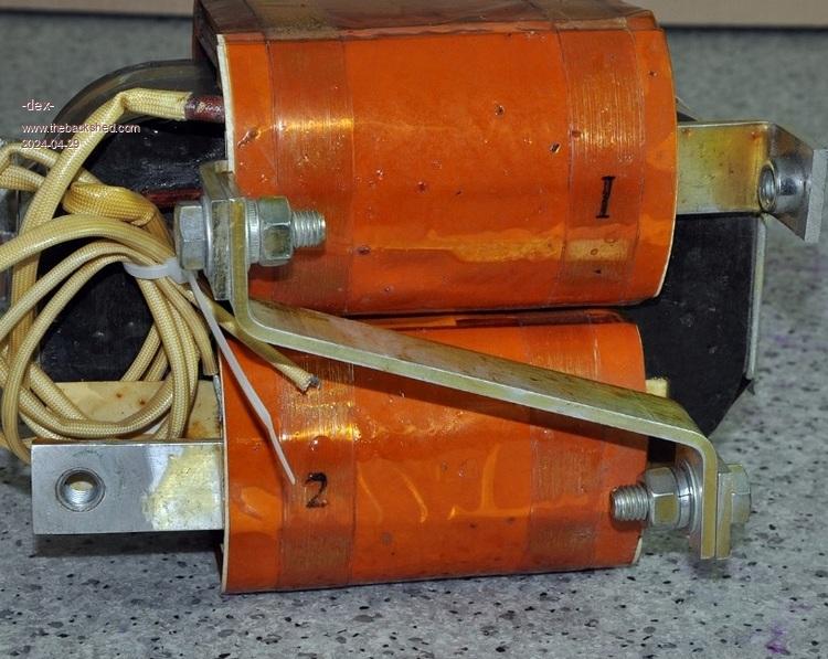

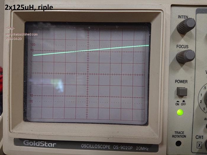

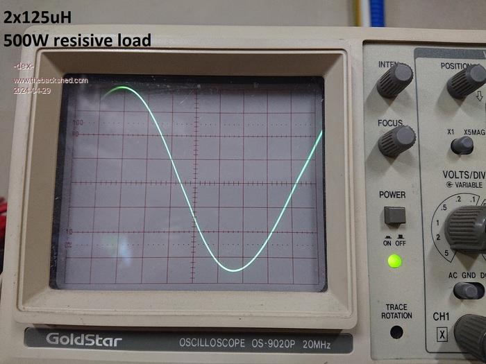

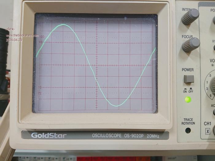

The inductance of the first chokes (2x 10uH) turned out to be too low.
I went the other way and wanted to check what would happen when the inductance will be much higher than required.
This 10kg choke is originally rated at 250uH/200A. So I disconnected the two series windings and obtained two separate coils of 125uH each.
Connection diagram as in the diagram below.
No-load waveforms has obvious distortions. The ripples are not noticeable. A resistive load reduces the wave shape to a perfect sinusoid, while all other types of loads cause very strong wave deformations.
I also connected other loads, and the wave deformations are very deep.
KeepIS
Joined: 13/10/2014
Posts: 2282
Posted: 09:22am 29 Apr 2024
Yes, that is exactly what will happen when you go much above a total of 60uH with a decent toriod transformer.
All of my testing has always been skewed towards the bigger heavy complex loads - that is where the Inverter has to survive. Things can look sweet with a good restive load of a few kW, but the inverter can fall in a heap with complex load conditions, I never have any large resistive loads running on the system when testing, that can hide and dampen some bad shi!.
-dex-
Joined: 11/01/2024
Location: Poland
Posts: 104
Posted: 09:58am 29 Apr 2024

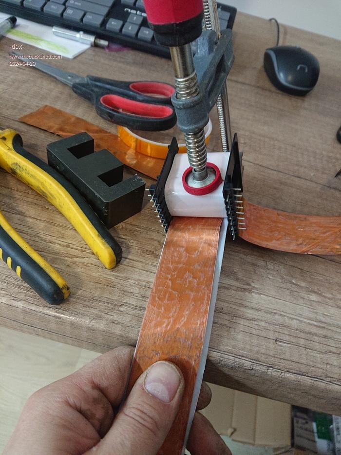

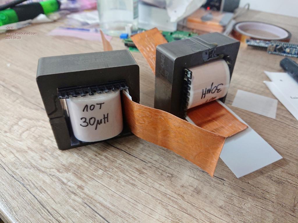

I go back to the EMS cores and re-wind them as shown in the photo. This white tape is a 0.19mm thick Mylar film cut from a large sheet.
Unfortunately, to accommodate the required number of turns, I placed not two, but one layer of copper tape. With my maximum loads up to 150A, which usually do not last longer than 10-15 minutes, this means an increase in the temperature of the copper tape by about 20 degrees.
No I have 2 x30uH and the saturation current is somewhere around 160A.
So this chokes will continue to be tested and closely watched.
The waveforms looks very good. Changes in the waveforms under load are not as drastic as in the case of 2x125uH, although they are also visible. So far I've only caught waves at no load.
Even though the choke is glued and fastened with clamps, it makes a squealing sound during operation, which gets louder and louder when I load the inverter.
