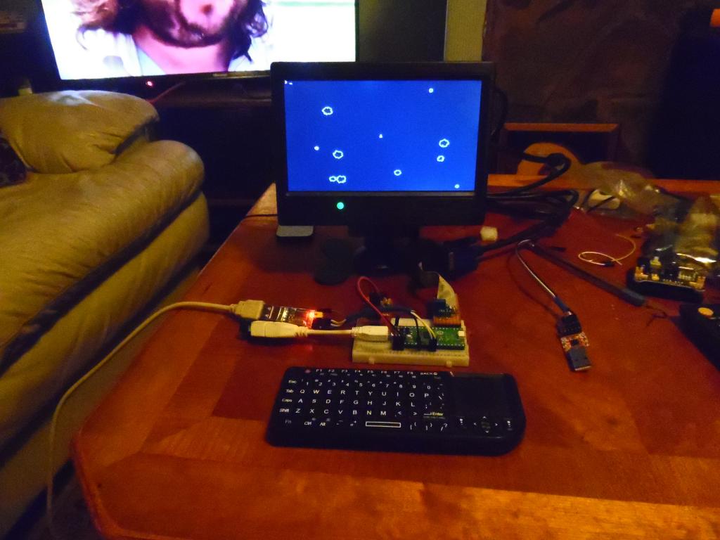

Being able to use a usb keyboard means no more full sized keyboards hoggin space and I use a 7" vga/hdmi/avi £12, 5v to 24V display  (sold as car reverse monitor)
I don't know what resources are lost with usb compared to non usb picomite but so far it's been a great option imho.
All coding on win pc with mmedit although can use usb keyboard and it's like a terminal.
I never got into the vga mmbasic as it was on a table with a 14" monitor and full sized keyboard in the corner attatched to another pc and I couldn't watch tv.
This is more compact and doesn't block the tv :)

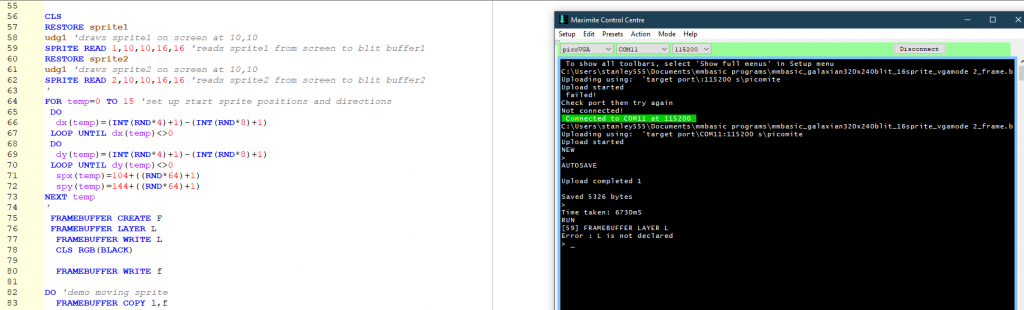

Not sure this error, wrong line number. it did work until this beta but sprites have changed.

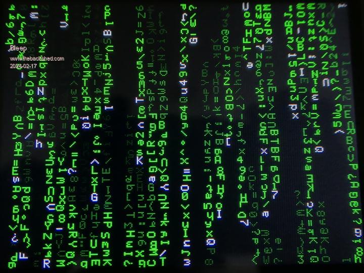

This is a copy of my latest Matrix Code Rain display. It's using some of Peters latest stuff like Blit with a LCD, frame buffers etc. so you need 5.09 or greater.
The display is scrolling down at a rate of 4 pixels at a time to improve smoothness.
It should run on any Pico, LCD any size or a VGA, hopefully. I have some relatively large Pauses in the loop, so this is amazingly fast, considering the whole screen is being scrolled every iteration.
Video Here
MMBasic file
matrixcode.zip
Regards, Kevin.

  Quote  I attach a simple demo program showing a standard PicoMite (or PicoMiteVGA) using all 64 sprites with full collision detection
I got
RUN
[8] Sprite set transparent 0
Error : Syntax
> option list
PicoMiteVGA MMBasic Version 5.08.00b0
dunno?

PicoMiteVGA MMBasic USB Edition 5.09.00b1.
RUN
[45] Sub vector(myobj As integer, angle As float, distance As float, x_new As intege
Error : Syntax
Posts: 6548
Posted: 11:54pm 16 Feb 2024
  stanleyella said  PicoMiteVGA MMBasic USB Edition 5.09.00b1.
RUN
Error : Syntax
The listing suffered from wordwrap.
