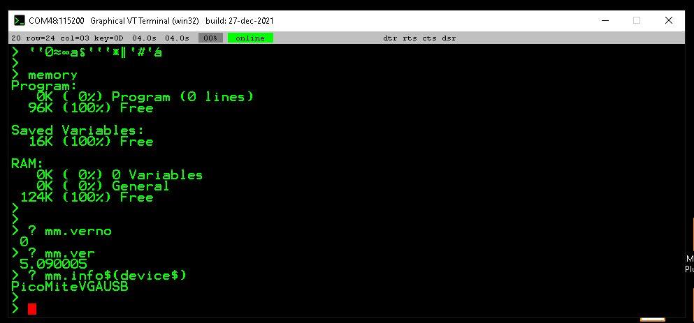

Can someone please link me to the most recent version of the FW for this board.
I downloaded the version from Geoff's website, but it is listed as version 5.08.00, which I note is still an older version then that which Peter mentions above.
I still think at this point, that I am using the wrong FW.
I'll have a look through the original thread too - Peter may have posted links there.
EDIT: I found it on this thread.
I will flash that in, and see if we have talkie!
Edited 2024-03-04 07:49 by Grogster
Posts: 9996
Posted: 10:04pm 03 Mar 2024
WORKING! - YAY!!!!!
I noted that LED1 blinks once quickly, then settles into the usual heartbeat blink.
Is that by design, so you know it is the VGAUSB version of the FW?
I expect it probably is, and is a good way to know that you have that version "Inside".
RIGHT!
Now to set the options as on the rear of the board, in the order stated, and then I can do some more tinkering.
Thanks for everyone's help and posts - they were useful, and encouraged me to not give up and move onto something else, cos I have a rather large "To-do pile" right at the moment!

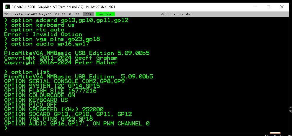

Posted: 04:47am 04 Mar 2024
OPTION RTC AUTO throws an error: (invalid option)
This may not have been added to the beta yet - yes/no?
disco4now
Joined: 18/12/2014
Posts: 1133
Posted: 05:13am 04 Mar 2024
Looking at the manual it might need ENABLE or DISABLE as well.
Looking at the code it will say "Invalid Option" if one is not specified.
Try
OPTION RTC AUTO ENABLE
or
OPTION RTC AUTO DISABLE
F4 H7FotSF4xGT
Posts: 11657
Posted: 08:15am 04 Mar 2024
Its an omission on the silkscreen. As disco4now says add "enable". Corrected on the latest gerbers
