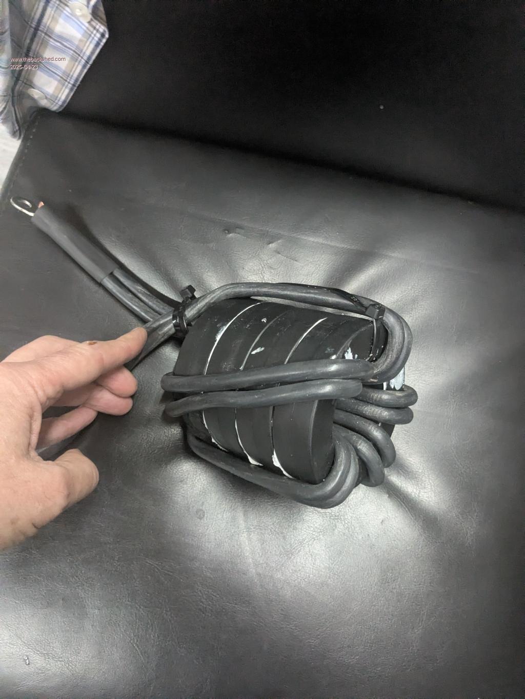

I did remove a turn from each inductor, but didn't notice any real change in my shortish period of testing.  One thing I did notice, was that the current draw at idle can change when the noise oscillates up and down in amplitude.  At one point, with the noise at maximum, the unit was drawing 21 watts, and after it cycled down to be quiet it was back to 17.5 watts.  This is not always the case though as sometimes the noise ramps up and I don't see a significant change in current/power.
After doing the testing, I did install the 34uH choke made from the Amorphous cores.
I glued the 4 cores together and filled the air gaps using silicon.  Unfortunately it was low strength silicone but it was all I had on hand.  I have not noticed any noise being generated by the core, but need to do some more testing.  Lots of room on these inductors for wire!
Interesting.  What's the main reason you chose amorphous nanocrystalline over Sendust cores?

Just trying different cores I already have.  I purchased the 4 amorphous cores because they were cheap and looked interesting.  Cores
Initially from this same EBAY vendor, I had ordered 20pcs of MS225  sized sendust cores but they shipped MS184  sized sendust cores. They refunded my $, but said they didn't have any of the correct cores in stock
(yet they continue to advertise them for sale, even after I sent them 2 emails asking what was going on).  Anyway the thickest wire I can get onto these cores is #6 awg, which is a little on the thin side.
I did a bunch of testing, and the reality is they should be ok (72v=less current, and I plan on using 2 transformers, so will be using 2 sets of 2 chokes).  I mounted a couple of extra fans beside them to keep them cool(ish).
One core was wound with 6awg wire covered with heatshrink, while the other uses magnet wire with the equivalent of 6awg.
If you're looking for cores, I would try ordering the larger size (Kool Mu=Sendust) from this same vendor.  If they ship you the wrong one you can request a refund, otherwise you may get the desired size at a good price!

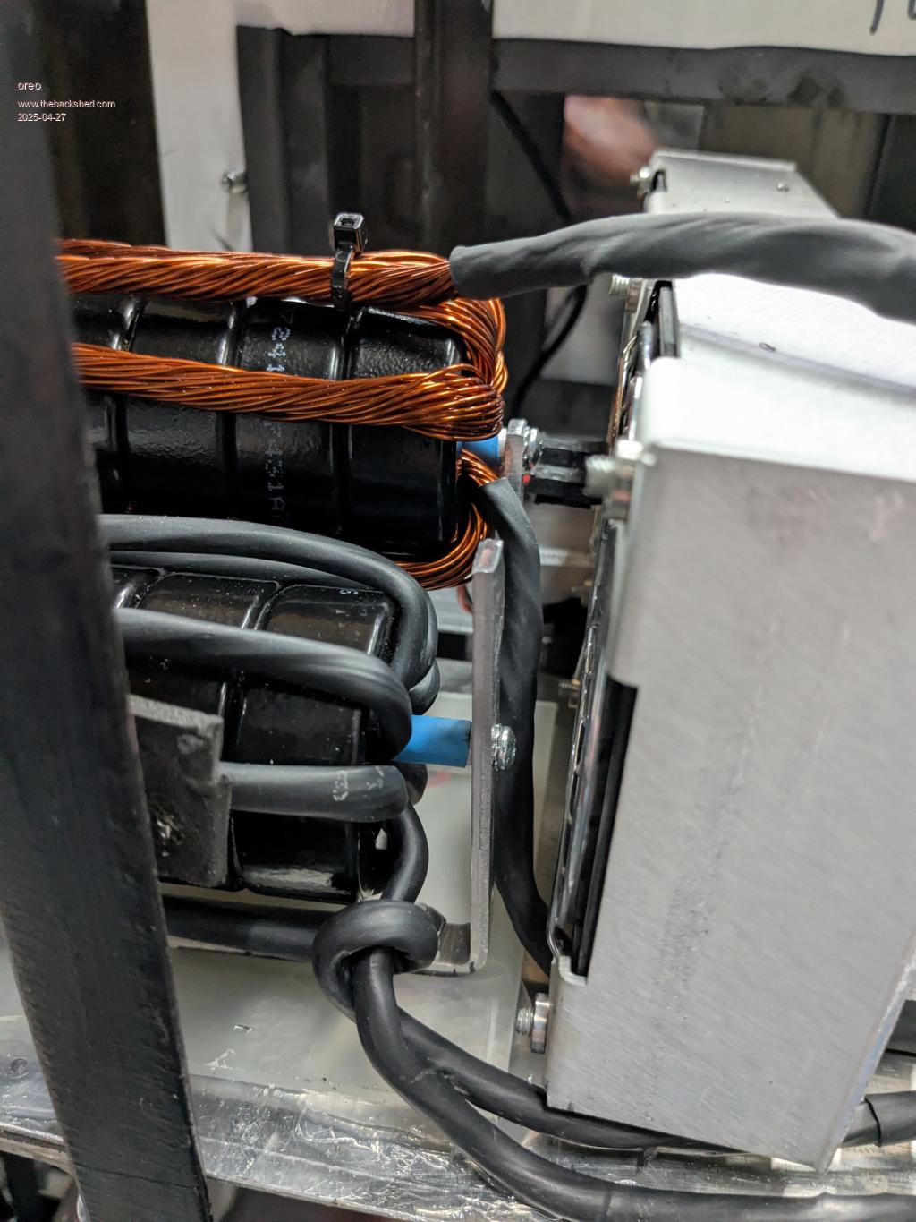

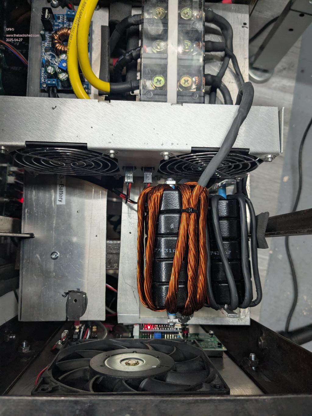

2 points, how did you mount the mosfets? I'm trying to have a good clearence between bolts and pcb itself, I'm using some standard nylon isolation bushes, they just fit between the pcb and the bolt. The M3 bolts are connected with the heatsink and a short between the positive and negative rail on the pcb is not that difficult to make I noticed.
Second point of interest is the way you fixed your inductors, make sure you don't make a short winding, it looks like a short to me at the moment, so you are bypassing your inductance, I could be wrong if the mounting rod/bolt is not going all the way through your inductor or is interrupted elsewhere.
For the rest I really like your build, looks verry neat and professional.

Point 1 -I am using these  shoulder washers.  They fit entirely though the pcb and fully isolate the screw from the pcb (I had to drill out the pcb slightly to get them to fit though)  Does that answer your question?
Point 2 -If you look closely at the pictures, the core mounting brackets are on plastic (nylon).  This isolates them.  Now actually I initially missed this and had them mounted to the aluminum chassis which resulted in them being shorted out.  My standby current was .45amps, which made me realize my mistake.
