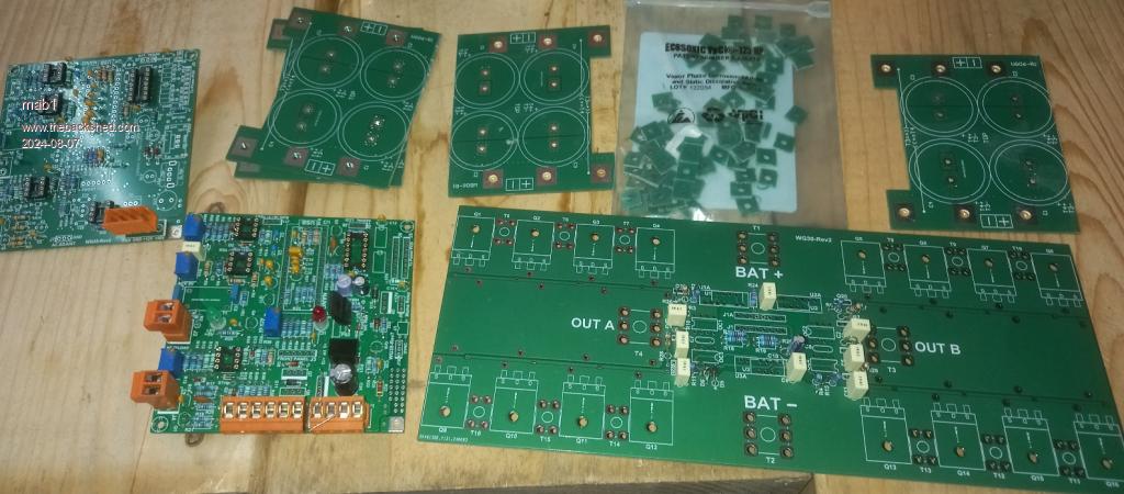

I've stalled on the transformer rewind as i still haven't sorted any wire straightening tools or epoxy for sticking the cores together - and real life (work) keeps getting on the way
But i haven't stopped entirely: the big order from lcsc came, along with a smaller one from digikey, so I've been populating the controller board (along with the variac controller to a lesser extent).
But i do seem to have an online shopping 'disability' in that I'm guaranteed to not notice I've missed something off the order until after I've gone through checkout   . I've got a 2nd order coming from lcsc and I've still got to source the fx1115 ferrite beads.
Also, ordering late at night, i fell for the sneaky aliexpress welding terminal trick and recieved a bag of M6 srews from china . But then found that lcsc does the big terminals,  albeit with M5 holes not M6.
Pete, Roger, i do have pvc electrical conduit, 20mm and 25mm in 3m lengths, so may try making a hoop from that, otherwise I'll be buying a hulahoop

Anyway, couple more stupid questions:-
Because i can't seem to think properly when ordering online, i ended up getting 74AC86 for U6, but then ordered U8 & U9 before realising i can just use 33R - i guess i just fit the resistors? There's no advantage in using U8 & U9 with the AC version of U6?
And the other question is wether i should get some ally bar rather than mounting the mosfets direct to the heatsink? I seem to remember reading it would be a lot easier to fit the ferrite beads and base resistors in with ally bars, but are there other reasons that I've missed (otherwise, when i get the beads i may see if i think it's doable and do without the ally bar)?

The aluminum bars make it easy to use wiseguys simple method of mounting the FETS instead of having to drill and tap 16 FET mounting holes.
I've tapped 32 mounting holes in two heatsinks, but I'm going to use something similar to Wiseguys method for this next one.
The FET beads are easier to mount with the correct FET to aluminum bar mounting position.
The resistors and "8" of the ferrite beads are easy either way.
The second 8 beads really need the aluminum bars.
I use SN74AC86n and also mounted U8 and U9, I like the added high current source capability, and since I'm now driving two power boards, I'm happy that I did.
FYI these beads are slightly smaller than others, but are used in some of the inverters that I have stripped down. Cost is amazing for the quantity, mine arrived quickly and are as advertised.
Ferrite Beads
EDIT: I used 3.5 X 3 X 1.5 but wiseguy originally used 5mm long beads, they have those as well in the listings.

Mab, a tip from somebody who has populated PCB's for half a century.
Always fit the lowest height parts (resistors, diodes etc.) first, turn the board over and solder the legs. This way they get pushed flat against the board.
Next do the IC sockets.
And so on...
I would solder tall parts like trimpots & connectors last for that reason.
Also noticed you are using the more expensive IC sockets with the turned pins. Be very very careful when you insert the IC, it's rather too easy to fold one leg under  (unobserved) as you press the IC on. Then you might spend lots of time working out why it's a no go board. This applies especially for the driver chips, mine had particularly thin fragile legs.
Happy populating

Ok, then i guess I'll get some aluminium bar.
On the subject of ferrite beads: does it not reall matter then if i got some different ones?  - as long as they're about the right size and ferrite? I can get the fx1115 i think, I'm just being a cheapskate and trying to find them with a supplier where i am ordering something else - which hasn't happened yet.
This is probably the biggest pcb population I've done   : i tend to do passives then heat sensitive, but then it's been a bit dependent on what I have here already, then the rest when it arrives.
Actually i haven't soldered anything on the power board yet - i was just checking i had all the small bits before i submitted the order - but for the power board i was going to do the big terminals first as they'll get the board hot (though i could do the resistors 1st i suppose), then the little (SOT) transistors before the caps as the caps will be in the way if i do them 1st.

FYI, because of the size of the caps I used (quality parts from my parts bin) I mounted the IC sockets on the Power board PCB first, followed by Caps, small FETS, diodes and resistors in that order.
When you get the IC sockets, dry fit them with the caps, this will give you a good idea of the very tight fitment with larger quality types similar to mine, very tight squeeze, but still simple to do.
Yes, mount the big terminals first, and depending on what you use and heat applied, this will make it easier for any PCB cleanup of flux that may be required, especially on the component side of the PCB before the other small components have been mounted.

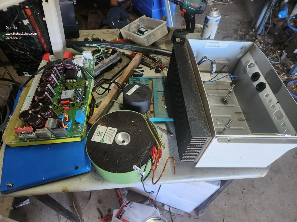

Posts: 5199
Posted: 02:13am 03 Sep 2024
I picked up a free Sunny Boy grid tie inverter a few weeks ago. I had converted one of these into a inverter a few years ago using the old Powerjack(?) boards.
When I tore this one down, I see unfortunately it looks like they started potting their transforms at some point.
Anyone had any luck de-potting these? Or should I just hack into it to get the iron core and put the copper in the scrap steel bin?
