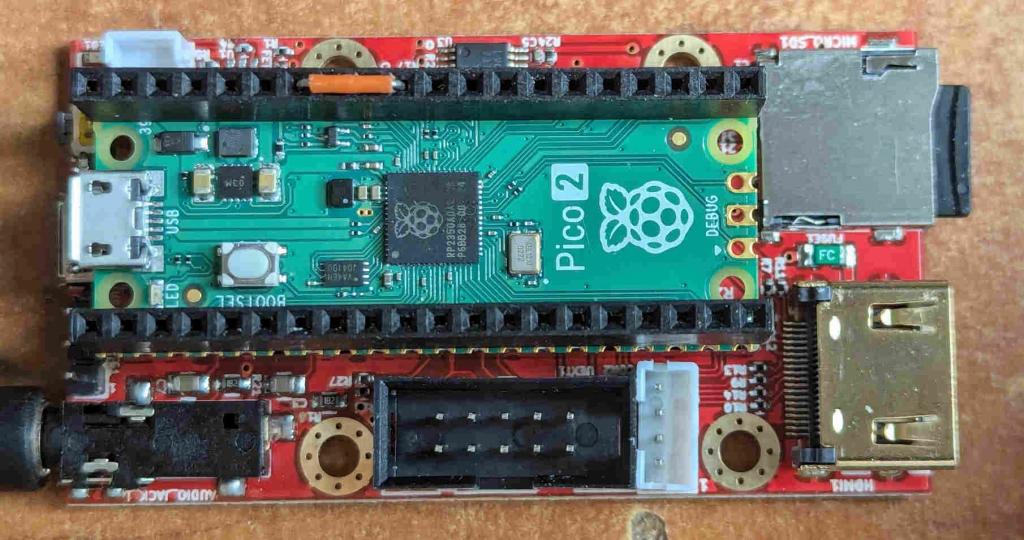

  matherp said  MMBasic V6.00.00b5 (just about to post) will now run on the Olimex
Just use
OPTION RESET OLIMEX
to setup the DVI port, the sdcard and the audio
They have selected stupid pins for the audio (not the same PWM channel) so bridge GP28 to GP26 to get stereo in MMBasic
I ordered olimex, £16.90 . mmy pico2 I solered pin headers, not like the photo
Just use
OPTION RESET OLIMEX
should I have used long lead female headers like https://www.ebay.co.uk/itm/121744167815
like in your photo?
pimoroni where I got pico2 is now pre-order as pihut. farnell still got some,ordered 2
https://cpc.farnell.com/raspberry-pi/sc1631/raspberry-pi-pico-2/dp/SC21034
the headers https://thepihut.com/products/stacking-header-set-for-raspberry-pi-pico

Posts: 9119
Posted: 08:16pm 08 Sep 2024
It makes things easier if you want to connect other things, but it's not essential otherwise. It will still produce HDMI. The 10-pin socket gives you a few IO options. You will need to solder the link shown on Peter's photo to get stereo audio though. That can be on the bottom of the board if you like.
Available on the connector are:
PIN
1       3V3
2       GND
3  GP20 COM2 TX
4  GP21 COM2 RX
5  GP9  I2C SCL (with pull up)
6  GP8  I2C SDA (with pull up)
7  GP4  SPI MISO
8  GP7  SPI MOSI
9  GP6  SPI CLOCK
10 GP5  SPI CS

Posts: 9119
Posted: 09:50pm 08 Sep 2024
Using the stackable socket headers gives you more access to the GPIO pins, but the board will work equally well if your Pico has male pins on it. As I said though, you will need to add that link somewhere if you want stereo audio.
The video commands seem to be the same if you are using the same video modes. Obviously screen resolution can be different. Make sure you read Peter's notes.
There is a filter in the audio circuit, you don't need an external one. It looks like they've boosted the output a bit too, giving it a bit more current drive.

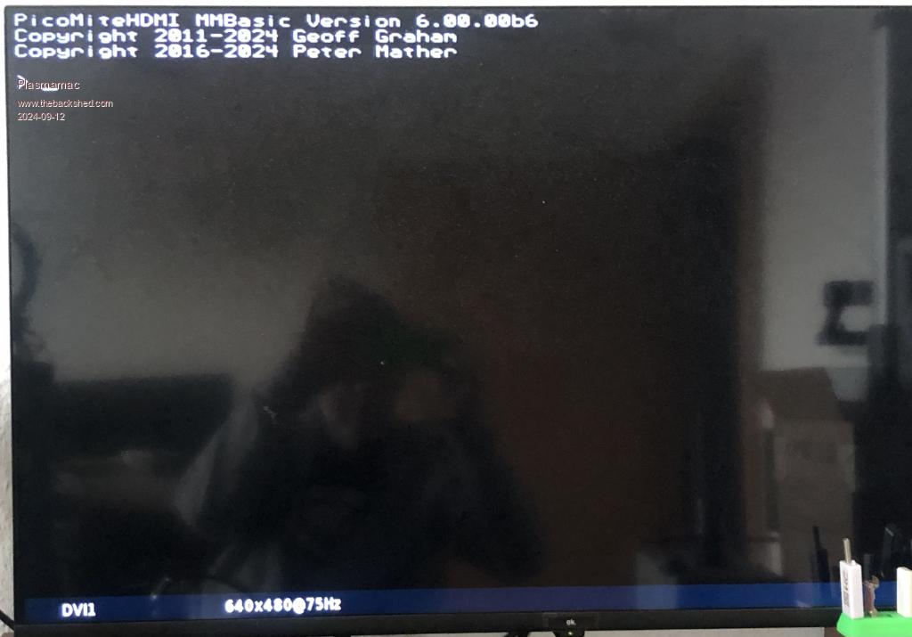

Plasmamac
Joined: 31/01/2019
Posts: 620
Posted: 01:12am 12 Sep 2024
Unfortunately the price per module for Twofinger raised 900%
Gnihihi
(Joke)
