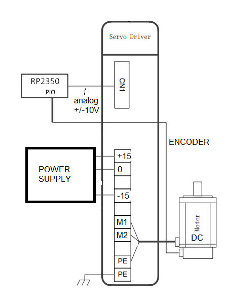

@Volhout
Not the CMM2...Only the PIO can handle the encoders.
The drive on the machine feeds the encoder signal to the drive and the drive has an "emulated encoder output".
The PicoMite (in my case) will handle all aspects of motion control, so the emulated encoder outputs will feed the PIO.
Thanks for all the help, guys but I've been in touch with two suppliers and I'm just gonna go-ahead and get their miniature drives/motors. They have the same features as the bigger units and some of those might be useful in other applications.

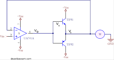

Revisited because I came across this:
From this site
Only problem I see from my attempt at using the circuit simulator applet is that the 741 opamp can only provide ~25mA which means that I won't be able to drive the transistors sufficiently.
What's the best way to boost this, an alternative opamp or a transistor?
Posts: 5994
Posted: 04:27pm 20 Mar 2025
Hi Phenix,
These are opamps (accurate, low offset, high open loop gain, etc..)
OPA541 (Texas Instruments), sells for 20 euro's. +/-40V max 10A output opamp.
OPA549 (Texas Instruments), around same price, +/-30V max 8A
These are audio amplifiers (maybe not that low offset, but much cheaper)
TDA7294 (ST Microelectronics), +/-40V 10A max. Around 4 euro.
LM4766 (TI), +/-30V 4A max
LM3876 (TI), +/-42V, 6A max, around 6 euro
LM3886 (TI), +/-42V, 11A max, around 4 euro
You can treat these as normal opamps in your motor drive application. One thing some audio amplifiers do not have is a large common mode voltage range. That means that you will have to give the amplifier some gain (i.e. 10x) In that case you drive the amplifier with +/-1V to output +/- 10V to the motor.
Edited 2025-03-21 02:36 by Volhout
Posts: 8965
Posted: 04:45pm 20 Mar 2025
And so the original post comes round again.  Same circuit but with component values. :)
I really hate the idea of using linear control for motors.
The above circuit has two major problems:
The output transistors will get seriously *hot* with any load.
The torque will be poor.
The latter is because torque is proportional to the applied voltage and this sort of control changes the voltage across the motor so the torque is bad at low speeds and improves as you speed up.
To make things worse, it's inefficient as far as motor voltage goes because it's a half bridge. A full bridge puts the motor across both supply rails. This gives it maximum voltage but also balances the load on the supplies.
PWM uses a constant voltage so the torque at low speed is far better. I understand that you don't want to use it because of reaction time issues, but perhaps you are pushing this too far? PWM with a lighter motor that's geared down would be far more effective than a heavy armature.
If you insist on doing it this way then you could change the output transistors for darlington types, which have a far smaller base current. There is also a configuration called compound darlington which uses PNP/NPN as shown but followed by a NPN pair, which would be better for power handling as large PNP devices are harder to get and more expensive. You may need some serious heatsinks.  :)
PhenixRising
Joined: 07/11/2023
Posts: 2008
Posted: 05:04pm 20 Mar 2025
  Mixtel90 said  And so the original post comes round again.  Same circuit but with component values. :)
Oh heck, I hadn't realised that
It's not for a real application, it's for a test rig.
Can't use the PicoMite's PWM because:
My PID loop + velocity profiler runs in a 1ms interrupt BUT our PWM takes > 1ms to update and so I am using an SPI DAC to produce the +/- 10v motor command signal.
