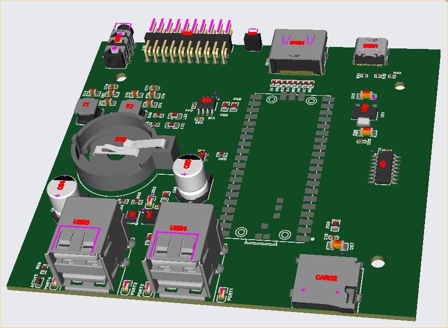

Here is my take on a General purpose motherboard for the PICO2 to meet the "standard". Cost from JLC fully built USD79 for 5. The PICO2 is flush mounted to the board. There will be through holes for TP2 and TP3 to allow them to be soldered from below (these provide the USB HOST connection to the onboard hub)
The board fits the same box as the CMM1.5 design and if I proceed further I'll provide design files for the box ends.
Features:
RTC on GP20,GP21 with CR2032 battery
Audio filter on GP10,GP11
HDMI on GP12-GP19
USB-C for console and power - GP8, GP9
USB 4-port hub TP2,TP3
SDCard GP22, GP26,GP27,GP28
Header with 8-free pins (GP0-GP7) + System I2C + 4xGND + 4x3V3 + 2x5V
Schematic
7d983229-0208-4059-828f-ddcfc4aacec0.pdf

Looks really nice Peter! I'm ready to order a batch as soon as you finalize the design.

Very pretty.
Is that a hard reset button next to the user port?
Are you using the same pins for the audio as Mick; that needs to be part of the standard ... EDIT: it appears they are ;-)

Unless you know something I don't, Peter, the Pico won't load MMBasic while the USB hub is connected to it. It certainly won't for me anyway. Things may be different when you have direct connections available though. I can't test everything. My hub board doesn't bring the reset line out either.

  matherp said  RTC on GP20,GP21 with CR2032 battery
HDMI on GP12-GP19
hi Peter,
   i see none of the RP2350's ADC inputs are exposed to the outside world - perhaps not such a bad thing given the problems that the ADC has faced in the past! might i suggest that you have an internal 5-pin header bringing out I2C, GND, 3v3 and 5v, that the user can then plug an internal expansion daughter board directly into? such a board could sit above the main board on the existing PCB mounts and, for instance, hold an ADC converter and multiplexer, and expose these analog input pins through a connector sitting above the 20-pin header.
rob  :-)
Edited 2024-09-14 15:07 by robert.rozee
Posts: 11653
Posted: 07:39am 14 Sep 2024
  Quote  Unless you know something I don't, Peter, the Pico won't load MMBasic while the USB hub is connected to it.
Thanks for the heads-up. I'll include a header to connect/disconnect from the hub.
I could easily expose GP26, GP27, GP28 at the expense of 3 of GP0-GP7. The ADC on the RP2350 is supposed to be free of the issue on the RP2040. The choice is between a 8-bit parallel set of contiguous pins and no ADC or 3x ADC and GP0,GP1,GP5,GP6,GP7
I don't mind which - thoughts everyone?

Posts: 3323
Posted: 08:15am 14 Sep 2024
Would routing restrictions allow an internal header for the ADC pins plus ADC Gnd. (and any other unused pins)?
Those who need it could add a ribbon cable to the outside or a panel mounted connector.

Posts: 2991
Posted: 08:20am 14 Sep 2024
If it is a ‘physical space limitation’ on the 20-pin header on rear panel, could you not sacrifice a GND pin, 3v3 pin, and a 5V pin (or possibly squeeze in a 22-pin header)?

Posts: 2542
Posted: 08:29am 14 Sep 2024
  phil99 said  Would routing restrictions allow an internal header for the ADC pins plus ADC Gnd. (and any other unused pins)?
problem is that GP26, GP27 and GP28 are currently (in Peter's design) being used for the SD card. basically, once everything is allocated for, there are just not that many pins left free on an pico/RP2350A (60-pin).
personally, i rather like Peter's allocation choices, and think that for those who want to make use of analog inputs a separate ADC chip hanging off the I2C is a good solution. this can be nicely catered for with an internal expansion card that is accessed via I2C.
rob   :-)

Posts: 8966
Posted: 09:38am 14 Sep 2024
It's because of the restricted number of GPIO pins that my recent designs have that (apparently unpopular!) RJ12 socket on the front. You can always use a spare Pico or Pico 2 or even a PGA2350 as a remote I2C expander with ADC inputs. Actually I kinda like that last idea....   :)
Personally I've not used the ADC inputs much in the past. Not on a general purpose board anyway. They are handy for embedded applications. It wouldn't bother me if they weren't available.
