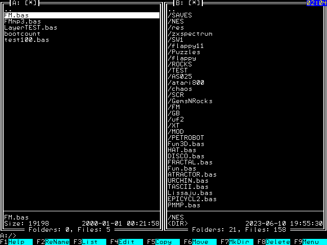

Hello Dietmar
Unfortunately, this FileManager was not initially made flexible for different resolutions, but was adjusted to the MODE 1 resolution 640x480 and font 8x12.
I already see that it needs to be redesigned at least to work through the terminal.

My respects Peter!
Thanks to the new command
EDIT FILE fname$
released in the new PicoMite V6.00.00RC4, my File Manager can now open and create small files for editing.
javavi_FM_v14.zip
Edited 2024-10-05 18:22 by javavi

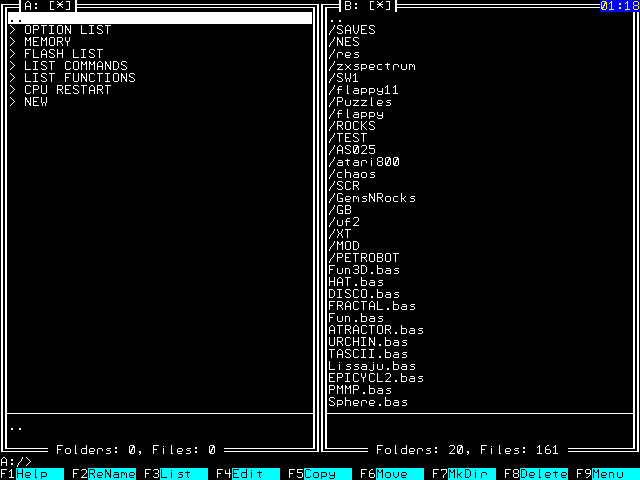

jFM v.1.7 for PicoMiteVGA/HDMI
jFM_v1.7.zip
- added MENU by F9 from which you can execute the necessary commands or run programs
> command
* program
- scrolling the list of files forward and backward with arrows or PgUp PgDn
To launch FM by pressing the F9 button (you can F5...F9)
you need to save the program in the memory slot and set it to launch by pressing the Fn button
LOAD "FM"
FLASH SAVE 2
OPTION F9 "FLASH RUN 2"+Chr$(13)

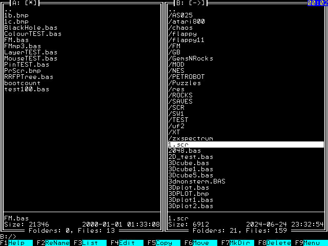

Posted: 02:54am 13 Oct 2024
jFM v.1.8 for PicoMiteVGA/HDMI
jFM_v1.8.zip
- RAM consumption optimization
- plays mp3 files on Pico2
- displays information about the current file at the bottom of the panel (size&date)
- saves the Screenshot image by pressing the PrintScreen button
Edited 2024-10-13 21:32 by javavi

mclout999
Joined: 05/07/2020
Posts: 527
Posted: 04:26pm 12 Nov 2024
First off, I love your program.  It gives me what I miss from my CMM2s.
There is an issue with this version.  If you Hit F9 and then select commands list it lists them but then REBOOTS!!!  every time.
I am on RC15 on a PICOHDMIUSB board.
Posts: 6195
Posted: 02:22pm 13 Nov 2024
Hi mclout999,
I cannot reproduce on my RP2040 VGA platform. Must be platform dependent.
Compliments to javavi. You have really created a nice tool, that I love to use. It is on flash slot 2 of every VGA platform I have (too bad only 3...).
If you would be able to make this work in the terminal, you would get absolutely every Pico I have. But that is not an easy task. And (especially on the USB platforms that use 115200 baud serial) it may be slow.
Anyway... 1.9 works fine for me.
P.S. The RP2040 cannot play MP3's. This results in an error. Maybe you can do something with "IF INSTR(MM.Device$,"2350") Then Play mp3 TEMP$
