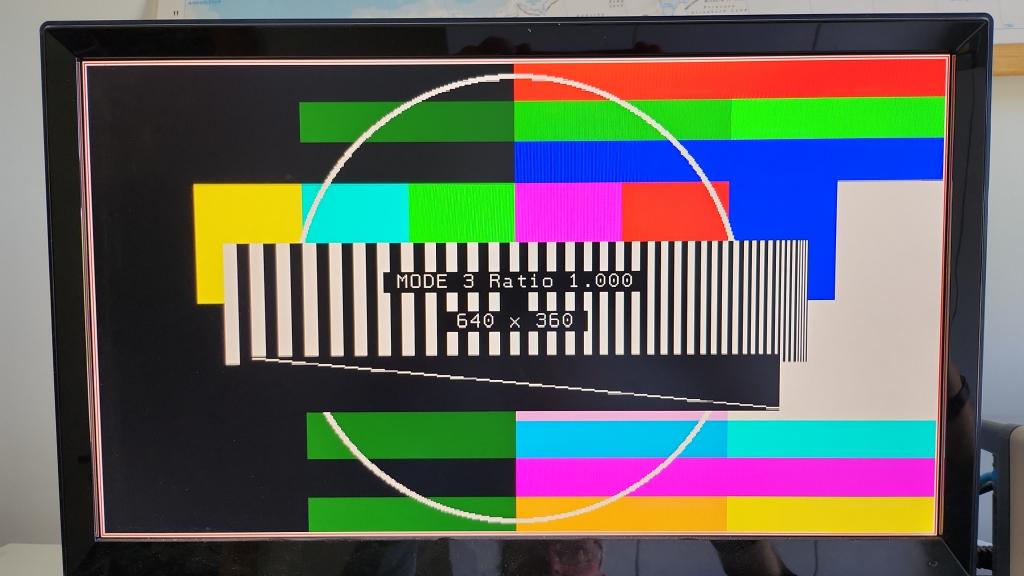

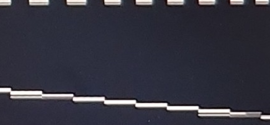

PicoMiteHDMI MMBasic Version 6.00.00RC2
With the tweo wide resolutions 1024 and 1280,
MODE 2 and 5 are very stable.
MODE 1 and 3 have what looks like interlacing gone astray.
In mode 3 there are 4 good lines then 2 lines which appear to be  alternating between correct and out of order.
Tested on 2 monitors, both native resolution 1920 x 1080
All modes are good in 640 resolution.
RC1 was good in all resolutions.

The LittleFS filesystem is case sensitive. FatFS is not. Nothing I can do about this without changing the internals of LittleFS.
There are bugs in RC2 in 1024x768 and 1280x720 modes which I'm working on (Thanks Jim)

V6.00.00RC3 for HDMI and HDMIUSB
PicoMiteHDMIRP2350V6.00.00RC3.zip
Should fix various issues in RC2
1024x600 is not a standard resolution that monitors and/or TVs can handle. I just implemented 1024x768 as a higher resolution for those using standard 4:3 monitors
