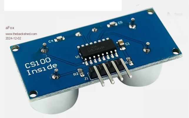

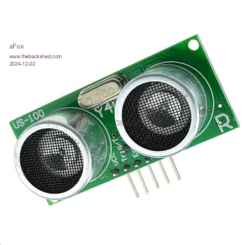

Posted: 11:02pm 01 Dec 2024
Page32
Measuring Distance
for this sensor because it uses 5V levels for its echo output.  The Raspberry Pi Pico 2 can tolerate 5V (while powered) so, in this case, level shifting is not required.
The last sentence does not apply to the trigger input signal. With a 3.3V voltage trigger signal, an echo signal is sometimes lost. Maybe it depends on the components used.
In my opinion, you should recommend the US-100 ultrasonic distance sensor.
In this case, no level converter is required.
If you can get a HC-SR04 ultrasonic sensor with CS100 chip inside or an US-025 you need also no level shifter. The quality is better too.
