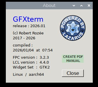

excellent     from the right-click menu in GFXterm, if you select 'about' you should see a small window pop up containing some build information, are you by any chance able to post the result?
rob   :-)
Posts: 6626
Posted: 10:57pm 03 Jan 2026
Done.
