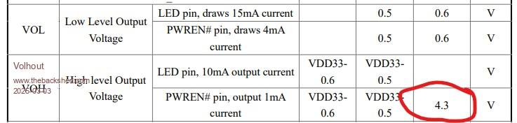

There is a limitted "black out" time between PWREN# and OVCUR#.
Q1 should be able to charge C80 in that blackout time. If not...OVCUR# will cut PWREN and disable the 5V wi the USB ports.
My guess is that Q1 is not turning on hard with the voltage provided through LED3. This may be mediocre FET's or the wrong type of FET. Even if you can make it work by bypassing R54/R55 you will see that the USB ports cannot deliver enough power for devices (Keyboard/Mice/Game pads) since Q1 is not driven hard.
A way to resolve is : replace LED3 with a Si- diode (max is 4.3V). The original LED3 is used as a "level shifter" from a 3.3V output to drive a P-FET at 5V.
If you inist in having a LED3 function, then place it with it's own series resistor of 4.7K, parallel to R56.
Or, replace Q1 with a better part, that turns on hard at the the provided gate voltage.
A real MDD2301 should allow 2A drain current at Vgs=2.5V (the 0.7V is for 250uA, which is not enough to charge C80 fast). But if you have 2.5V between gate and source on the MDD2301 that should be fine.
Or, maybe change C79 to 100uF (official must be 120uF according USB standard, but 100uF will work also). A smaller value may charge enough in the 334's dead time.

PWREN# is active low, the high level output is immaterial. The 4V3 only leaves 0V7 to turn on LED3 and the mosfet. Not going to happen. VOL is 0.6V max at 4mA. With 0.6V there and 1V8 for LED3 you have 2V6 to turn the mosfet on with. That's going to saturate it fast as you have potentially 4mA to charge the gate capacitance, which is smell. Vds should be less than 200mV at 2A under these conditions.
I find it very difficult to believe that this is a mosfet issue. I think it's chip timing.

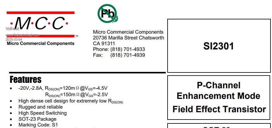

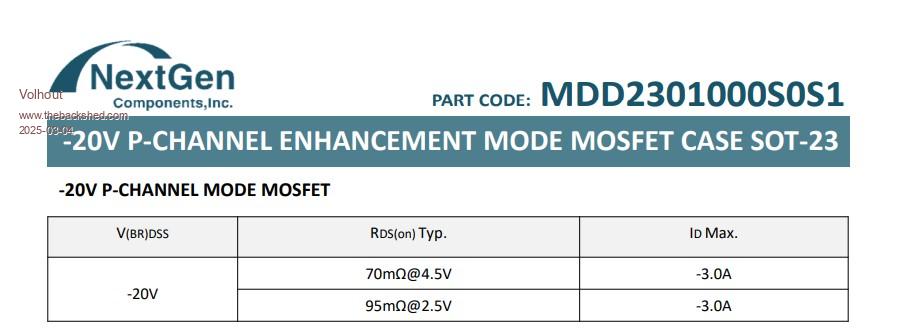

But the "S1" marking fits to a variety of devices.
The envisioned MDD2301 P-FET, or the Si2301 P-FET.
And these have different Rds_on.
MDD2301
But also:

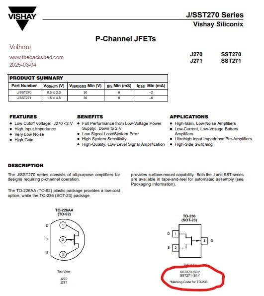

But WORST CASE it is stuffed with a VISHAY J-FET that has also marking S1.
And that will never work !!!

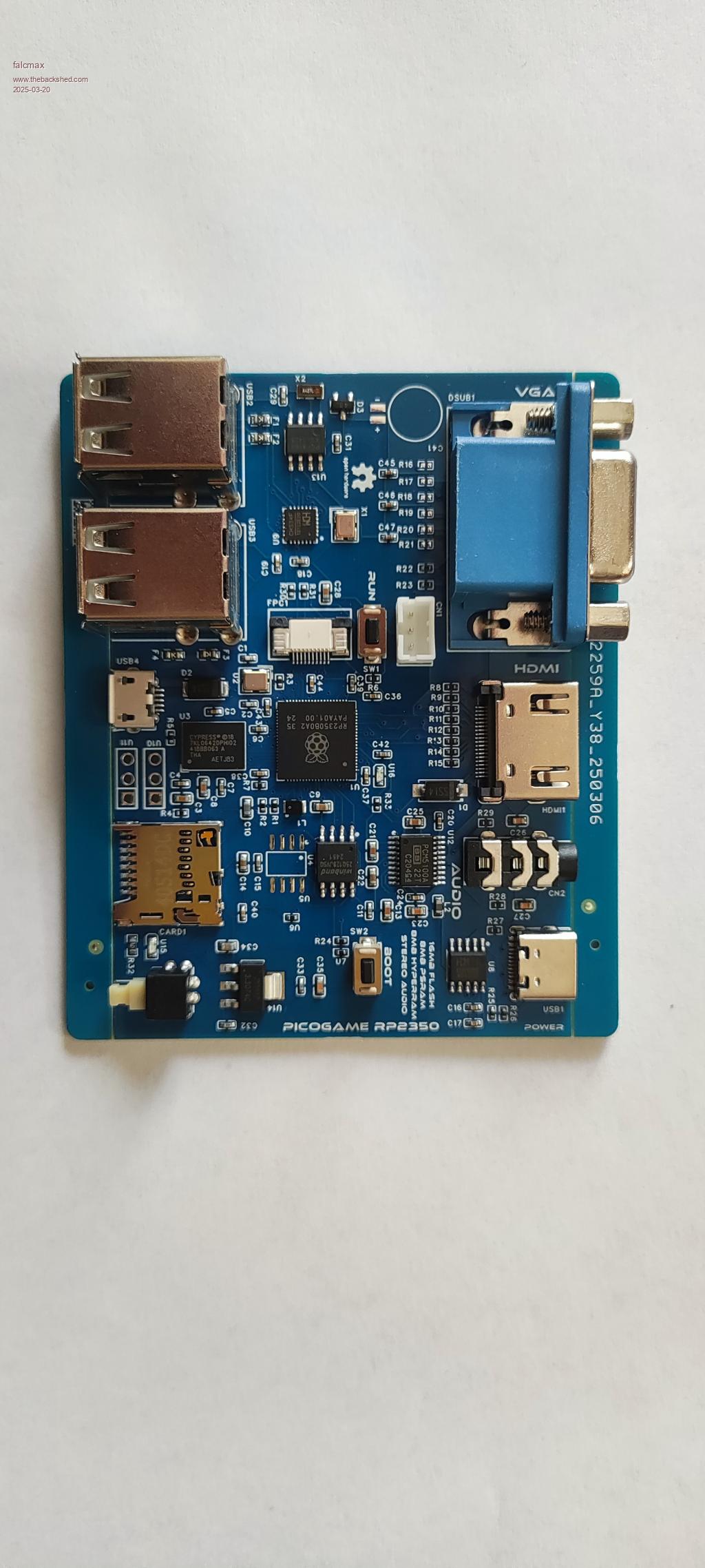

A new batch of Picos has arrived, so I assembled one more board to ensure that it is not a one (or two) off. Again, it shows exactly the same behavior.
I studied the CH334F datasheet a little bit more, but could not find anything obvious that would explain all of this. The only thing that makes me a little bit suspicious is that it can be ordered with custom configurations, which could explain why it some chips could be different from others. However, none of the described options struck me as an obvious cause.

I would, however, be more than happy to donate one of the boards for analysis since I very much like this project and I have received excellent support here.
So @Volhout if your offer still stands, and you believe you can maybe gain useful knowledge from it, I would send you one of the assembled and unmodified boards.

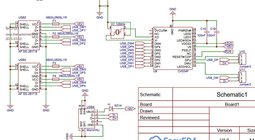

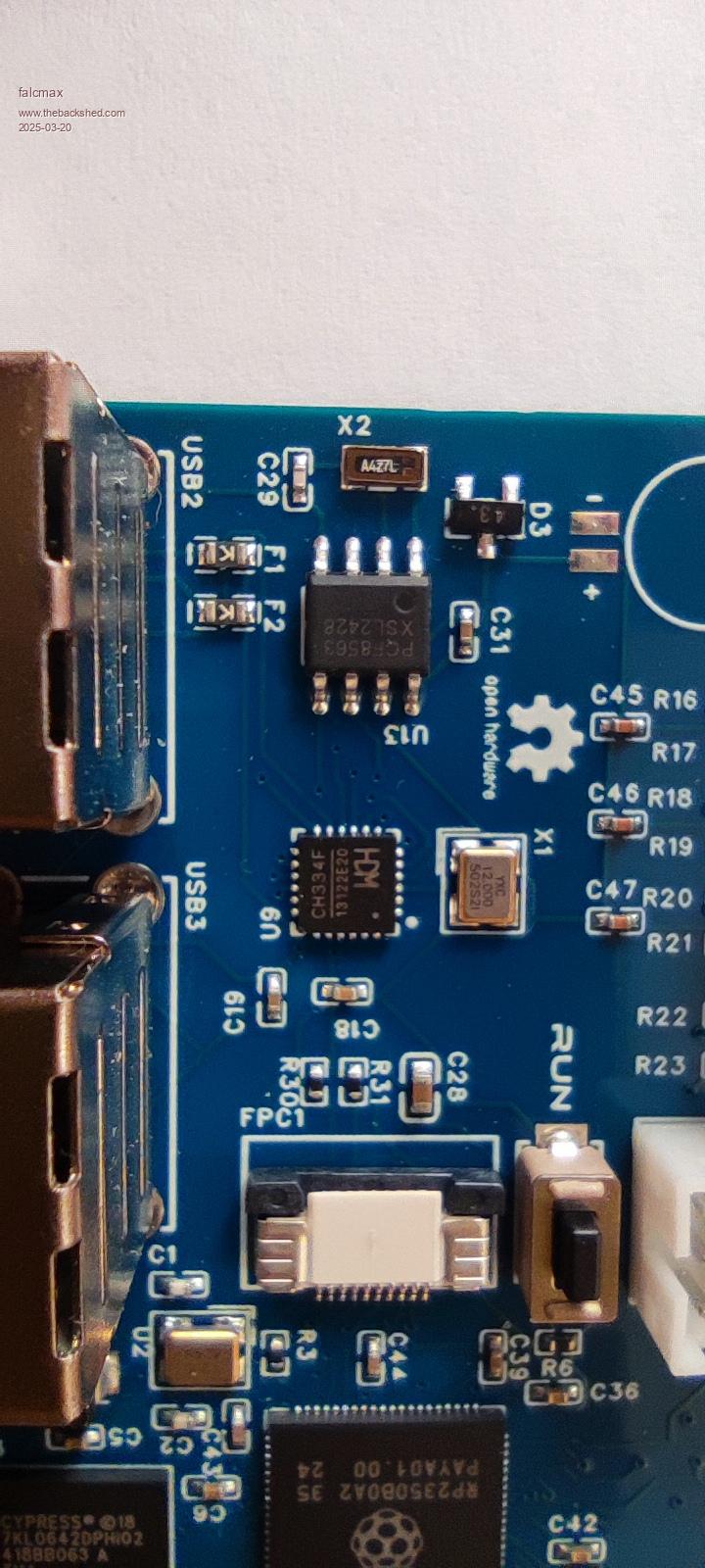

On my board I use the same CH334F chip but without the LEDs and without the PWREN circuit. I placed PTCs on the USB 5V line, and everything works fine. I’m attaching a photo of the chip mounted by JLCPCB.

Please can you confirm the batch number of the CH334F - probably 13122E20 which are the bad ones. 1163FD43 are the good ones

Why didn't you use the CH334P since you aren't using the LEDs or overcurrent?

When I was designing it on JLCPCB, it wasn’t available, but now I’ve seen that they have some in stock. In any case, I have to redesign the board due the wrong assignement of the I2S signals, so may be I will use the CH334P.
